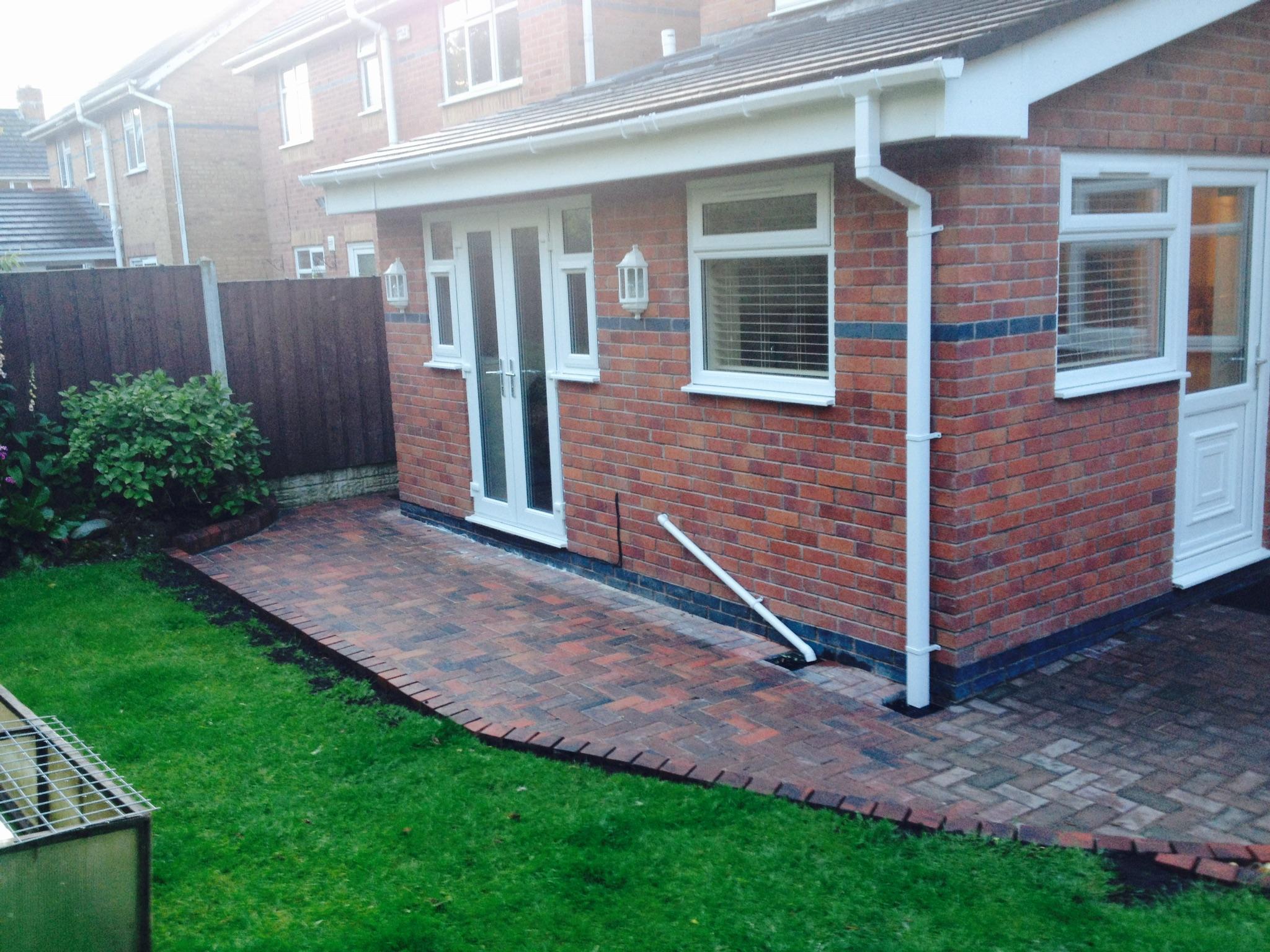

nod Posted March 3 Share Posted March 3 I would think he’s referring to a cavity tray Which would mean taking a row of bricks out just above the roof and putting a tray into the cavity Many years ago I built a 16 degree extension on the back of my mums house We also had limited room for the lead I slipped the lead under the new trays 1 Link to comment Share on other sites More sharing options...
