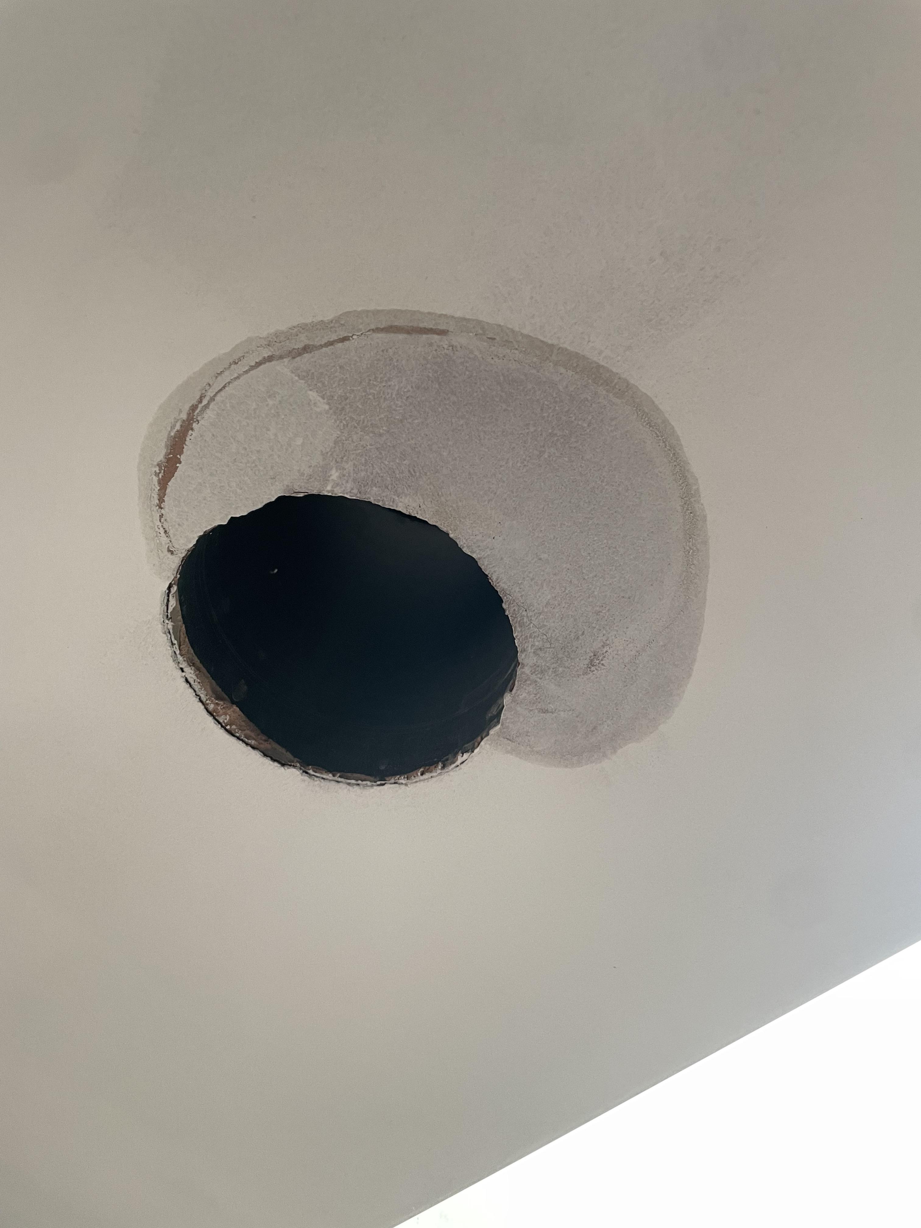

richo106 Posted March 3 Share Posted March 3 I have installed my MVHR and is going to be fully commissioned on Tuesday The couple of days I’ve found quite of bit of condensation coming out 2/3 of the outlets. I am guessing this is because majority of the pipes and vents are not properly insulated in the loft and the heating is on low. when the system is fully commissioned and turned on Tuesday will this stop all condensation built up even though the ducts are fully insulated yet? it’s making wet patches on the ceiling and conscious it will ruin the paint when I do it. many Thanks Link to comment Share on other sites More sharing options...
JohnMo Posted March 3 Share Posted March 3 My view is install fully, then run. Don't run part installed. Link to comment Share on other sites More sharing options...
richo106 Posted March 3 Author Share Posted March 3 5 minutes ago, JohnMo said: My view is install fully, then run. Don't run part installed. The MVHR is fully installed, it’s just the loft insulation that is only half done Do you mean wait until fully insulated too? We are not living there currently Link to comment Share on other sites More sharing options...
JohnMo Posted March 3 Share Posted March 3 57 minutes ago, richo106 said: it’s just the loft insulation that is only half done So to be pedantic, it's not fully installed. Not sure what temperature you currently have, but we had -3 the other night and a few nights hovering around zero, snow and sleet yesterday, -2 tonight. So the system will generate plenty of condensation, if only half insulated. Link to comment Share on other sites More sharing options...
richo106 Posted March 3 Author Share Posted March 3 Thanks @JohnMo Really appreciate the reply, I will fully insulate it tomorrow before I get the system commissioned. Link to comment Share on other sites More sharing options...
Tumble Posted April 6 Share Posted April 6 Did fully insulating fix your issue? Link to comment Share on other sites More sharing options...
richo106 Posted April 8 Author Share Posted April 8 On 06/04/2024 at 21:00, Tumble said: Did fully insulating fix your issue? Hi @Tumble Since insulating all the pipework and turning the system on I have had no condensation issues 1 Link to comment Share on other sites More sharing options...
