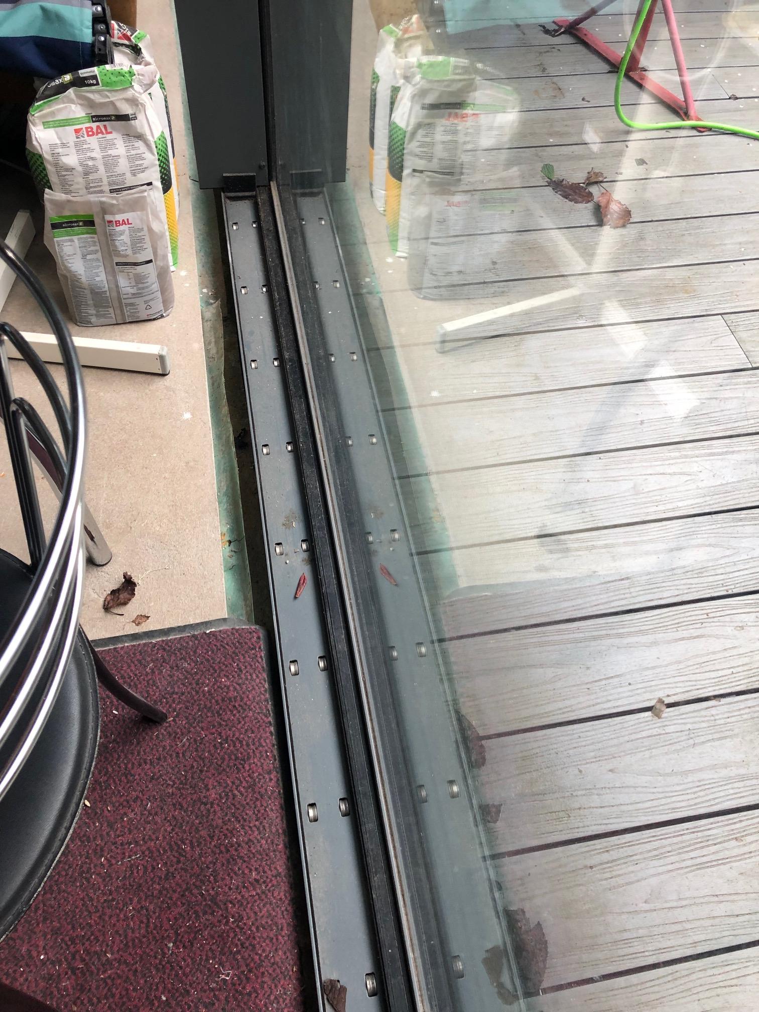

Pocster Posted February 29, 2024 Share Posted February 29, 2024 Sliding doors at the rear have become very difficult to open. I assume grit etc. is causing the issue. How should I clean this to get a smooth action again?; just tip water over track to flush out grit?; wd 40? Cheers Link to comment Share on other sites More sharing options...
nod Posted February 29, 2024 Share Posted February 29, 2024 Good clean then silicone spray Come up like new Link to comment Share on other sites More sharing options...
Pocster Posted February 29, 2024 Author Share Posted February 29, 2024 29 minutes ago, nod said: Good clean then silicone spray Come up like new So clean any grit etc off then just spray the entire track ? ( not just the wheel runners ) . Link to comment Share on other sites More sharing options...
