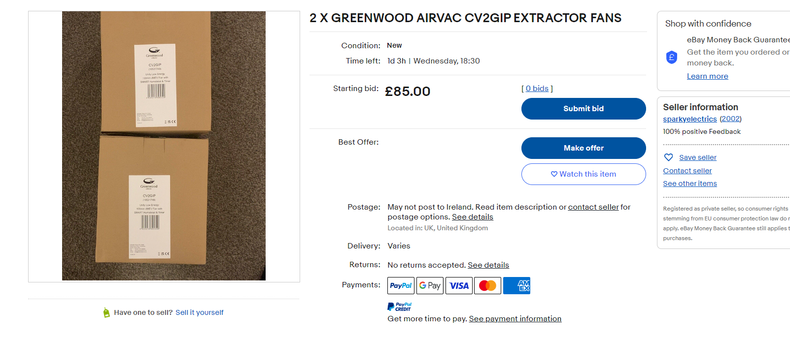

Trickle vents, just add humidity activated trickle vents to dry rooms (close wet room ones); they look after themselves. In wet rooms and kitchen just add dMEV fans (such as Greenwood with automatic boost for humidity) set to required min flow rate. Job done.
Agreed, I bought a Greenwood CIV2gp on ebay.
Keep an eye out and they can be had very reasonably.
