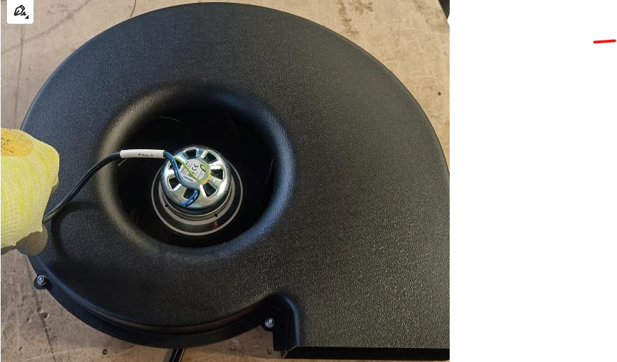

Domus supplied with a document on how to change the motor which is reasonably straight forward. I have extracted a photo of the fan unit just in case anybody can identify it.image.png.a7dec5cb384ddcd19b41bee9cb550a30.png
I'd you can get to the bearing then have a look at the number stamped on it. It's normally an off the shelf item. Most motor factors would have one in stock.

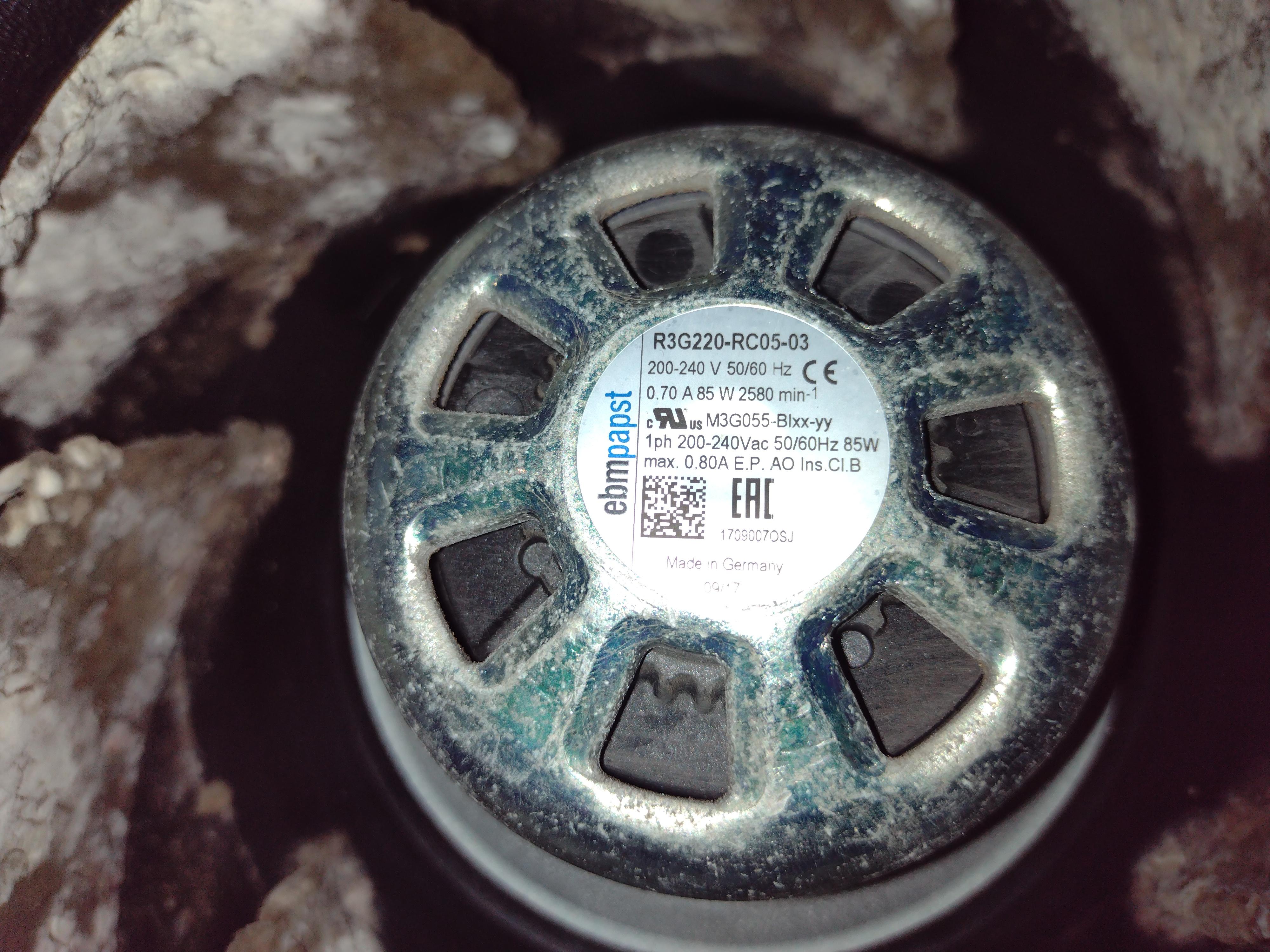

I'm planning on replacing the bearings in this unit now, however getting the time is another thing. Can you get the model number of the fan in the photograph and verify it is a papst?

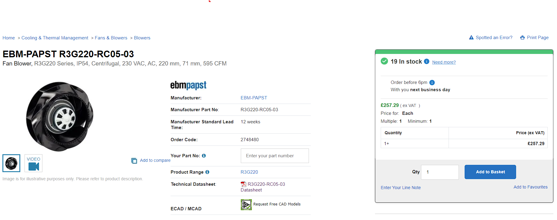

I'm very hopeful that it will be a bearing swap. No way should we be scrapping whole units just for the sake of some fans that should be serviceable. Does anyone know the markup on them? RS prices are in that region for similar fans, here's hoping they haven't deliberately made them unserviceable or really awkward to keep alive.

I have extracted failing fan, very very dirty rotor covered in dust n fungus so that will need a good clean, hopefully not disturbing any balance weights. Wonder if growth built up in balance? Fan motor number there, I'm timed out for tonight so will have to pick up next opportunity. There are YouTube vids for similar fans if you use search on bearing replace ebm papst fans, not sure which one will be closest to the hrx2 one yet.

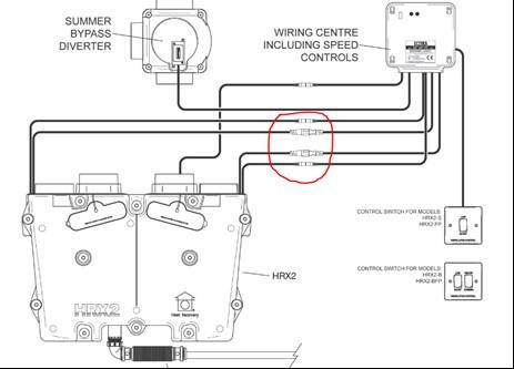

No connectors, wire ends straight to screw terminals in control panel.

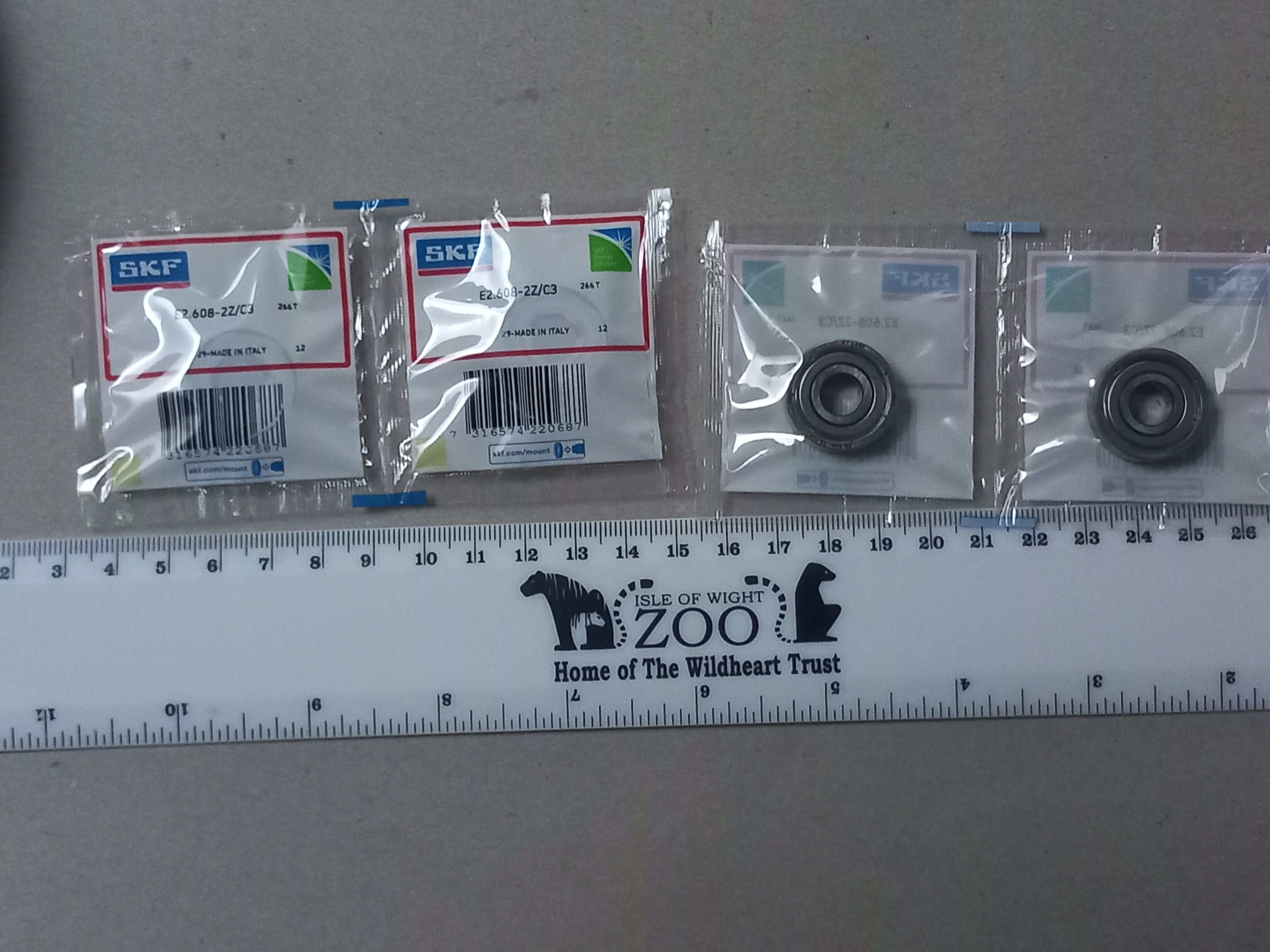

The C3 spec has extra clearance for high temp running so may not be the best if it rattles around as not running hot in this application. I've gone for the low friction rubber seal ones as the bearing that's gone is the more exposed one.
I've bought a removal tool, same size bearing on skateboards so tool sensible price, don't think in tight anyway so probably ok to get out carefully without special tool. I'll post more once got the tool and bearings.
SKF 6082RSL Deep Groove Ball Bearing with Two Low Friction Rubber Seals 8x22x7mm, £26.22 inc VAT and 1st class postage (paid for quicker delivery than free option £2.25) simplybearings.

Replacement bearings arrived.
