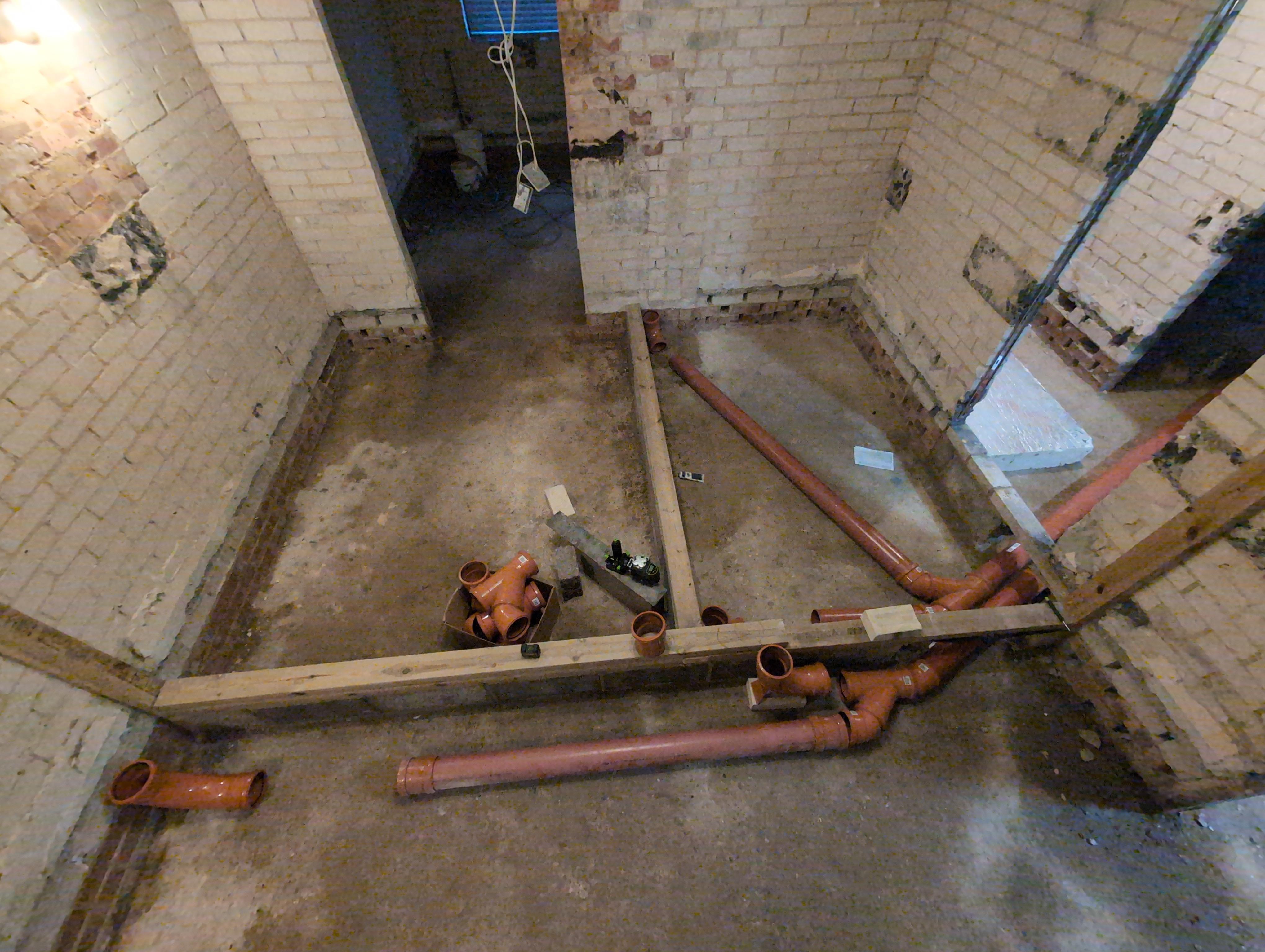

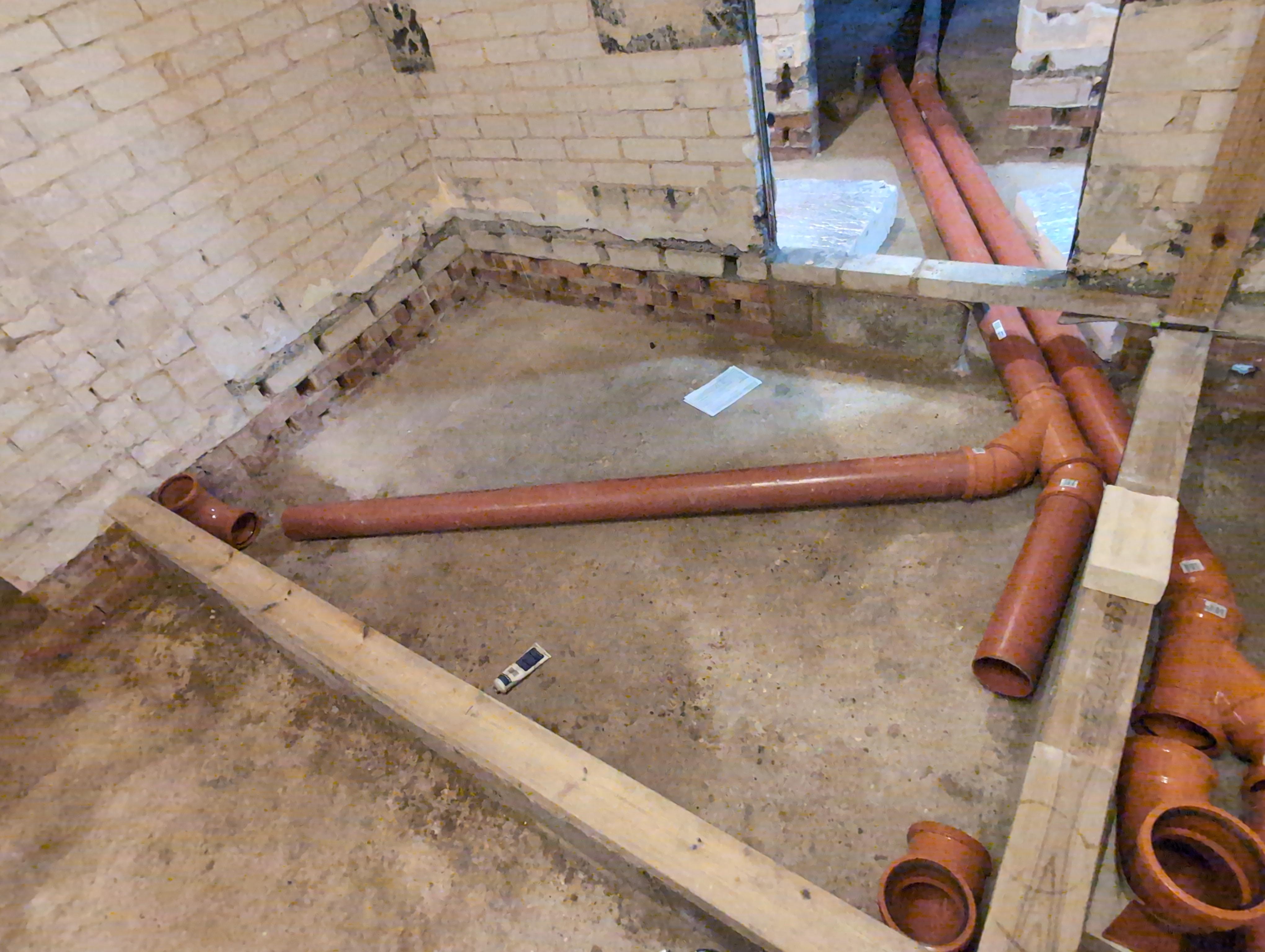

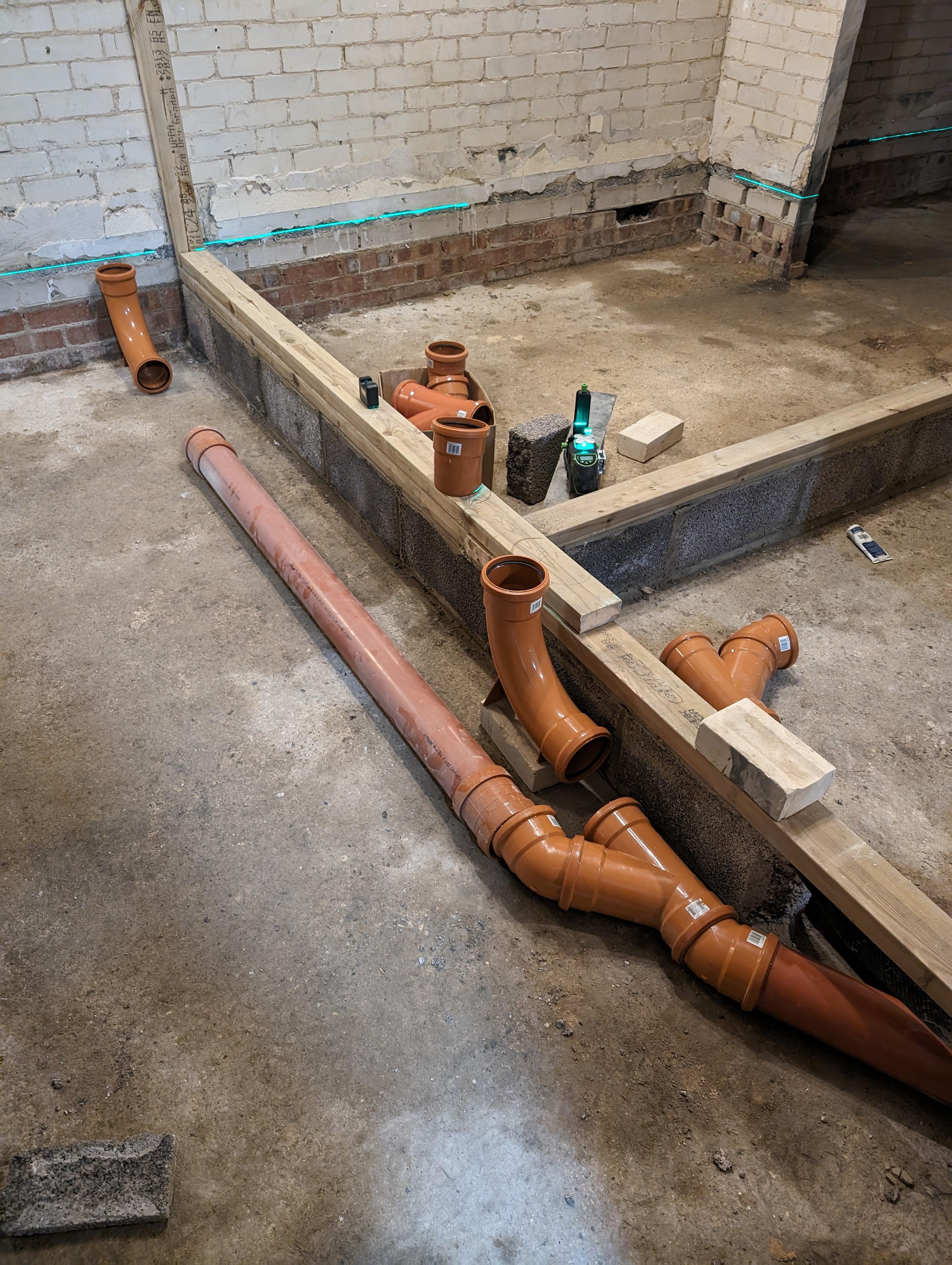

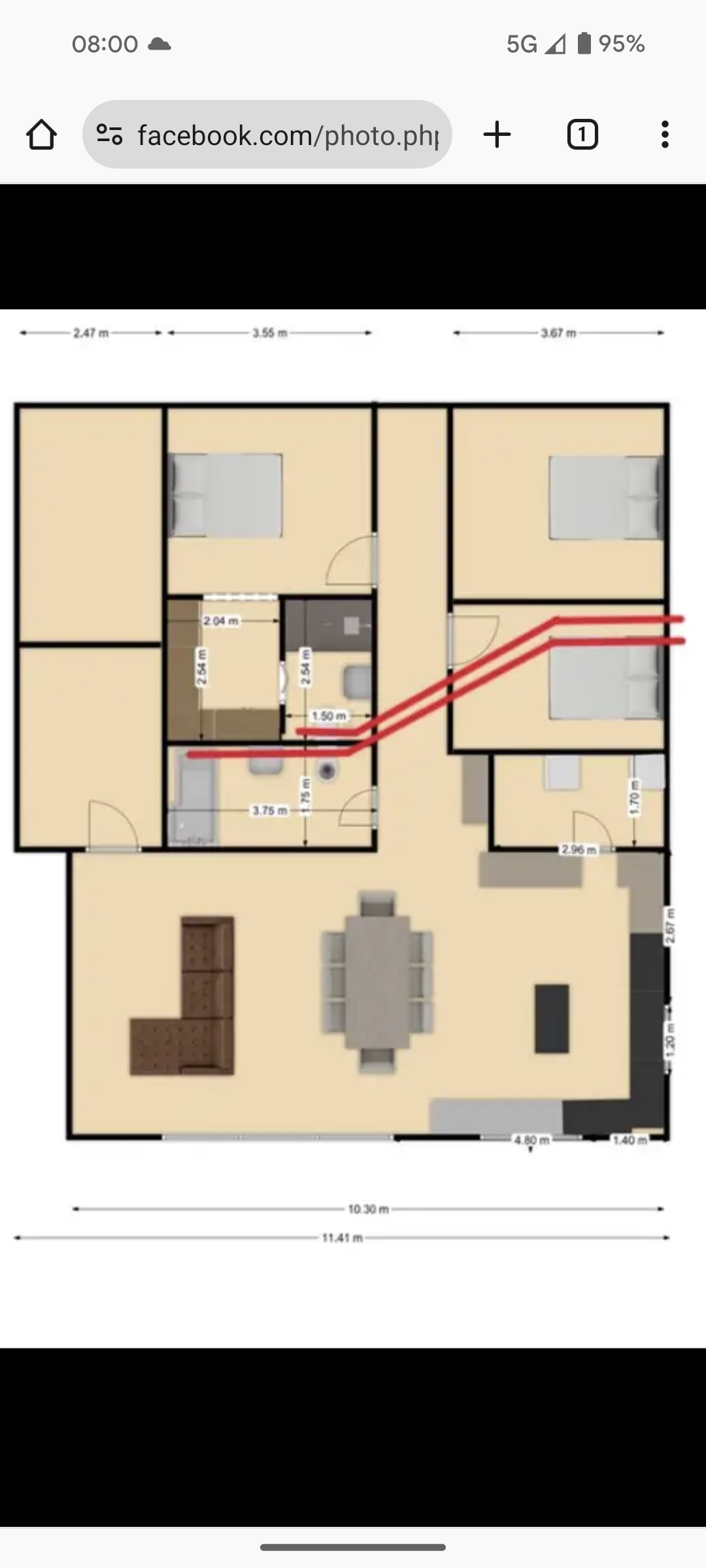

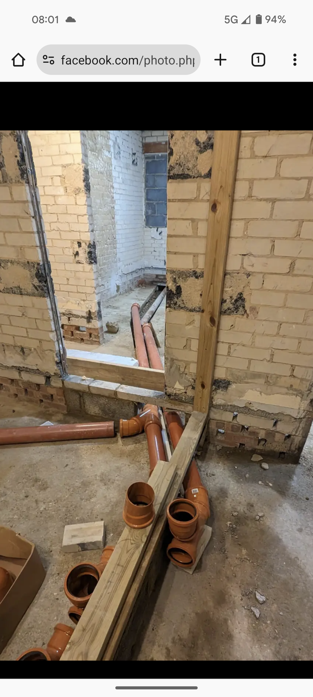

adamt Posted February 14, 2024 Share Posted February 14, 2024 Hi there I'm doing a full bungalow renovation with extension. Due to design constraints the two bathrooms are internal. Would anyone have suggestions on the best way to run the soil pipes from the attached pictures. I have plenty of fall. My concerns are at the top end where I was planning on using a y branch with 45 for the toilet to allow the run to carry on to the bath and vent stack at the far end of the room. But have been advised that might not be best practice. The other option its to do as pictured. There's also a 30 degree to get the runs out of the rooms and a 15degree before they exit the external wall. I believe these slight changes in angle are classed as roadable? Thanks Adam Link to comment Share on other sites More sharing options...

Mr Punter Posted February 14, 2024 Share Posted February 14, 2024 You can run the bath and basin in normal waste pipe. You could have a waste manifold near the WC to connect everything to. https://www.screwfix.com/p/floplast-push-fit-4-boss-single-socket-waste-manifold-black-110mm/40832 Plus a stub stack and AAV. This should mean just 1 pipe run out. Link to comment Share on other sites More sharing options...
adamt Posted February 14, 2024 Author Share Posted February 14, 2024 Thank you. Bath and basin I may be able to achieve the fall using one of the manifolds. The ensuite shower will be to low to achieve the fall using a manifold my idea was to branch in as shown. I currently have each room on there own pipe. Link to comment Share on other sites More sharing options...
Mr Punter Posted February 14, 2024 Share Posted February 14, 2024 I would run your proposals past the Building Inspector. You need to be able to rod all the pipe without disconnecting the WCs etc. Link to comment Share on other sites More sharing options...
saveasteading Posted February 14, 2024 Share Posted February 14, 2024 Plus, when you have positioned it, gently place and shove a golf ball at the top of the run (not dropped in) and see if it goes all the way. Link to comment Share on other sites More sharing options...
