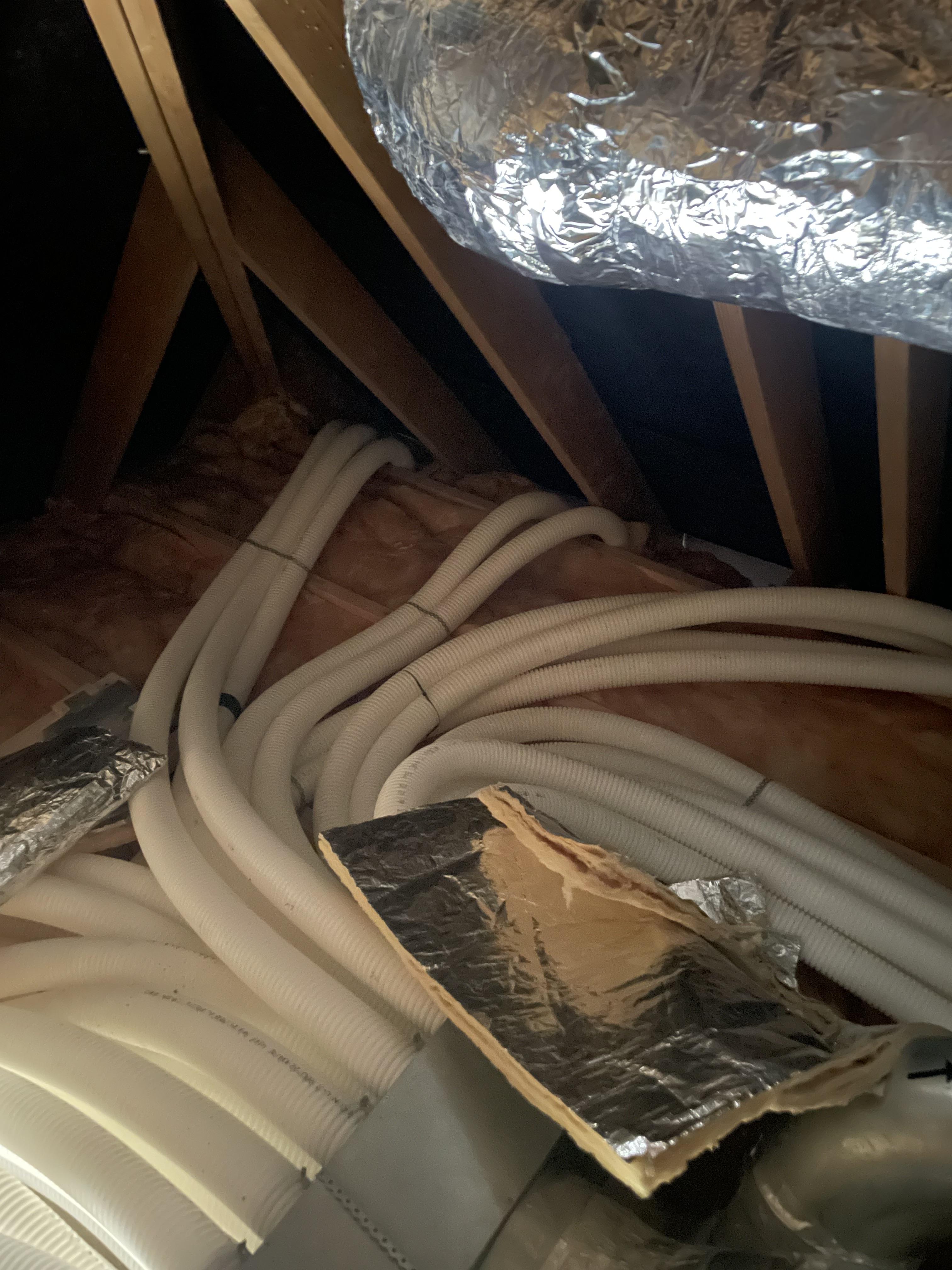

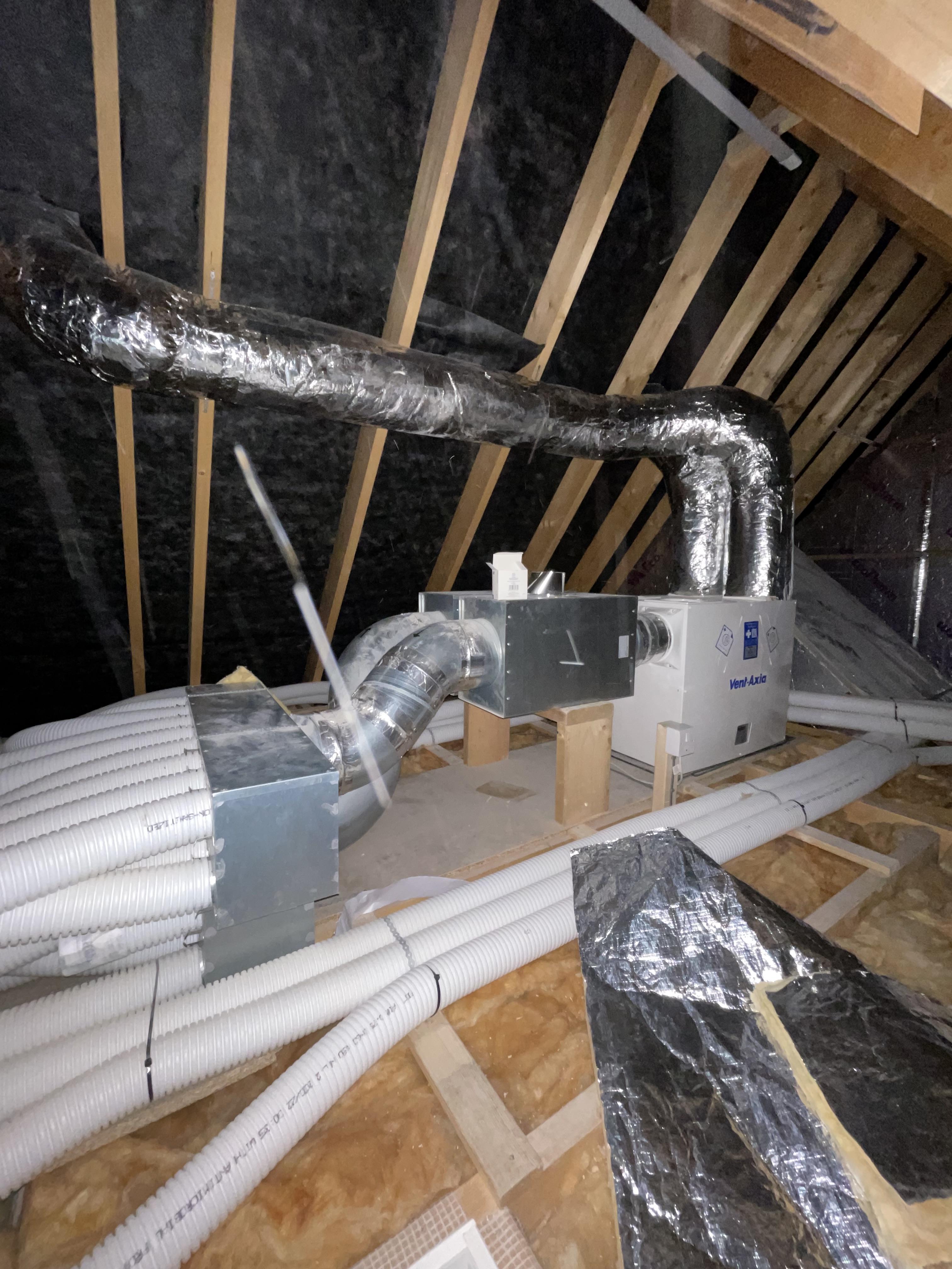

Hi All
i know this has been discussed previous and yes I would of LOVED a warm roof but I haven’t so i could do with some help/inspiration on insulating the MVHR duct work in the loft
i have attached a couple of pictures to show my install. The intake and exhaust ducts are double insulated using 2 lots of the foil insulation
One issue I have if that the ducts have to come up close to the eaves of the roof so conscious I can’t just put 400mm Isover on as it will touch the felt…anything that I could sleeve say 1m or so?
In terms of all the other ducting and associated bits coming off the MVHR I was just going to cover in 400mm Isover spacesaver while making sure I could access the filters
Many Thanks
Jake
I just wrapped the sides of the unit (the back is mounted on brick wall) in the foiled backed insulation. For the front I just used the same insulation but used Velcro to attach it so it’s removable for filter changes.
 I ran them under the loft insulation and built an insulated "room" in the loft for the MVHR unit, water manifolds and any other, lightweight, plant I may need (comms etc)

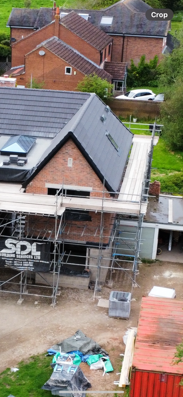

Why so many ducts are so close the eaves?
What vents do you have outside?
Is there no issue with mould/condensation when outlet from the unit go upwards?

Hi @gambo
Due to some awkward positioning of internal steel beams I had to run the majority of my downstairs ducting down a bedroom wall which I then studded off. Not ideal but this was the only way i could make it work
The cowls I have are:
https://masltd.com/product/helios-roof-terminal/
These were installed by my roofer (at least 1.5m apart and horizontally) and then I ducted to them
I questioned the supplier of the system and they were not concerned about mould/condensation, I only turned the system on last week so will just have to see how it goes
