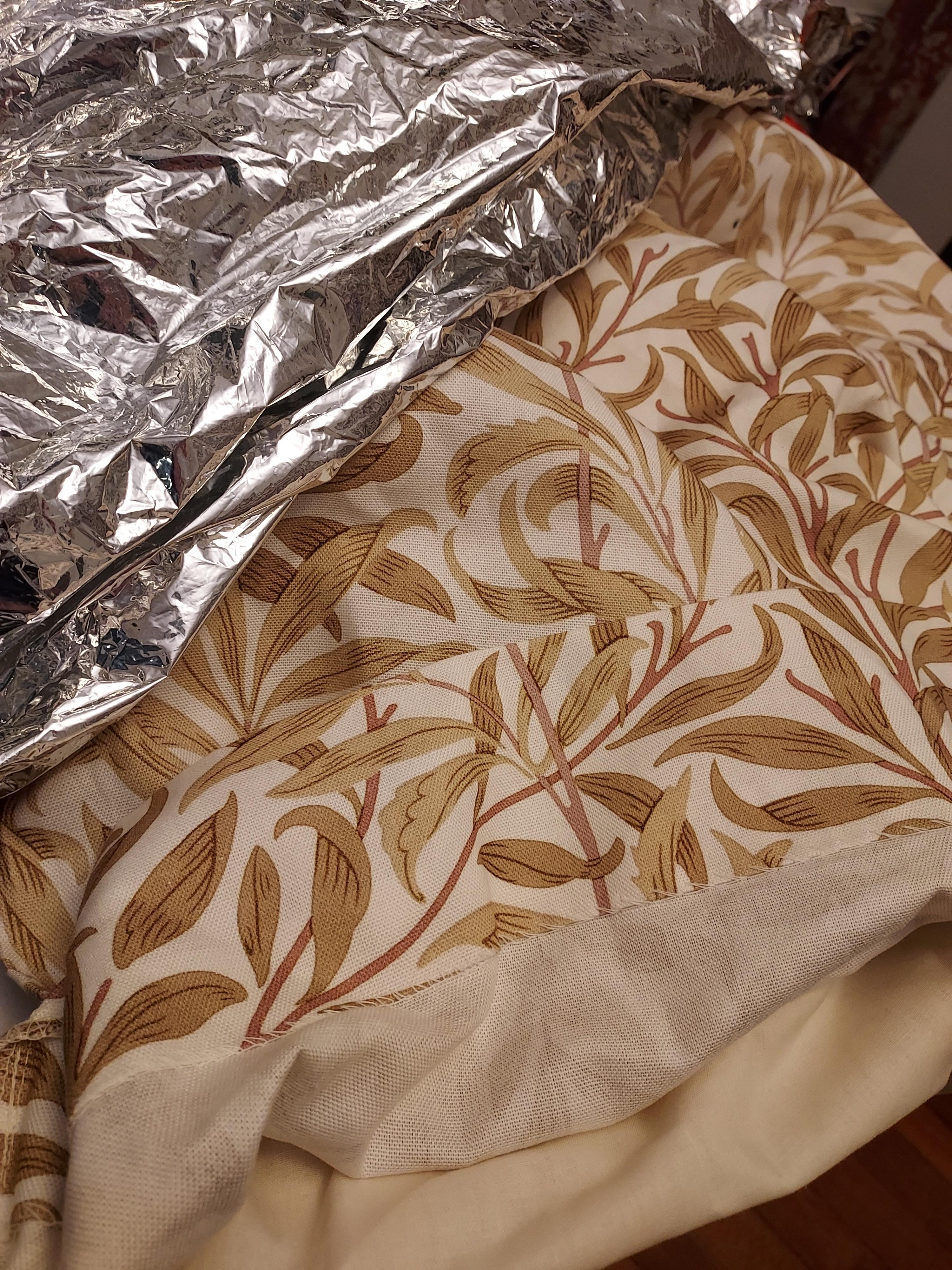

Garald Posted January 30, 2024 Author Posted January 30, 2024 Ok, I just fixed a space blanket to the inside with tape. It's fine, except it crinkles! Will test with a thermal camera on a cold day. Not sure what else I could do easily -maybe put in a thick layer of polar tissue, also with tape, so that I can remove it when the curtain needs to be washed?

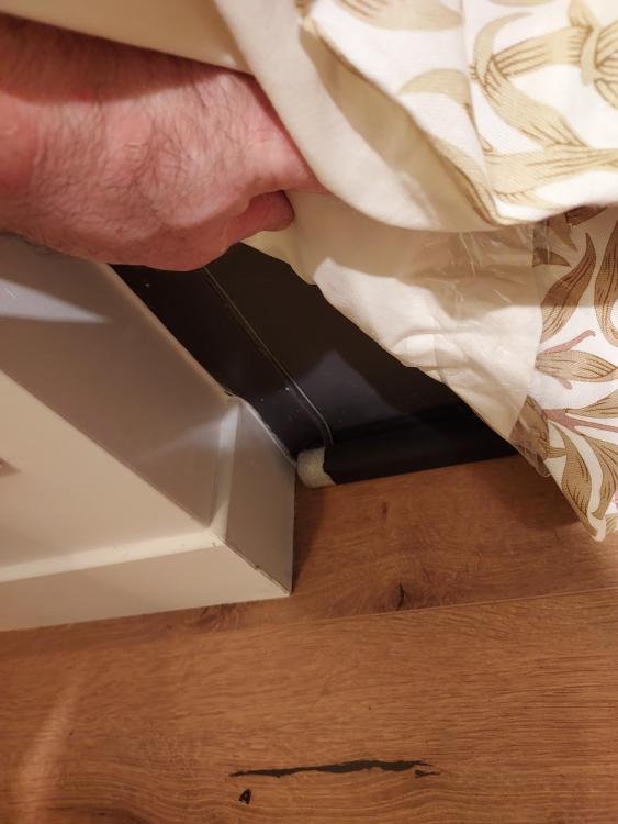

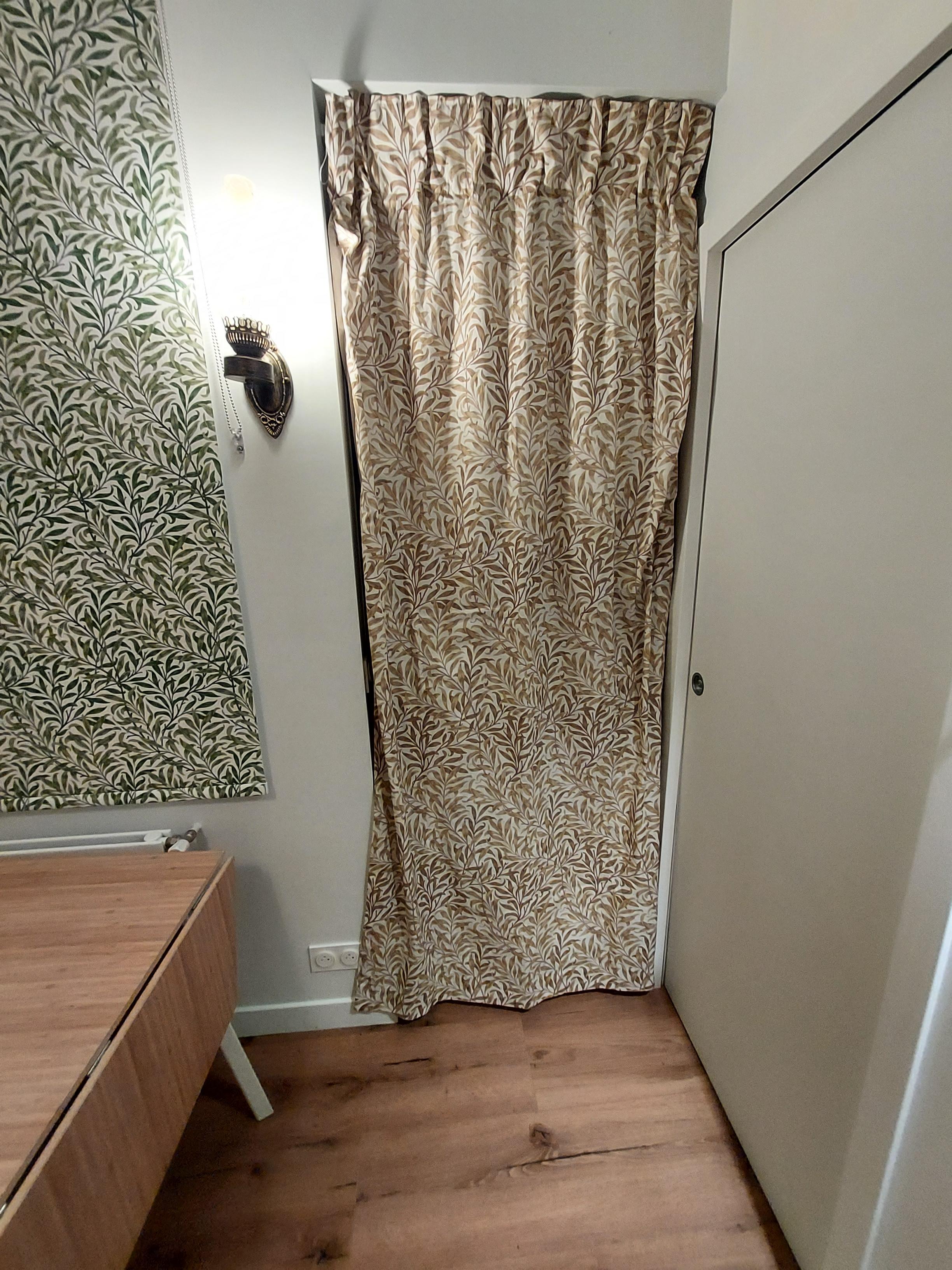

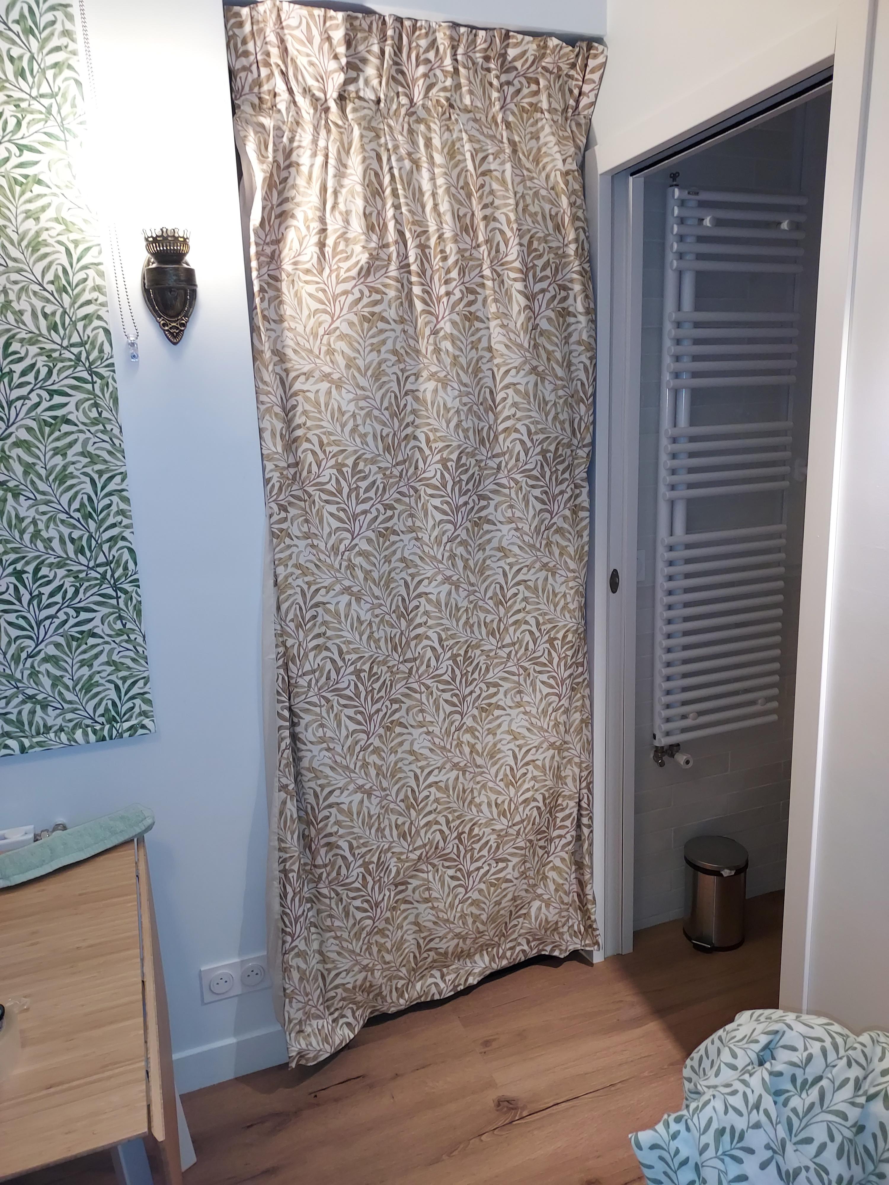

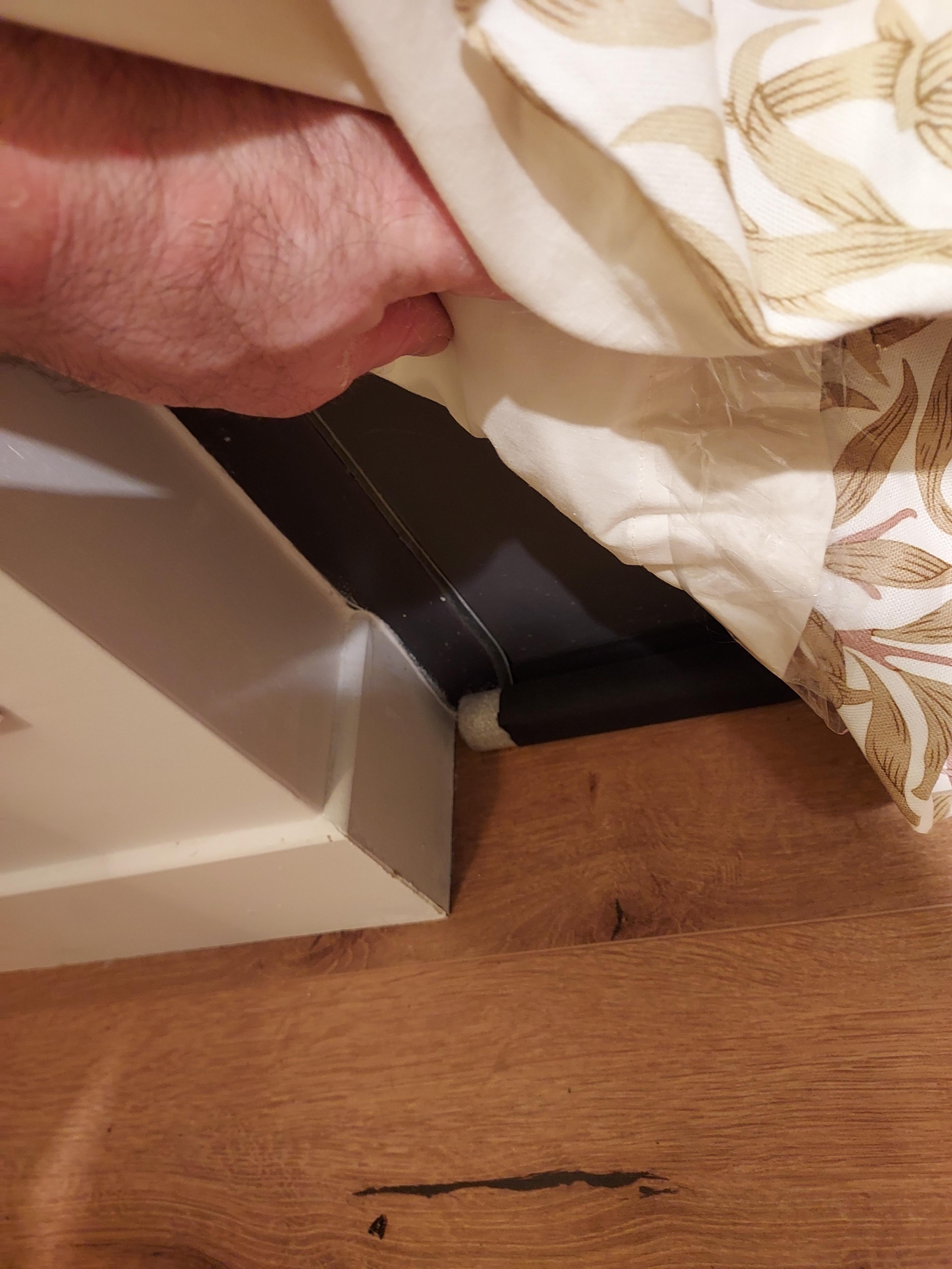

Garald Posted February 9, 2024 Author Posted February 9, 2024 After a lot of scotch tape, here it is. Three layers of Climasheet Apex 133 (R = 0.5R each) sandwiching two layers of reflective I suasion (one space blanket and one overpriced lining from Moondream that essentially amounts to a space blanket. Should I tape the bottom of the curtain to the bottom of the door?
Pendicle Posted February 10, 2024 Posted February 10, 2024 Great Aunt Flo would have stuffed a stocking with the contents of an old pillow and used as a draught excluder at the bottom of the door, I would then have come along and added some eyes, nose, ears and tail and given it a name.
Garald Posted February 10, 2024 Author Posted February 10, 2024 1 hour ago, Pendicle said: Great Aunt Flo would have stuffed a stocking with the contents of an old pillow and used as a draught excluder at the bottom of the door, I would then have come along and added some eyes, nose, ears and tail and given it a name. Oh, but there is a draught excluder!
