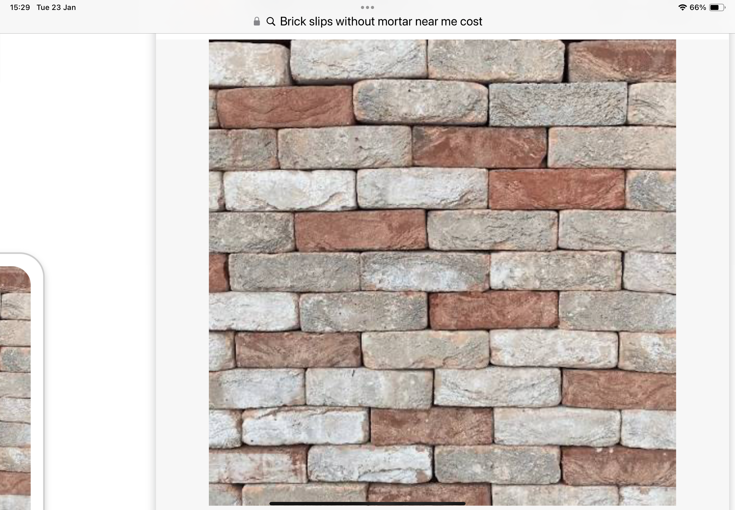

Woody1948 Posted January 23, 2024 Share Posted January 23, 2024 Hi first time poster. I am about to install some Champagne coloured ? brick slips around a backsplash and sink and one small wall. I have purchased the appropriate grout and adhesive. However after not doing my homework I see the European method is to mount the slips on one another without the grout. Any thoughts on this. Thanks Jim. Link to comment Share on other sites More sharing options...
saveasteading Posted January 23, 2024 Share Posted January 23, 2024 9 minutes ago, Woody1948 said: European method is to mount the slips on one another without the grout. Got any pictures? I haven't heard of this. Tolerance adjustment seems one very good reason for a grout gap. Link to comment Share on other sites More sharing options...
Woody1948 Posted January 23, 2024 Author Share Posted January 23, 2024 49 minutes ago, saveasteading said: Got any pictures? I haven't heard of this. Tolerance adjustment seems one very good reason for a grout gap. Link to comment Share on other sites More sharing options...
Woody1948 Posted January 23, 2024 Author Share Posted January 23, 2024 Link to comment Share on other sites More sharing options...

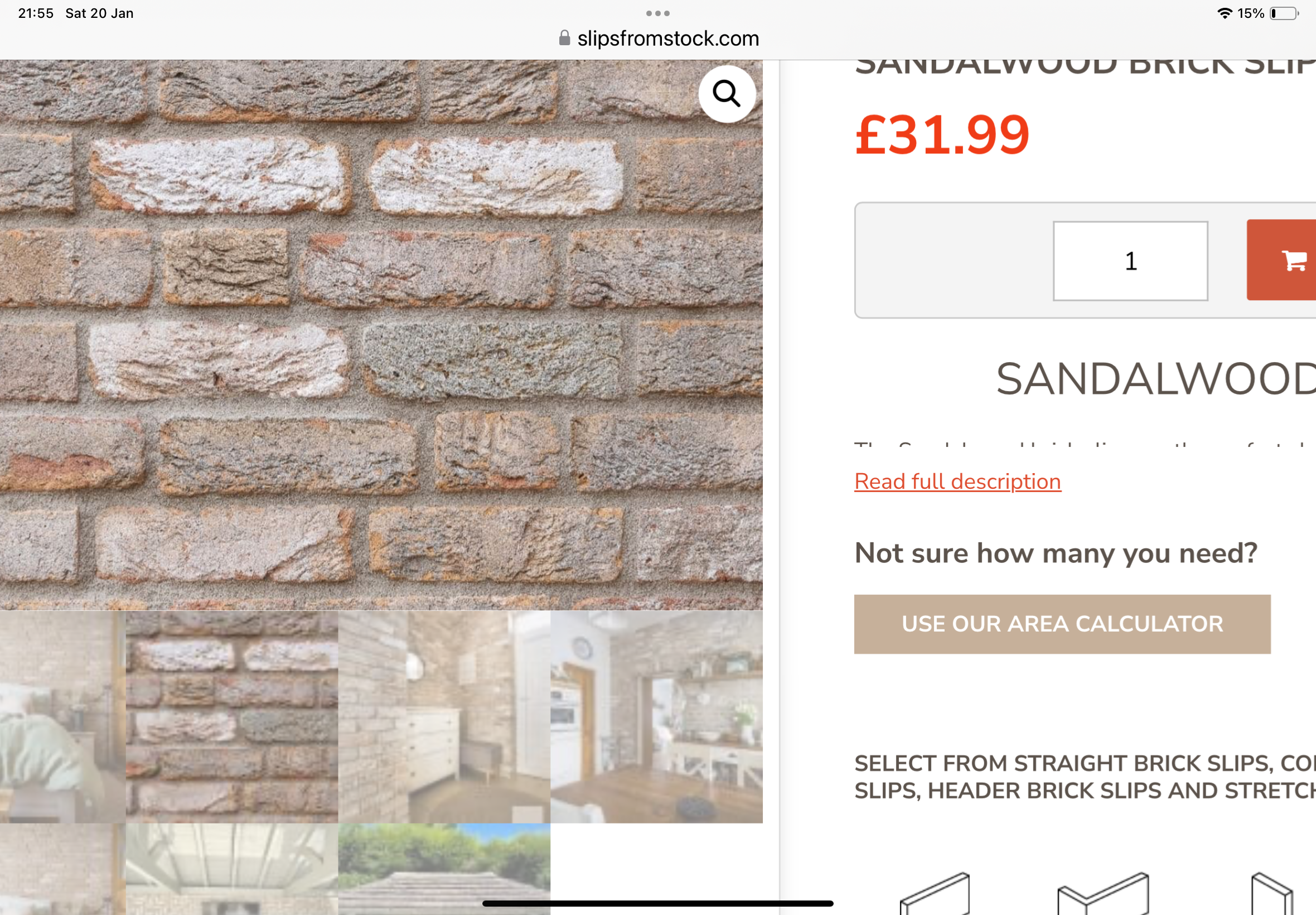

Woody1948 Posted January 23, 2024 Author Share Posted January 23, 2024 With and without think I like the mortar. But some may prefer without.? Link to comment Share on other sites More sharing options...
Mike Posted January 23, 2024 Share Posted January 23, 2024 3 hours ago, Woody1948 said: However after not doing my homework I see the European method is to mount the slips on one another without the grout. I've not come across that. The closest would be Zellige ceramic tiles, which are close-butted but still grouted. Without grout they would soon become a cleaning problem. Link to comment Share on other sites More sharing options...
Polish Builder Posted January 24, 2024 Share Posted January 24, 2024 you might end up with few cracks here and there Link to comment Share on other sites More sharing options...
saveasteading Posted January 24, 2024 Share Posted January 24, 2024 Without grout looks like a pile of bricks and spider hotel, to me. 1 Link to comment Share on other sites More sharing options...
