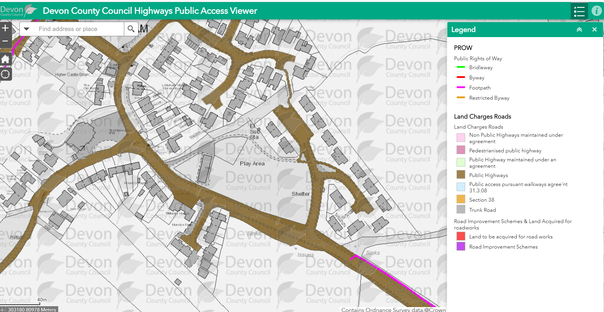

If I were to dig a basement room in the corner of my garden near to a ( non traffic )but tarmac lane  do I need to inform the local authorities?

I'd assume it would need planning permission, and highways / LA will be informed through that process. You'll likely need an SE to advise on the methodology.

@NicWho owns this lane ?
The Highways, County Council will have a definitive map.
You're fortunate that Devon's is on line.  We [Leic's] still have to send a cheque for £40 to get an extract, which we did to ensure our visibility splays only included Highway's land.
https://map.devon.gov.uk/portal/apps/webappviewer/index.html?id=2cfc02549b8940e29749f5dd3b32ca19
From this you can see roads and even which bits of verge they own. Obviously with the usual rider in the T&C's to consult the master map.
Here's a Random extract near Devon Cliffs Holiday park:-
