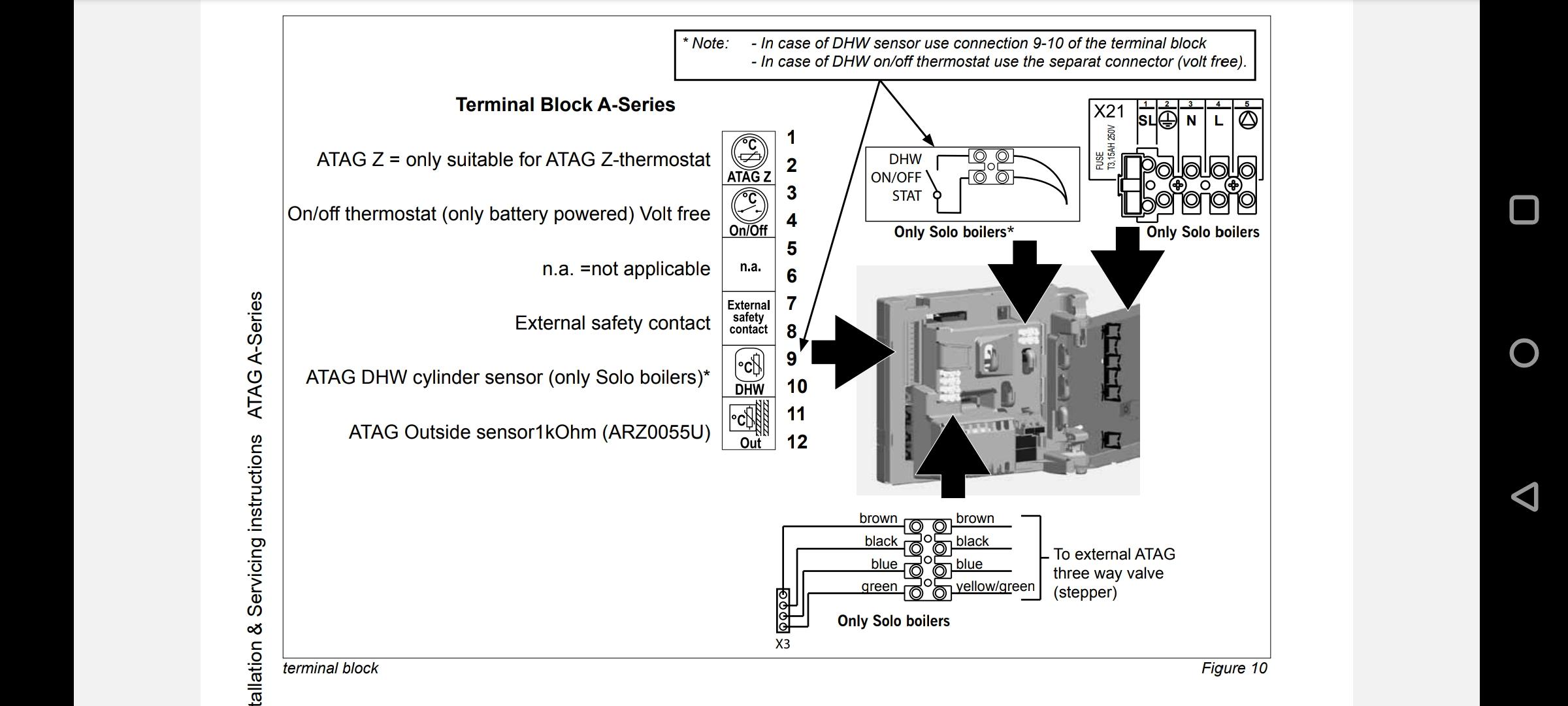

JohnMo Posted January 24, 2024 Posted January 24, 2024 3 hours ago, nikbower said: do you know how I work out the reheat time for the cylinder Look at the cylinder datasheet it should have that information. 3 hours ago, nikbower said: you know whether it's possible to connect a system boiler to OSO Delta Geocoil in X Plan You need to look at the boiler manual not the cylinder manual. X plan uses a 3 port diverter, S and Y use either mid point valve and a two port or two 2 ports valves. Cheap boilers maybe don't do X plan, this is an Intergas wiring for X plan. X-Plan-diagram-Rapid-HRE-Eco-RF-low-voltage-option-V1.pdf And an Atag boiler all the connections are within the boiler 3 hours ago, nikbower said: This cylinder only comes with a 22mm DHW outflow connection. From the point of view of maximising flow rates, how much of an issue is that likely the be vs a cylinder that has a 28mm outflow? Last thing you want to do is run hot water in 28mm, as it will never get to the taps. Mine comes out the top of the cylinder in 22mm, goes into a tee and is reduced to 15mm (Hep2O), one side goes to the kitchen and the other side to a manifold and then to shower room, 2x ensuites and a utility room.

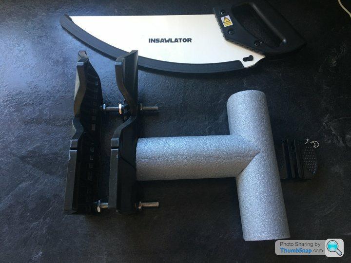

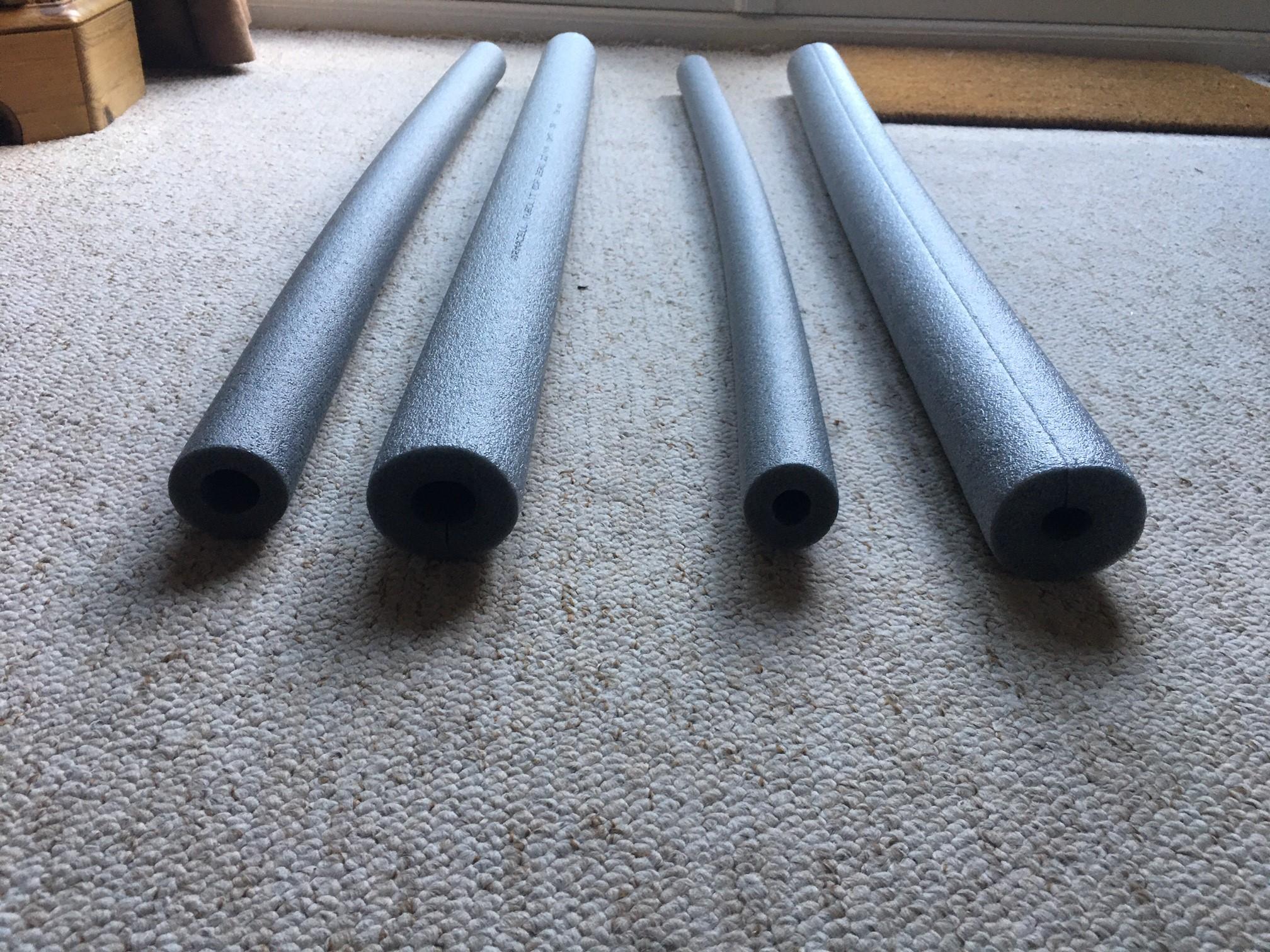

JohnMo Posted January 25, 2024 Posted January 25, 2024 9 hours ago, marshian said: once a week I do a legionaires cycle Do yourself a favour and go onto heat geek site and read up on legionnaires, if you consume all your hot water daily there is zero point doing the cycle. If it's vented cylinder you are going to have bigger losses as you have a vertical pipe out the top of the cylinder. Insulate with 25mm wall thickness foam. As a side note - Insulation with gaps isn't any good. So make sure the mitred ends match up with the next piece and tape all the joints nice and tight together, along the length and at the corners - use electric insulating tape. Take the insulation a good couple of meters away from the cylinder. Go to a plumbers merchants they do 2m lengths. Use 19 or 25mm wall thickness at valves or compression joints use 35x9 insulation.
marshian Posted January 25, 2024 Posted January 25, 2024 1 hour ago, JohnMo said: Do yourself a favour and go onto heat geek site and read up on legionnaires, if you consume all your hot water daily there is zero point doing the cycle. If it's vented cylinder you are going to have bigger losses as you have a vertical pipe out the top of the cylinder. Insulate with 25mm wall thickness foam. As a side note - Insulation with gaps isn't any good. So make sure the mitred ends match up with the next piece and tape all the joints nice and tight together, along the length and at the corners - use electric insulating tape. Take the insulation a good couple of meters away from the cylinder. Go to a plumbers merchants they do 2m lengths. Use 19 or 25mm wall thickness at valves or compression joints use 35x9 insulation. Heat Geeks - yep well read on the Legionaires issue but the better half likes a deep long hot bath once a week so I take the tank temp up to 60 on that day to ensure I have a little water left for my shower so it doubles up as a win I think my insulation is pretty good but thanks for the tips on using 35 x 9 - I shall get some to deal with valves and compression joints as they aren't currently insulated Rest of the pipework insulation is all 25 mm wall on 15 mm Copper or 19 mm wall on 22 mm Copper - this way I can set up the mitre box once and it works for both 15 mm and 22 mm Old and new insulation pictured below - thin stuff is std DIY shop and bigger stuff is Turbolit that I bought 50 m of each as all my CH and HW pipes run below a very well ventilated suspended ground floor

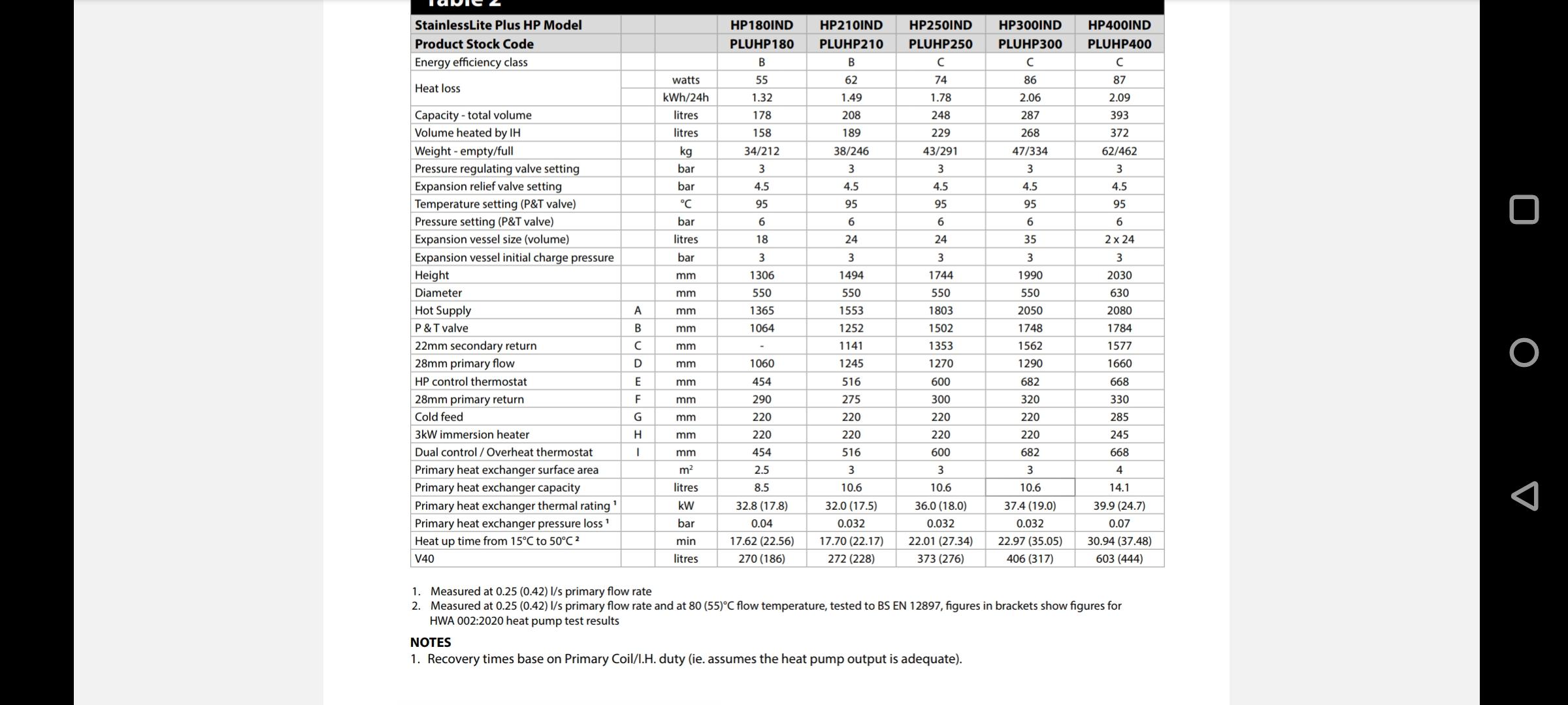

nikbower Posted January 25, 2024 Author Posted January 25, 2024 16 hours ago, JohnMo said: Look at the cylinder datasheet it should have that information. I'm looking at cylinders designed to work with a heat pump. They give a re-heat time, but isn't that the time you'd expect if running them off a heat-pump? I thought the idea of coupling that design of cylinder with a system boiler was to get a much quicker reheat... but they don't seem to have that information
JohnMo Posted January 25, 2024 Posted January 25, 2024 Gledhill data as I had on the computer for heat pump cylinder, reheat time given for two flow temps So for a 210L cylinder at 80 degree flow, reheat time is 17 mins or with 55 flow 17 mins. A standard boiler cylinder from Gledhill is 32 mins reheat time at 80 degree flow.
SimonD Posted January 25, 2024 Posted January 25, 2024 17 hours ago, JohnMo said: You need to look at the boiler manual not the cylinder manual. X plan uses a 3 port diverter, S and Y use either mid point valve and a two port or two 2 ports valves. For PDHW you can also use a normally open and normally closed 2-port valve if you're modifying an existing s-plan, but the boiler should ideally support two temps of course. 1
nikbower Posted January 25, 2024 Author Posted January 25, 2024 4 hours ago, JohnMo said: So for a 210L cylinder at 80 degree flow, reheat time is 17 mins or with 55 flow 17 mins. A standard boiler cylinder from Gledhill is 32 mins reheat time at 80 degree flow. Right! I see that information for Gledhill - 17 minutes at 80 degree flow and 22 mins at 55 degrees. But that is for heat-up to 50 degrees, whereas the 32 mins given as time to heat the standard cylinder is for heat-up to 60 degrees and it doesn't say at what flow rate... I wonder how different they are on a like-for-like basis. OSO doesn't seem to provide the same information on their cylinder
