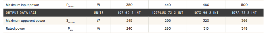

SuperPav Posted January 16, 2024 Author Posted January 16, 2024 My garage feed is on a 50A MCB at the moment which having just had a look is indeed on a RCD on the main CU, which is indeed unnecessary I suppose as it could be rewired just straight off the main switch. Garage is fed by 16mm cable as it was sized to be big enough to feed a heat pump, two EV chargers (+ usual garage circuits), and be big enough to reverse-feed the house if we ever upgrade the supply to 3phase - the easiest way would be to run 3 phase to the garage and then split one phase off back to the main house for the domestic loads, as all the big stuff is in the garage. As I'll only ever be able to get an absolute max of approx 4kwp on the roof (to , I'd try and use as much as possible of it via immersion dumping or dumping into one of our two EV's if we ever have a surplus, just seems crazy to lose 30% of the capacity of the cells, maybe I'm overthinking it... I'll be honest I also don't quite understand how they can be rated to 400W DC and only 300kVA AC - what's the point of the 400W DC rating in that case?
Alan Ambrose Posted January 16, 2024 Posted January 16, 2024 >>> 400W DC and only 300kVA AC Yeah, I see, I'm looking e.g. at this: https://enphase.com/en-gb/download/iq7-microinverter-qdcc Maybe something to do with peak input vs. continuous output power? As @Dillsue said - maybe you just need to choose beefier microinverters?

SuperPav Posted January 16, 2024 Author Posted January 16, 2024 I have no existing inverter, it's a "ground up" install. Plan to stay within G98 regs using enphase microinverters via their Envoy controller to keep it at sub 3.68kW total. Looks like I'll need to go for the IQ7A's or IQ8's to avoid clipping, the price difference vs the IQ7 doesn't seem massive to be fair.
