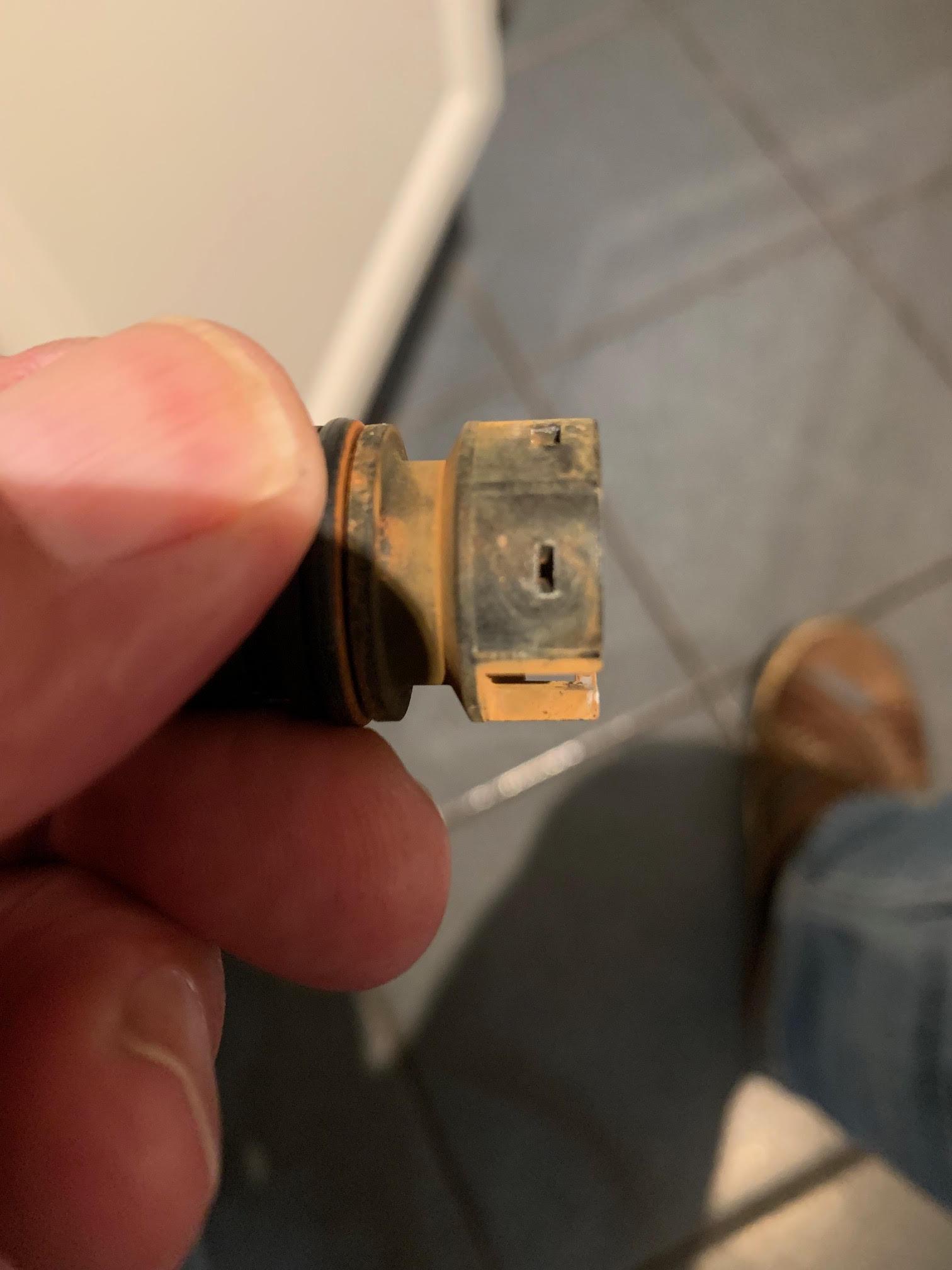

I'm struggling with the comment that the 10mm pipework is limiting flow to the rads and as a result you need to run the boiler hotter...........
I run drayton EB4 TRV bodies and the vast majority of the rads are using flow setting 1 out of 6 and that's a flow restrictor of less than 2mm diameter...

I'm not running weather comp but I am running flow temps between 45 and 50 deg C depending on the temp outside
I'm doing this thro EB bodies mainly set on 1..........
I really don't think you will get any benefit from increasing pipe size JM2pW
