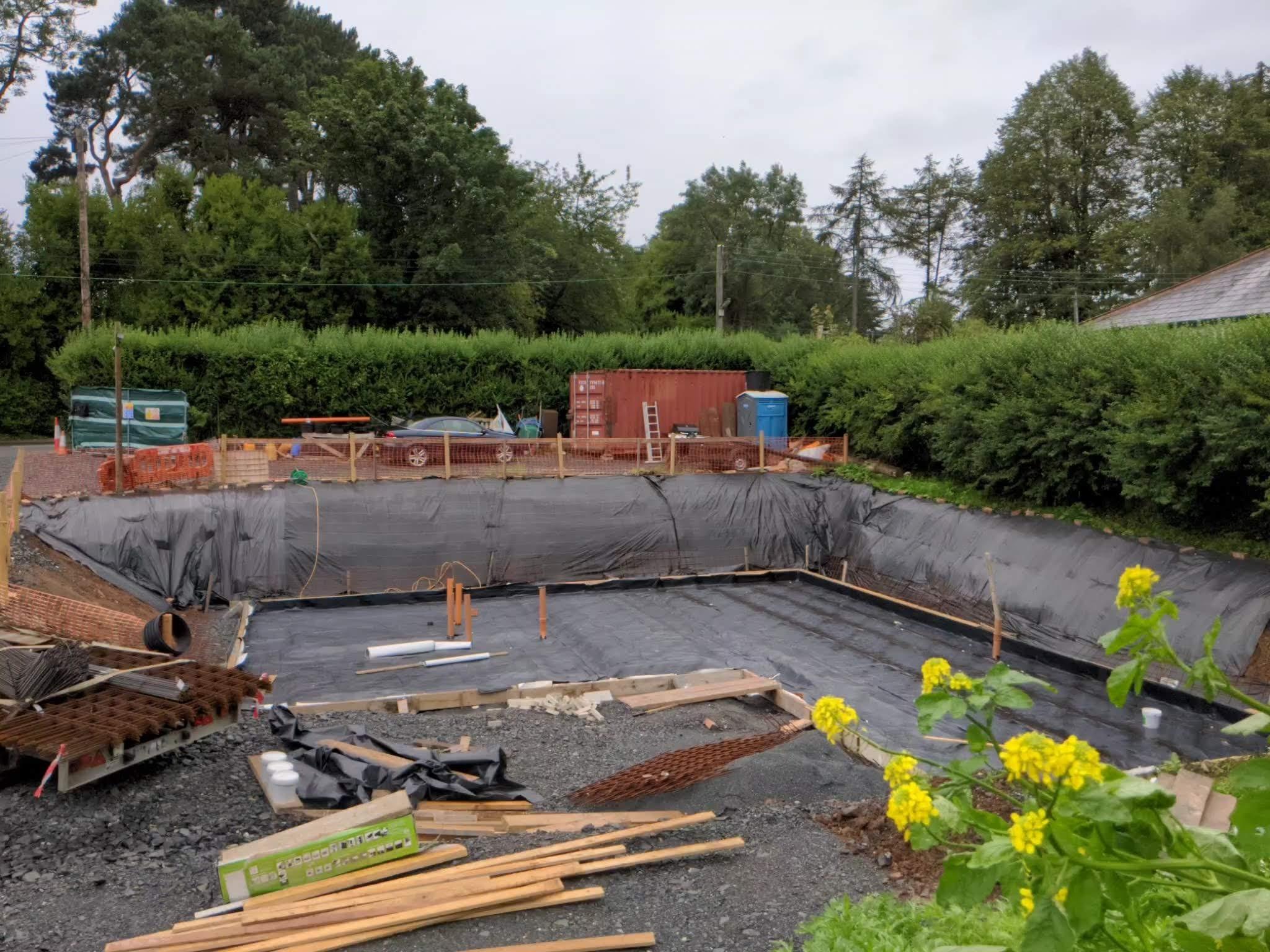

Conor Posted January 3, 2024 Share Posted January 3, 2024 If you've somewhere for the soil to go, that's a massive chunk saved! It will be a substantial concrete structure. Maybe a 150mm slap with min one layer of mesh, the walls will be 200mm with plenty of rebar. Having part of the garden above will add a certain level of complexity. ICF is an option but tanking will be your biggest challenge. You'll most likely need a third party to do this in order to satisfy building control and house insurers / mortgage companies. It'll need to be a full wrap around as part of it will be under your garden. Other big costs will be drainage, importing a LOT of stone, insurance (excavations over a certain depth will attract a higher premium, for good reasons.) Other than that, basements are easy Link to comment Share on other sites More sharing options...
jayc89 Posted January 3, 2024 Author Share Posted January 3, 2024 1 hour ago, Conor said: If you've somewhere for the soil to go, that's a massive chunk saved! It will be a substantial concrete structure. Maybe a 150mm slap with min one layer of mesh, the walls will be 200mm with plenty of rebar. Having part of the garden above will add a certain level of complexity. ICF is an option but tanking will be your biggest challenge. You'll most likely need a third party to do this in order to satisfy building control and house insurers / mortgage companies. It'll need to be a full wrap around as part of it will be under your garden. Other big costs will be drainage, importing a LOT of stone, insurance (excavations over a certain depth will attract a higher premium, for good reasons.) Other than that, basements are easy Yeah that was along similar lines to what I was thinking. I believe I have the space around the basement area to create a 45 degree slope, although some of that sloped section is where some of the, above ground, extension foundations would go, so presumably I'd need to shutter and pour those prior to backfilling the slope? Grey being the basement outline, brown being the ~3m sloped area around it. Link to comment Share on other sites More sharing options...
Conor Posted January 3, 2024 Share Posted January 3, 2024 You'd need to do a soil investigation and have a SE advise. Especially when within 4m of a structure. Our soil was particularly stiff, allowing 60⁰ battering with membrane to reduce erosion. You'll not be able to build standard foundations for the extension on ground that you've disturbed. Lots of factors and worth a chat with your architect and SE. Link to comment Share on other sites More sharing options...
