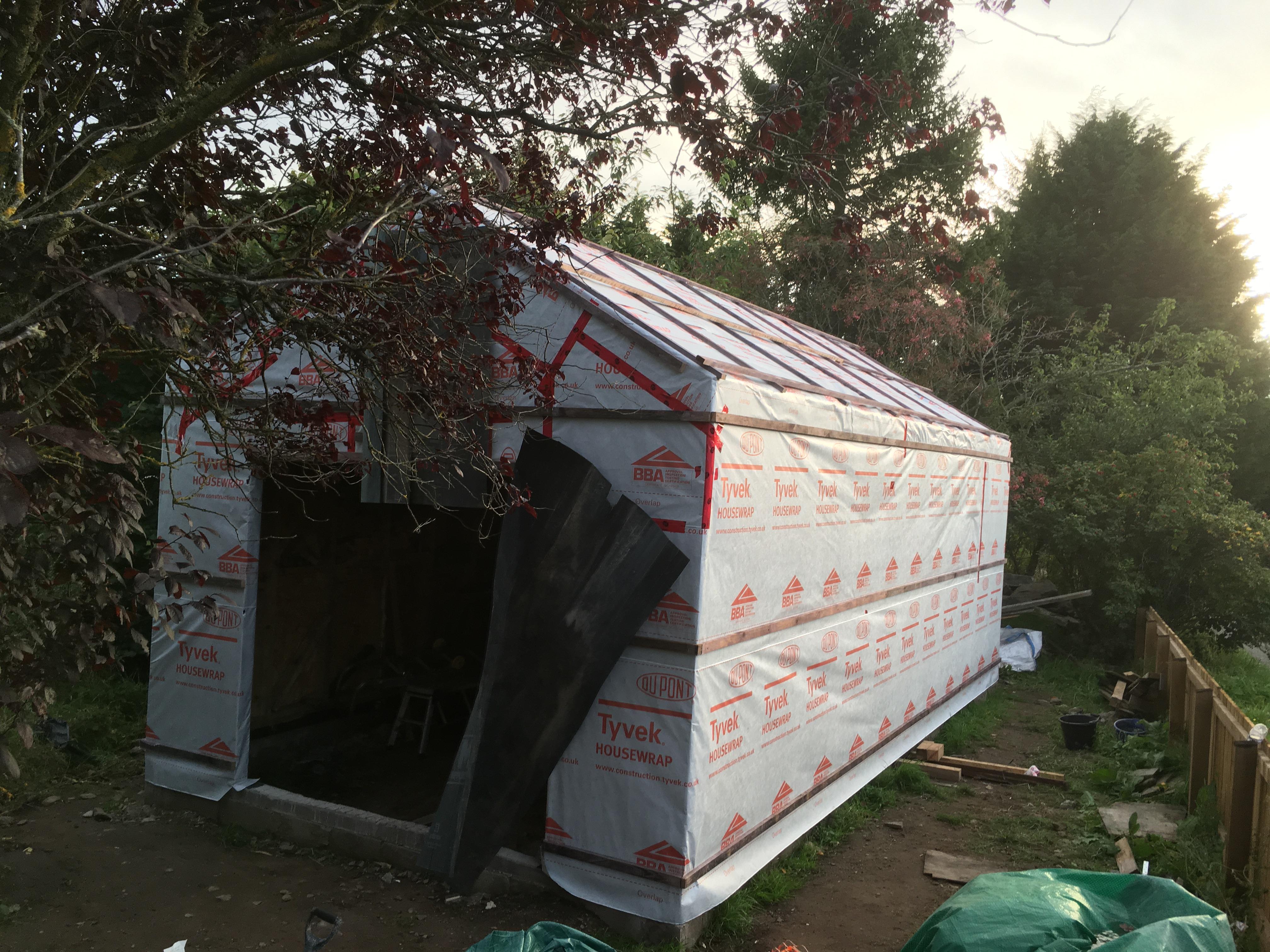

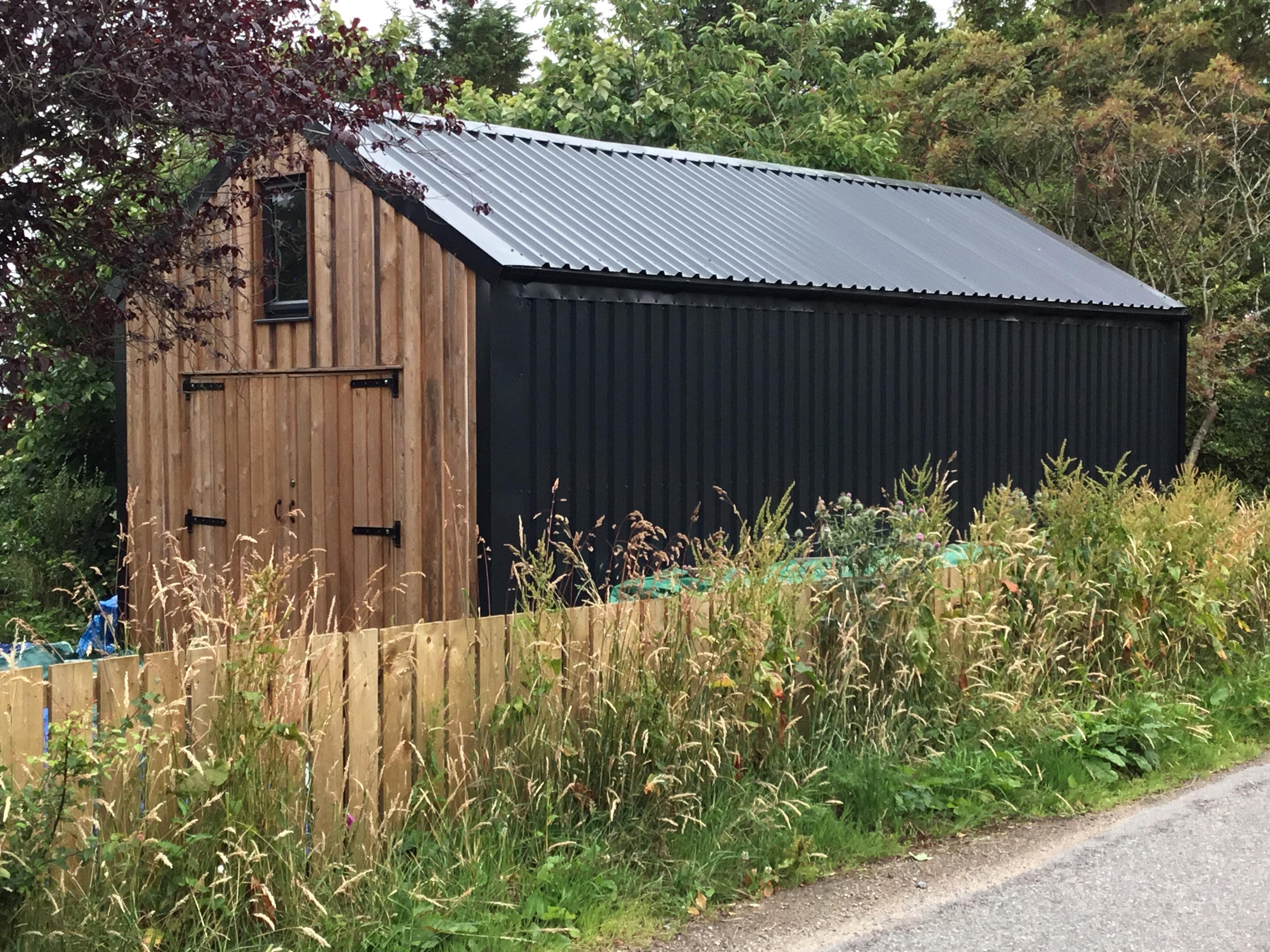

Bozza Posted December 24, 2023 Share Posted December 24, 2023 There are so many options for something like this. There’s that garden rooms bloke on YouTube that advocates cementing threaded rods into the ground and building off that. Also your skill level - what you can do yourself - costs of materials etc etc. I’d never built anything before so my small barn was DIY constructed as follows ( apologies if using wrong terminology). for founds I did a strip foundation with deeper dig at 6 points - four corners plus mid way (8x4 building). Couple of courses of brickwork around. Foundations. In filled with hardcore, sand, dpc, solid insulation then did a concrete hand pour over top to create concrete floor. Treated timber bottom plate 4x2 fixed to perimeter brickwork. I built a series of modular 2.4 x 1.2 wall panels out of 4x2 with 9mm osb on face. These were bolted to the bottom plate. Built the gables same way, then the roof timber, beams etc for a 45 deg roof. Clad structure in breathable membrane. Insulated the framework and put airtight polythene stapled inside. Whole thing clad in combo of steel sheeting and leftover Siberian larch from house. Interior not yet finished but thing has not moved even in storms. Inside it’s not cold in winter and not hot in summer. saved a fortune building it myself and really enjoyed doing it learning many skills I hadn’t done before other than usual diy around home. 4 Link to comment Share on other sites More sharing options...
