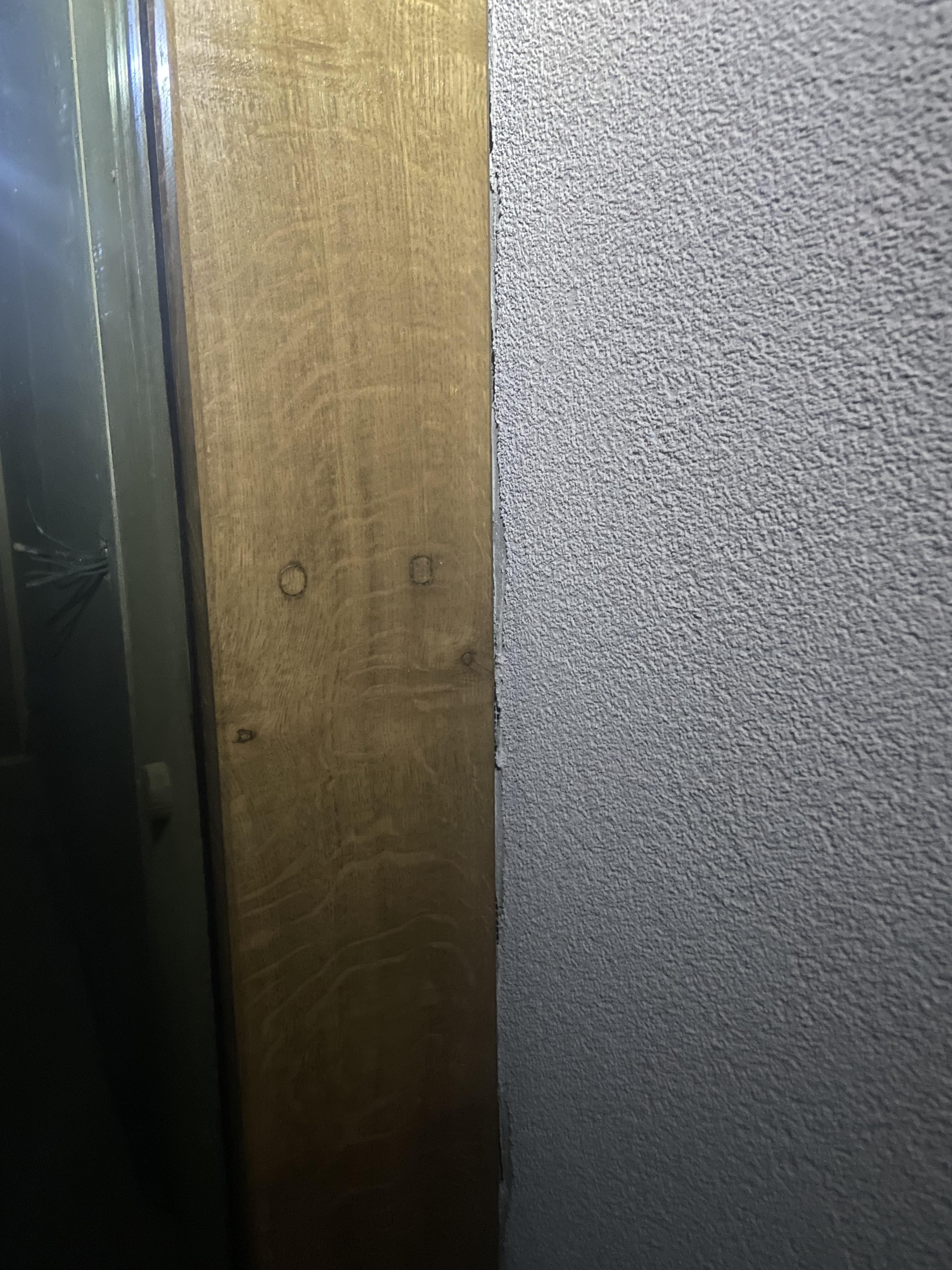

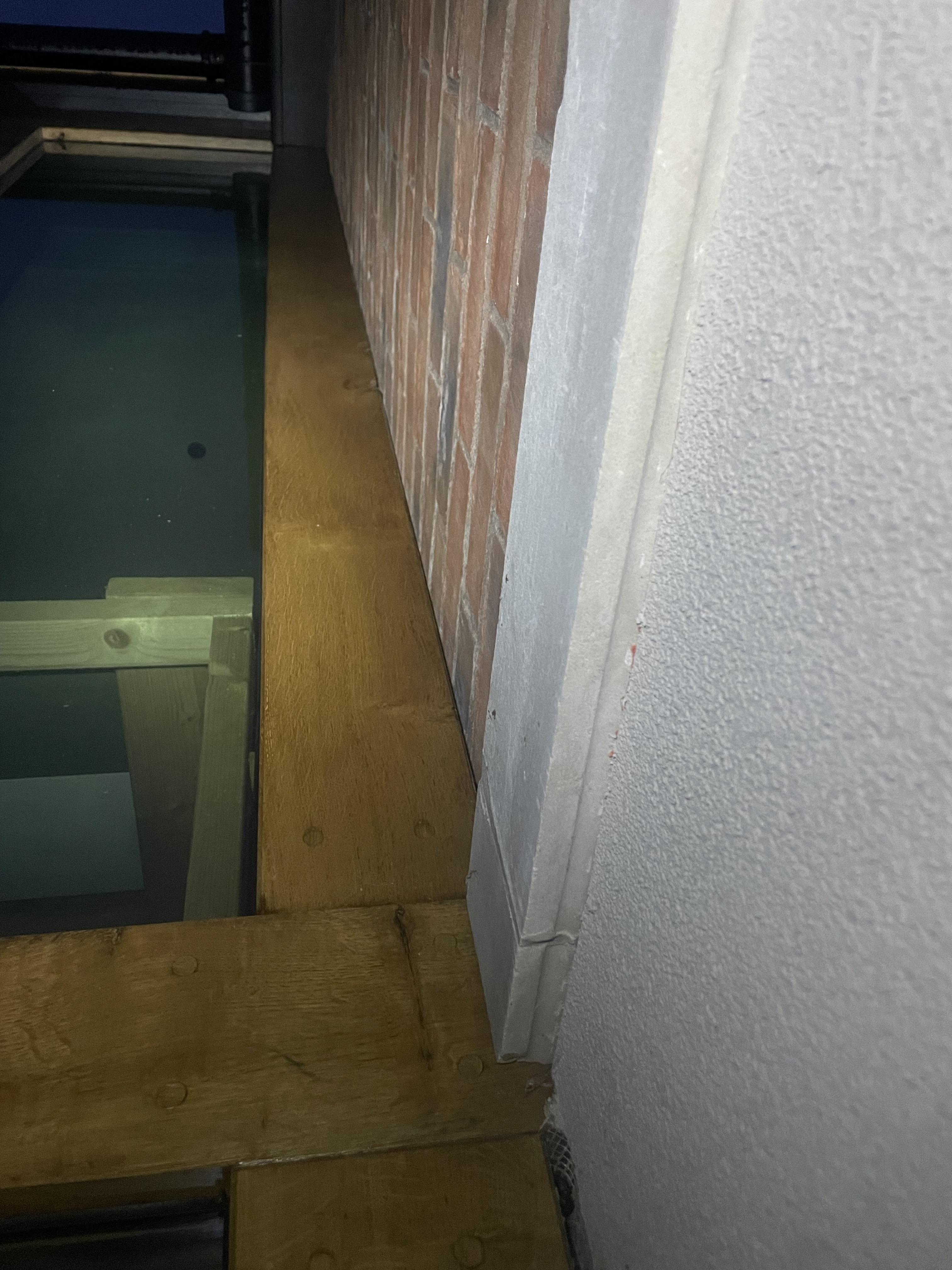

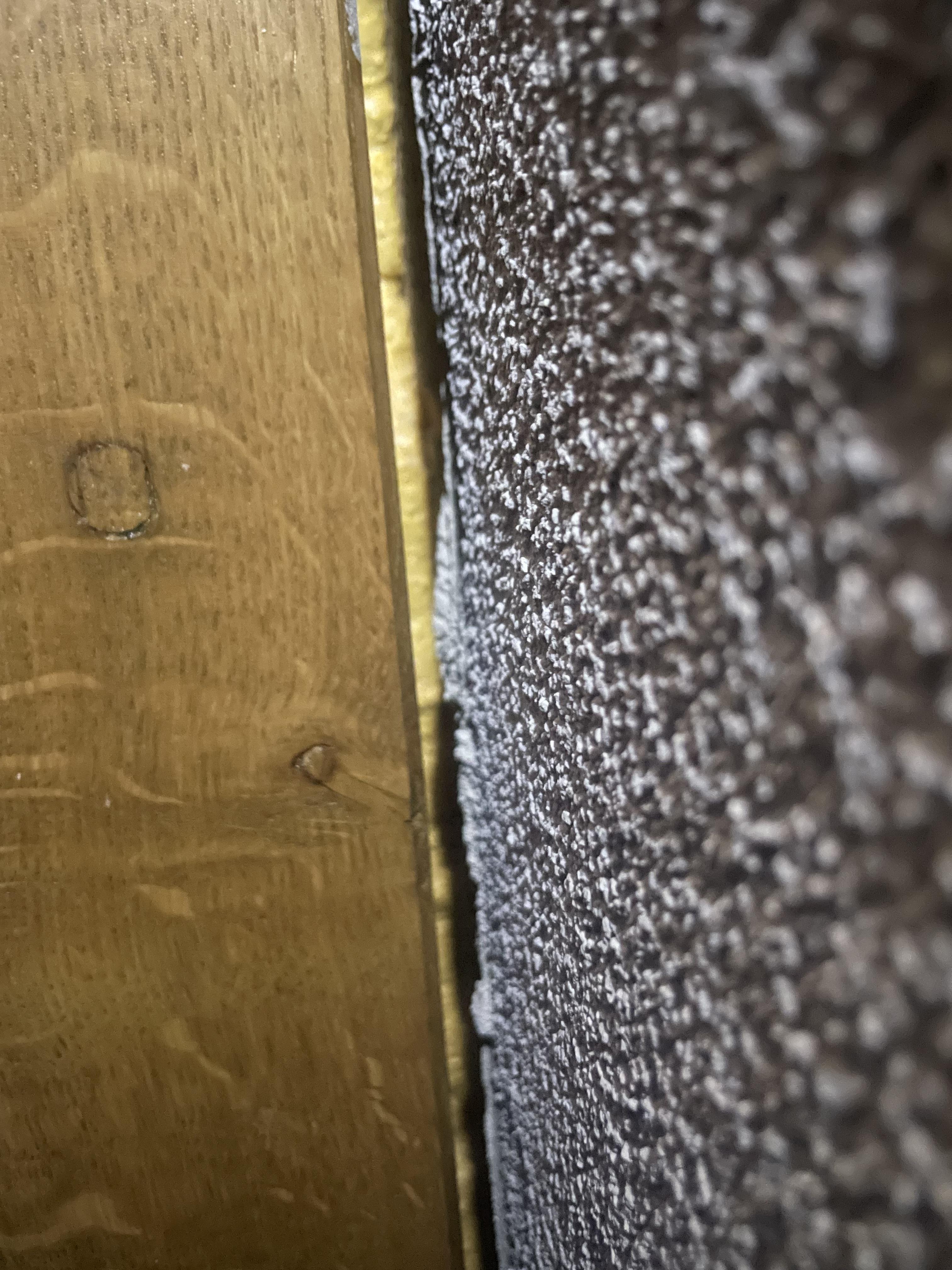

richo106 Posted December 5, 2023 Share Posted December 5, 2023 Apologies for another post asking for help but at the minute I seem to have issues all the time that need addressing. I have a large oak glazed front that is in between 2 walls and I have only just think that it needs to be sealed from the oak the wall, either rendered or brick. I think this maybe the source of some dampness internally on the oak. I have used airtight foam and tape on the inside from oak to block but as you can see there is a large gap from the wood to the wall, at least 10mm in some places. what is the best way to ensure a good watertight seal? Spray in some air tight foam and then a thick clear sealant bead? as always any advice or ideas very much appreciated Link to comment Share on other sites More sharing options...

richo106 Posted December 5, 2023 Author Share Posted December 5, 2023 Any tips on how to do a wide silicone bead? Link to comment Share on other sites More sharing options...
craig Posted December 6, 2023 Share Posted December 6, 2023 There’s not much you can do here tbh. A good mastic seal is the way forward. Link to comment Share on other sites More sharing options...
richo106 Posted December 6, 2023 Author Share Posted December 6, 2023 9 minutes ago, craig said: There’s not much you can do here tbh. A good mastic seal is the way forward. https://www.dortechdirect.co.uk/catalog/product/view/id/18961.html?gad_source=1&gclid=EAIaIQobChMItLvIxuT7ggMVkaiDBx1Y0gqwEAQYBCABEgIEDvD_BwE Would something like this be ok? cheers Link to comment Share on other sites More sharing options...
craig Posted December 6, 2023 Share Posted December 6, 2023 Should be fine. Link to comment Share on other sites More sharing options...
