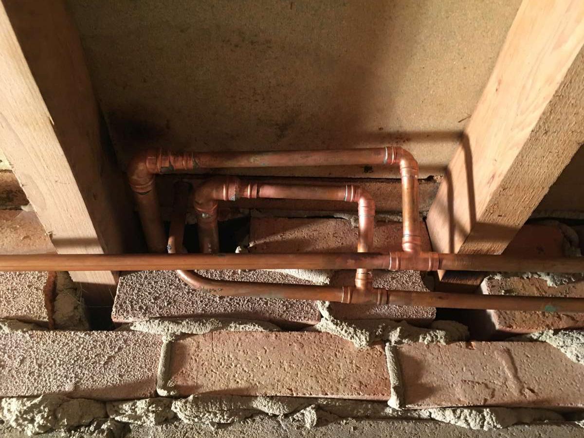

marshian Posted December 4, 2023 Share Posted December 4, 2023 I've got a drain on the flow and return CH pipes that comes from the lowest point under the suspended wood floor and go straight out thro the wall and drain points are accessible via a small hatch in my decking and drain onto the gravel under my decking. only thing that is outside is the drain valve - I really should check one day if either of them actually get warm??? Picture taken before the pipes were lagged and before I put the 75mm PIR insulation above them under the floor Drains valves are to the right to (External to the house) Upper 22mm is the end of the flow and return pipes The pipes going to the left and up and to the left and the feed and return for the last rad on the system The pipework for this rad was a real dogs breakfast as it had been moved from one wall to another and the extended pipework wasn't lagged at all!!! I found similar around the rest of the house when I was under the floor 1 Link to comment Share on other sites More sharing options...
