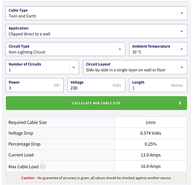

markharro Posted November 23, 2023 Share Posted November 23, 2023 Hi I am making up a power cable with a special right angle connector and just want to make sure that this cable will be beefy enough to cope? I am assuming so as its a left over from our electrician wiring the house but best to check? Link to comment Share on other sites More sharing options...
SteamyTea Posted November 23, 2023 Share Posted November 23, 2023 How long it the cable run and is it going though insulation? What are the chances that the connector you are fitting may get changed to a double socket in the future? I think you are allowed a 5% volt drop. https://www.tlc-direct.co.uk/Technical/Charts/VoltageDrop.html Link to comment Share on other sites More sharing options...
markharro Posted November 23, 2023 Author Share Posted November 23, 2023 Its only between 50cm - 1m as a replacement for a standard power lead. It not getting boarded in anywhere and I will terminate in a standard power plug into a socket. Link to comment Share on other sites More sharing options...
SteamyTea Posted November 23, 2023 Share Posted November 23, 2023 Should be fine. Link to comment Share on other sites More sharing options...
