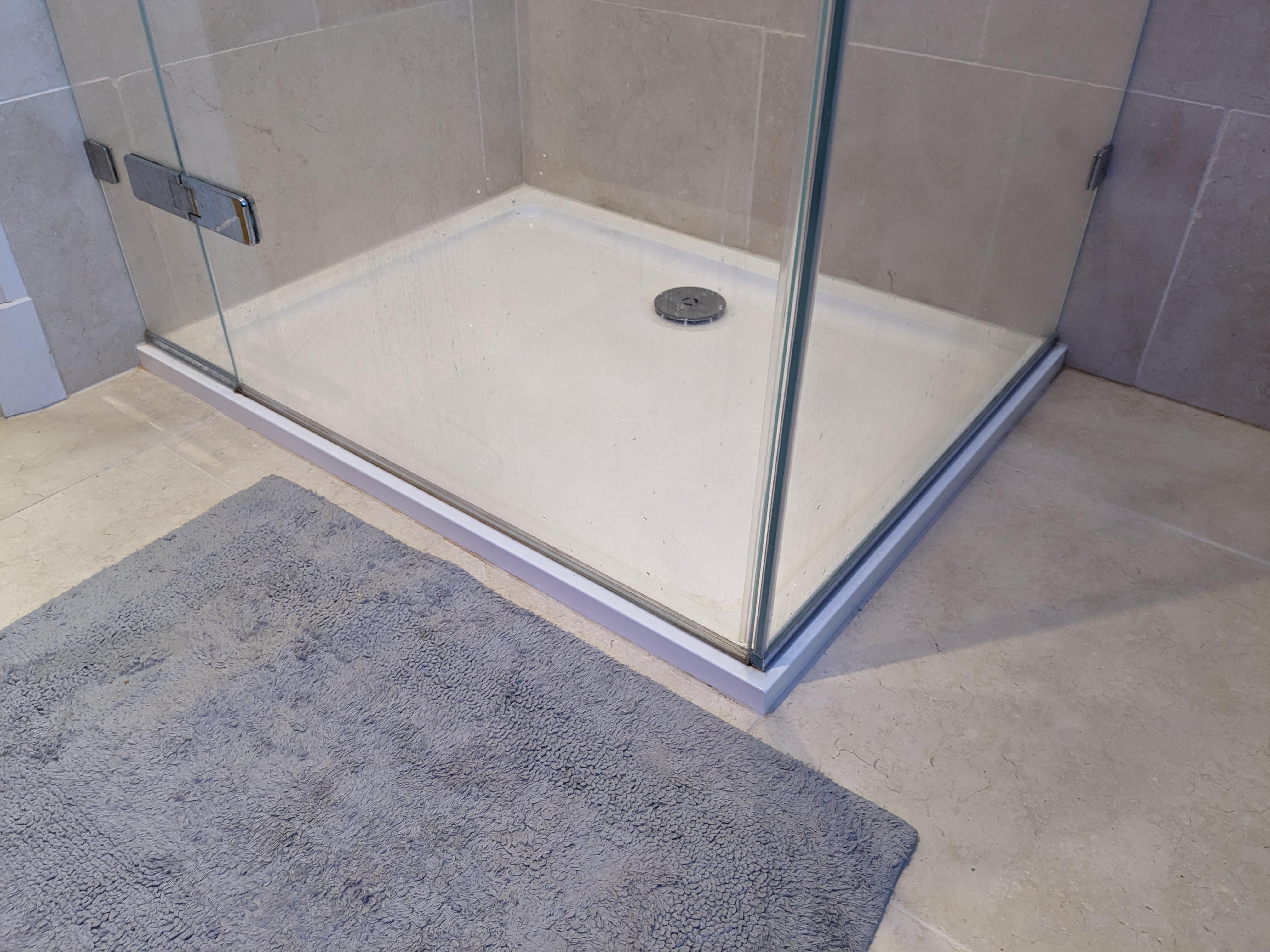

Temp Posted November 17, 2023 Share Posted November 17, 2023 To fit our shower trays we removed a section of insulation under the tray. Then dry fitted the shower waste pipe and the lower part of the trap so it's in the right place. This was loosely supported in position at right height but in a way that allowed it to move vertically bit. Then fitted a frame of pressure treated 2*4 or similar and 18mm WBP ply to support the tray at the right height. The WBP had a clearance hole in it that allows the trap to sit at roughly the height of the top of the WBP/underside of tray. It should be possible to pull the trap up about 0.5" further to allow for the thickness of mortar/adhesive used to fix the tray down. Test you can fit the tray and screw the top part of the trap through the hole into the bottom part. Remove tray and plywood and glue up the pipes. Replace plywood and put rags in trap to stop debris getting in. Screed floor to top of plywood. Fix tray (with mortar/adhesive) and immediately screw in the top of the trap to be sure you can before adhesive sets. Check it level. The heights need to be planned carefully to take into account of the screed and tile thickness plus fall to the drain. It's a bit different for a linear drain but a similar amount of planning and prep is needed before screeding. 1 Link to comment Share on other sites More sharing options...
