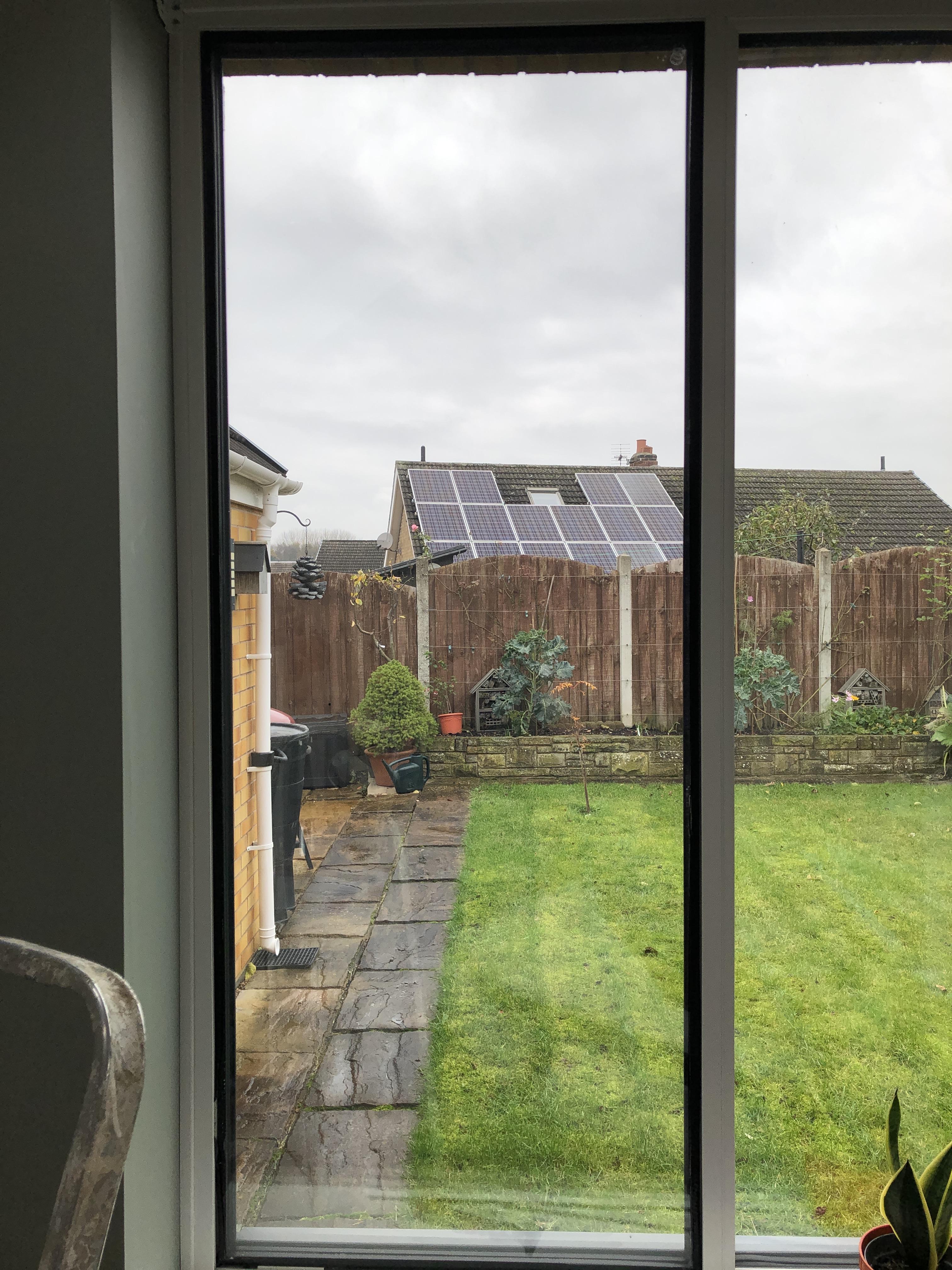

MikeGrahamT21 Posted November 13, 2023 Share Posted November 13, 2023 For a long time now i've known about Liniar's Glazing Flipper, basically a trim which attaches to the middle of the profile with a rubber flipper as the name suggests, which creates a barrier to the outer half (where the frame drainage holes are located) and the inner half, and always thought it was such a brilliant idea, since the drainage holes will allow air to move freely around the 5mm gap all around the glazing, bypassing all of that expensive triple glazing, and thats irrespective of whether the beading fits tightly or not...but of course with anything brilliant, you can never get hold of it. Then when i was looking for something else, joint backer rod (the stuff you use to fill a deep hole to stop you having to use so much caulk) popped up, and i thought now that would certainly do the job, as its flexible, waterproof, cheap and hopefully airtight when compressed (even if its not it should be far better than just an empty gap), so i've bought 10m of 10mm rod just to give it a go, and will report back if its made any difference. I'll put it on a window where i can do one pane and leave the other so its a reasonable comparison. 1 Link to comment Share on other sites More sharing options...

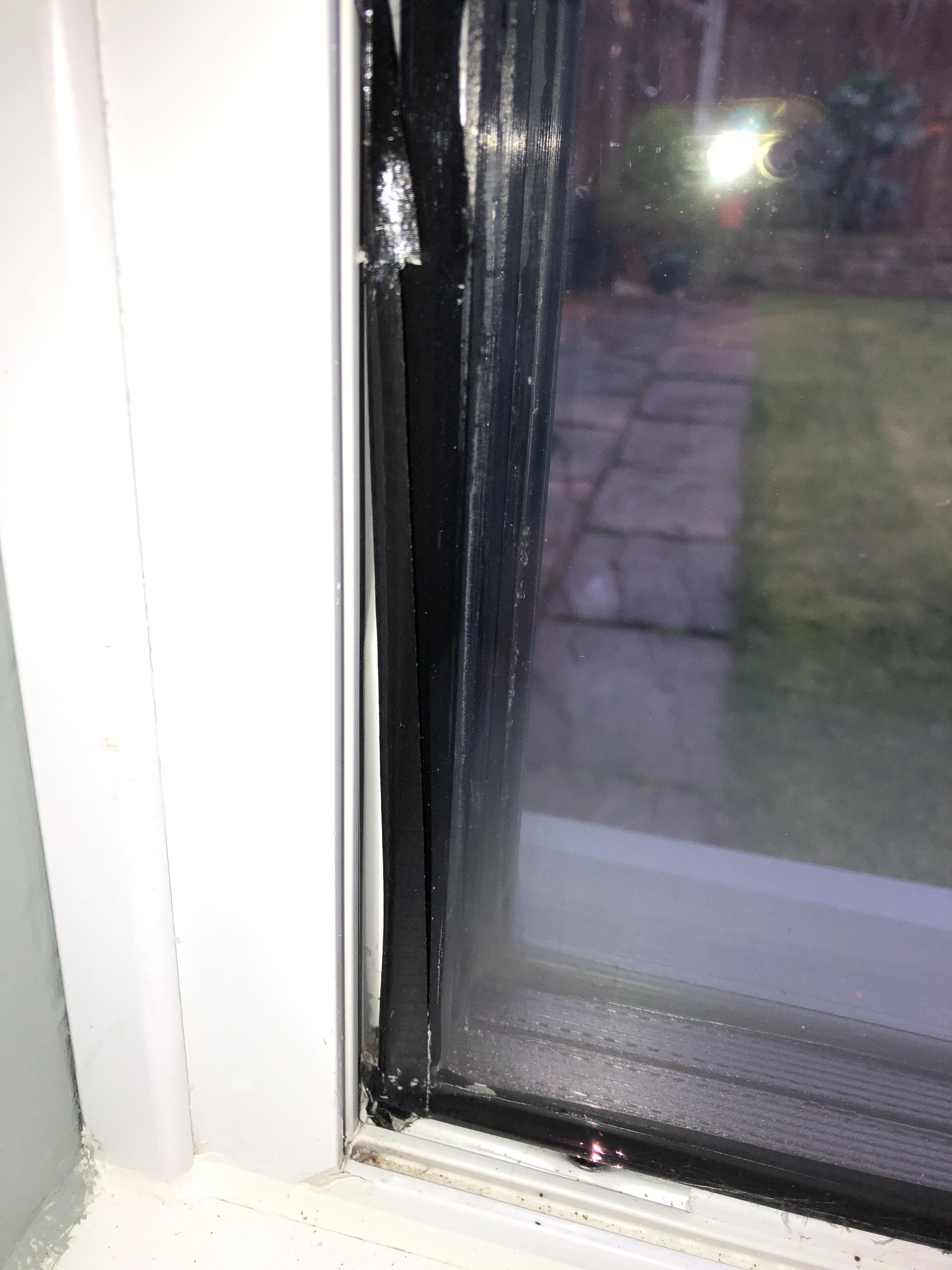

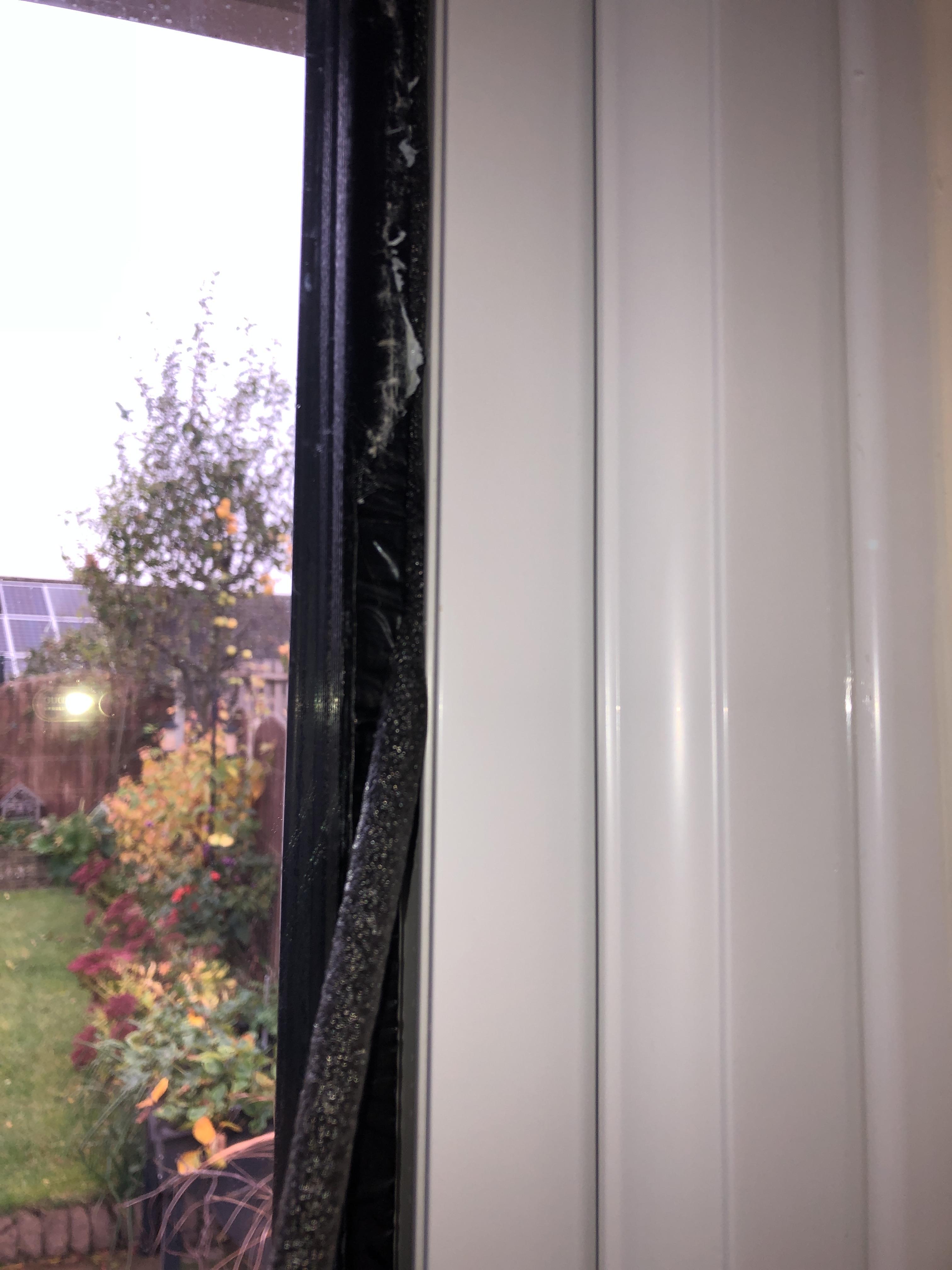

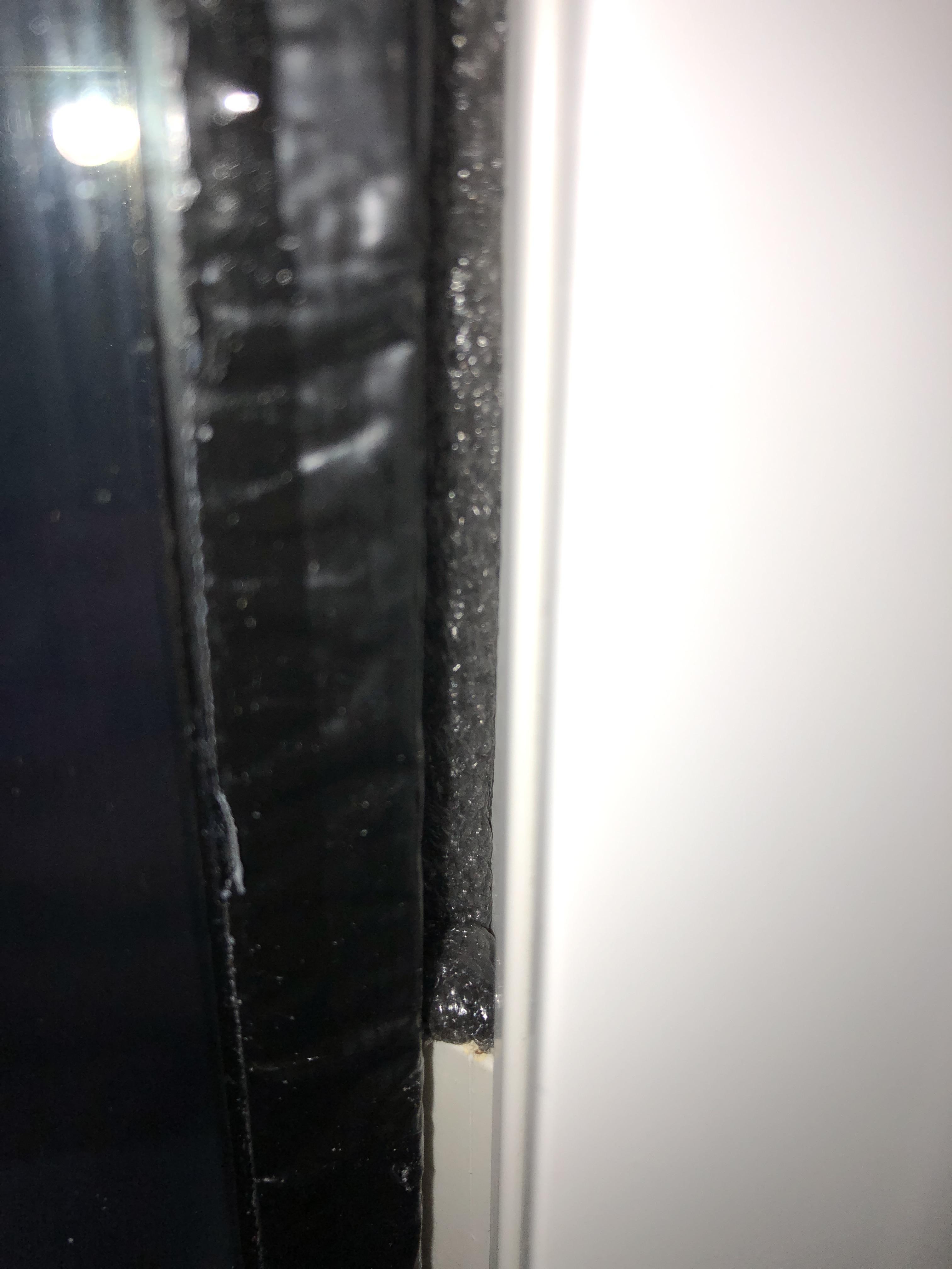

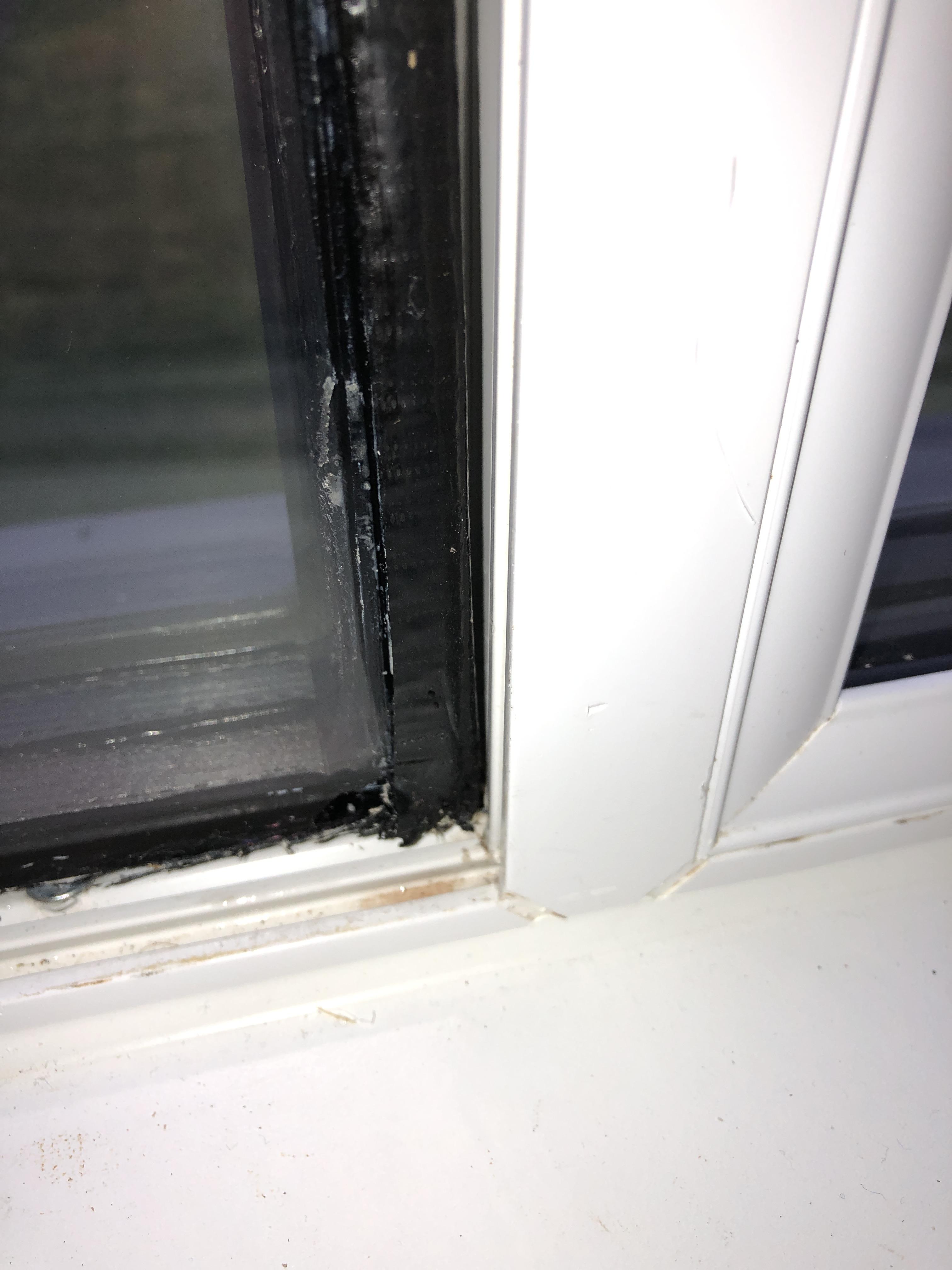

MikeGrahamT21 Posted November 16, 2023 Author Share Posted November 16, 2023 Arrived today so thought may as well get it in place on my afternoon off. Did one fixed pane on one window and one opener on another, fiddly as expected but not overly so, pushed the rod in to roughly where the centre pane of glass sits in the 3G unit beading’s off absolutely hate the duck tape they use when it’s perished, tidied it up best I could, you can see the gap clearly and I could feel the breeze coming through at this point. just used a filling knife to gently push it in all around the perimeter. I will report back with some results and before I buy any more rod 1 Link to comment Share on other sites More sharing options...
