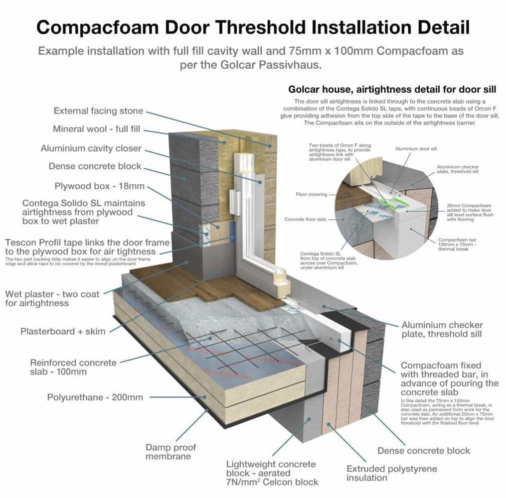

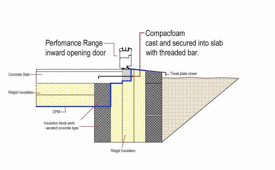

Compacfoam threshold detail - what's actually happening here?
These images appear on the Compacfoam page in the Green Building Store.
But this is not a detail that appears in Compacfoam's own literature and there seems to be little further explanation of the context, exactly what the compacfoam is doing or what types of situations it would be appropriate for.
Is the Compacfoam strip supposed to be bearing any substantial load here? And if it is, does it rely on cantilevering out from the concrete slab? Is it relying on the extrude polystyrene below it and if so what's that supported on?
What load does it need to bear anyway, seeing as all that is fixed into it is an aluminium threshold strip?
Is it just the weight of foot traffic at the threshold - and if so, the "checkerplate" "tread plate closer" seems to be deemed enough to span across the XPS insulation already so why not just use that?
Is it that the compacfoam is actually not doing anything other than replacing a bit of timber as formwork for the edge of the slab, and as something convenient to screw the threshold strip into?
When I first saw this detail I thought it might be something I'm always looking for; a way of supporting the weight of a heavy door or window in line with the insulation layer in a cavity wall buildup - but that's not what's happening here, right?
Screenshot2023-11-03at14_44_15.thumb.jpg.14204942d2542158563f5d7a4cb01fb4.jpgScreenshot2023-11-03at14_43_59.jpg.7a2e94148078806f5ce37c9bcbee2623.jpg

Compact foam replaces traditional concrete door blocks. I fixed mine on to the concrete slab with 150mm concrete screws. My DPC detail was a bit different, brought it up and OVER the CF block, rather than under it in that detail. On that detail the threaded bars in to the end of the slab transfer the loads.
Not sure I know what you need. I think it *is* supporting (or partly so) the door-set, but it gets its 'supportingness' from being bolted to the slab. I assume your circumstances are different. Can you confirm what you would need it to do as opposed to what it's doing here?
Let's say, conventional cavity wall buildup with rigid board insulation, suspended floor (either beam & block or timber) and I want to install a heavy sliding door system (which bears weight onto rollers at the bottom), but I want to try and install it in line with the cavity insulation (like you'd try and do with a normal window to ensure continuity of the insulation layer).

3 hours ago, Redbeard said:
Is that not exactly what is shown in GBS's dwg, or have I misread it?
All that is being supported by the compacfoam there is an aluminium threshold strip, and foot traffic, as far as I can see. But this is what's frustrating about that detail - it's not linked back to any information about what it's actually doing, or how to know what it can or can't support.
Are you assuming then that the 'cill' of the door is wholly 'hung' off the jambs? I had taken it as bearing on the CF, as per the larger dwg. I am assuming the pics shows a side-hung door in a frame but the annotation is a bit fuzzy (or my eyes are failing and I don't realise yet!)
