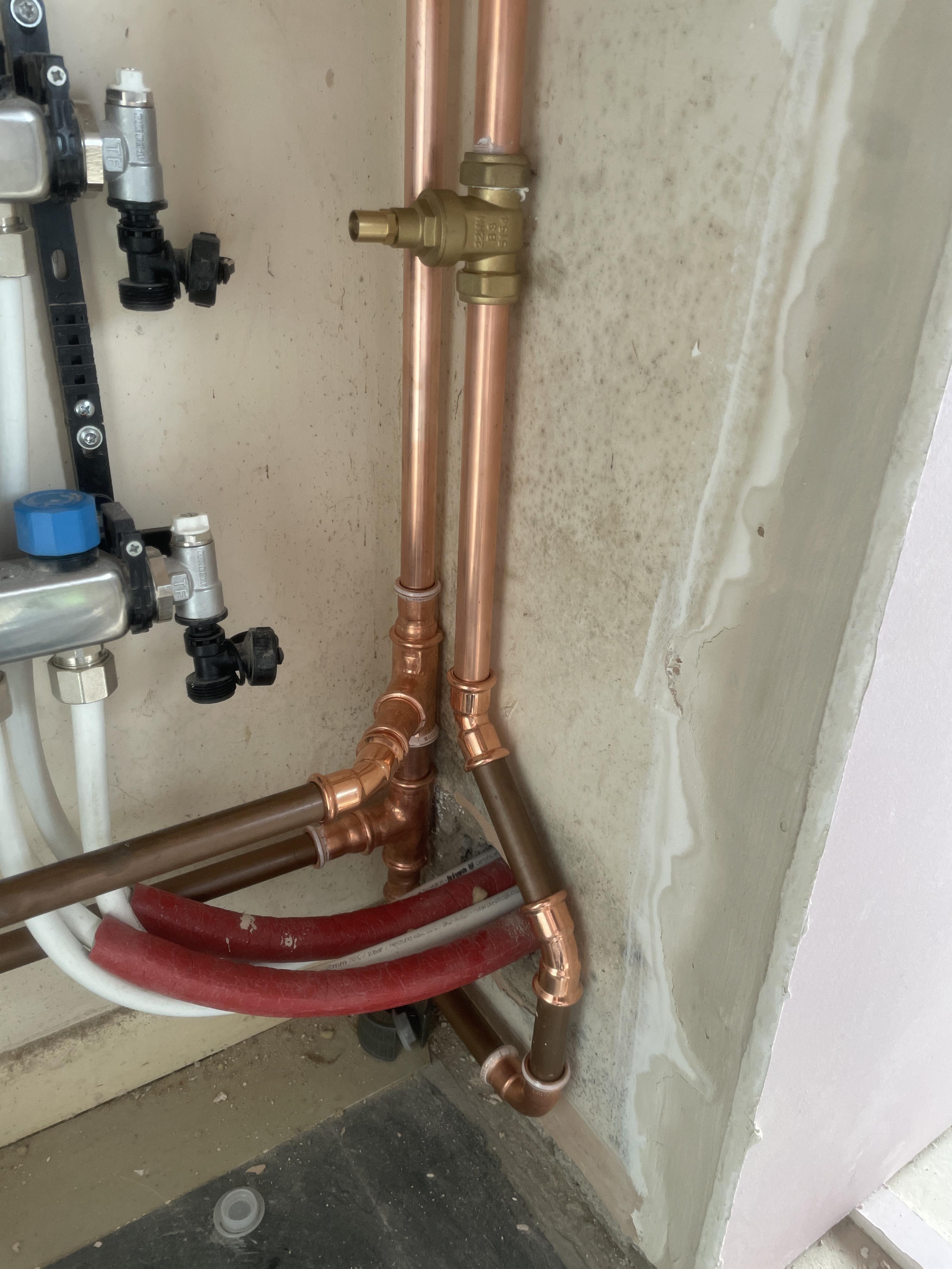

HughF Posted November 4, 2023 Author Posted November 4, 2023 Making some progress… hopefully this will work.
JohnMo Posted November 4, 2023 Posted November 4, 2023 Only thing I would have different is made the tees 28mm not 22mm. To get a step change in velocity at the tees.
HughF Posted November 4, 2023 Author Posted November 4, 2023 On 04/11/2023 at 09:06, JohnMo said: Only thing I would have different is made the tees 28mm not 22mm. To get a step change in velocity at the tees. Expand Consider it done…. Nothing pressed yet and I’ve got 28 Ts in the bucket.
HughF Posted November 4, 2023 Author Posted November 4, 2023 All pressed up…. Didn’t even need my angled jaws 🤣

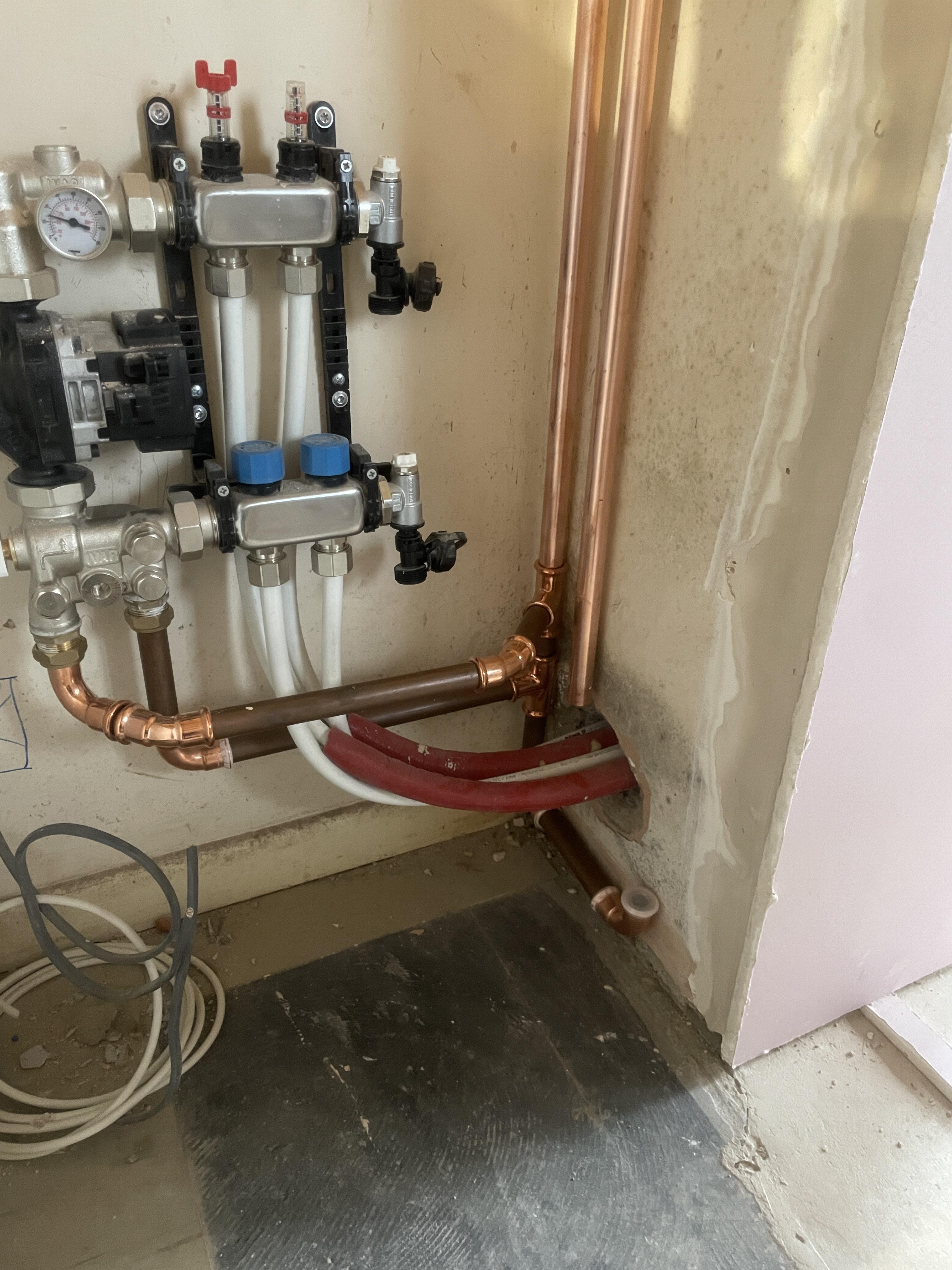

HughF Posted November 10, 2023 Author Posted November 10, 2023 Just put a plug into this and got it flowing…. It’s taking heat from the flow. But the loop temps aren’t coming up, is that normal? I’d have expected it to take as much flow as it can in order to satisfy the flow temperature, is that an incorrect expectation? The pipes into/out of the manifold are hot/cold…. And there is some warmth to the flow, but it’s not rising above 22.
HughF Posted November 10, 2023 Author Posted November 10, 2023 Well, it appears to be doing something…. Heat pump is happier now there is more of a sink for its energy to go.
JohnMo Posted November 10, 2023 Posted November 10, 2023 If it's the first time heating it will take quite some time to get heat back to the manifold. You are heating a few tonnes of concrete.
HughF Posted November 10, 2023 Author Posted November 10, 2023 On 10/11/2023 at 20:25, JohnMo said: If it's the first time heating it will take quite some time to get heat back to the manifold. You are heating a few tonnes of concrete. Expand Yep, I figured as much…. I think I had an incorrect assumption about how it blended the water, assuming that it would in fact feed water at the requested flow temp (I’ve set the dial to 33) until the return from the loop was at that temp. Instead it seems to be flowing quite cool. The heat must be going somewhere, the flow line is hot and the return from the manifold is cold.

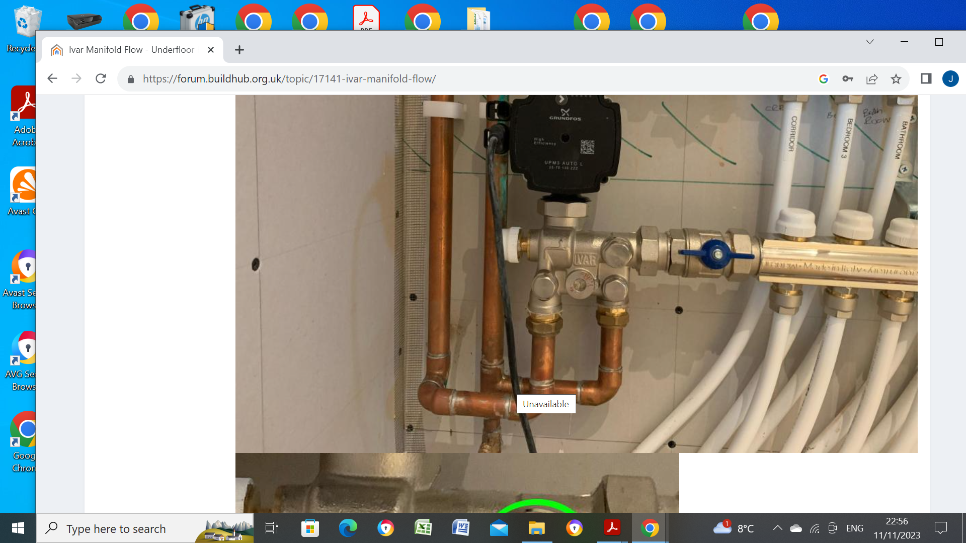

JohnMo Posted November 11, 2023 Posted November 11, 2023 On 10/11/2023 at 15:50, HughF said: But the loop temps aren’t coming up, is that normal? Expand Just seen you have an Ivar mixer, you need to adjust the mixer to suit your flow rates. They are very adjustable, if you didn't get instructions with the manifold you can normally download them.
HughF Posted November 11, 2023 Author Posted November 11, 2023 On 11/11/2023 at 08:18, JohnMo said: Just seen you have an Ivar mixer, you need to adjust the mixer to suit your flow rates. They are very adjustable, if you didn't get instructions with the manifold you can normally download them. Expand I’ll have a look and see what I can download. Some energy appears to be going into the floor, but I can’t get the flow temp into the loops above 26 ish.

John Carroll Posted November 11, 2023 Posted November 11, 2023 Have you tried turning up the mixing valve setting until you achieve 33C, it should react fairly rapidly.
HughF Posted November 11, 2023 Author Posted November 11, 2023 (edited) On 11/11/2023 at 16:02, John Carroll said: Have you tried turning up the mixing valve setting until you achieve 33C, it should react fairly rapidly. Expand that’s what I was expecting, it to respond quickly to a demanded flow temp when being fed with a considerably higher flow temp than the mixer was calling for. It seems completely disconnected from the flow temperature I see through the loop, which again is sitting at 27. Getting dT 3 between flow and return, and the floor is doing a nice job of keeping the extension warm, so I guess it’s working… it seems that no matter what I set the mixing valve to, it sits at 27. Edited November 11, 2023 by HughF

John Carroll Posted November 11, 2023 Posted November 11, 2023 (edited) On 11/11/2023 at 19:48, HughF said: that’s what I was expecting, it to respond quickly to a demanded flow temp when being fed with a considerably higher flow temp than the mixer was calling for. It seems completely disconnected from the flow temperature I see through the loop, which again is sitting at 27. Getting dT 3 between flow and return, and the floor is doing a nice job of keeping the extension warm, so I guess it’s working… it seems that no matter what I set the mixing valve to, it sits at 27. Expand If you are getting 3C dT then UFH output is ~1.1kw, have you a link to the mixing valve, it seems to have a adjustable bypass (if like the one below) there is only ~ 0.7LPM of hot water at 45C mixing with 4.3LPM of UFH return water at 23C so requires very tight control, you would require 1.0LPM mixing with 4.0LPM to get 33C mixed temperature. Edited November 11, 2023 by John Carroll
HughF Posted November 12, 2023 Author Posted November 12, 2023 I’ll post up the user manual when I’m in front of my laptop… the ivar mixer does indeed have two internal bypass’ both of which are adjustable. If it turns out I can heat the extension with only 27 degree flow then that’s all good, less losses all round. It would just be nice to have another pair of eyes looking over the manual with me. Appreciate everyone’s input on this.
