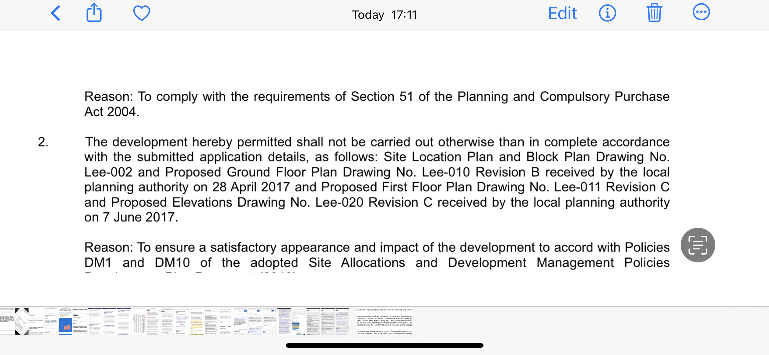

Loz100 Posted October 20, 2023 Author Share Posted October 20, 2023 They referenced this part of our planning acceptance saying that a room usage cannot be changed without planning approval ie gym to a study. Link to comment Share on other sites More sharing options...

kandgmitchell Posted October 23, 2023 Share Posted October 23, 2023 Frankly I would argue that Condition 2 fails at least two of the 6 tests that conditions have to satisfy to be valid, if used to control the gym. These tests are: Necessary, Relevant to planning, Relevant to the development to be permitted, Enforceable, Precise, and , Reasonable in all other respects. Is control of the use of the rooms within a dwelling "necessary" and is it "enforceable"? Why would it matter in planning terms if the gym space was used as an art room, a yoga space, a store room or a spare bedroom? Equally how would the planning authority find out what the space was used for and enforce the condition? Clearly the condition is unnecessary and unenforceable when used to control the internal use of rooms. For the planners to suggest they will not consider room uses because they have been "fixed" by the condition is stretching things just a bit too far... Furthermore, Section 55 of the Town and Country Planning Act makes it quite clear that works affecting the interior of a building do not constitute development for the purposes of the Act. That condition cannot be used to prevent future internal alterations especially if not relevant to the original approval. However, AliG sums up the situation for you in their last post. That gym window was always at risk being so close to the boundary and the upper rooms have double aspect windows. It may be a lost cause I'm afraid. 3 Link to comment Share on other sites More sharing options...
