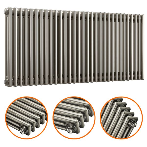

MikeGrahamT21 Posted October 19, 2023 Share Posted October 19, 2023 43 minutes ago, Super_Paulie said: its a 2m horizontal cast iron "style" rad in raw metal with triple columns, much like in the attached image. The part of the house its going in is the extension which is still at bare block and is insulated correctly to the best of my knowledge. At this stage im looking to keep the place as insulated as possible and i want to bring the rad circuit online now its getting colder and then i can work on my UFH over the winter, thats all ready to go bar laying the pipes. The rads are more to be eye candy as the UFH will do the bulk of the work. It seemed a no-brainer to use insulated board behind the rad as id only lose 40mm and the added bonus that it would push out the rad so the tails do not foul on the joist that is close to the wall. The wall is external and north facing, its always baltic in that part of the house even in summer. is this an extension you have built on with building regulations? If so depending on the width of the cavity you will require some internal wall insulation in order to get it passed as 100mm of any type of insulation in a cavity won’t cut it these days. Make sure all of the external walls if there are more than one are all done the same, which again you’d have to do for BR. Link to comment Share on other sites More sharing options...
