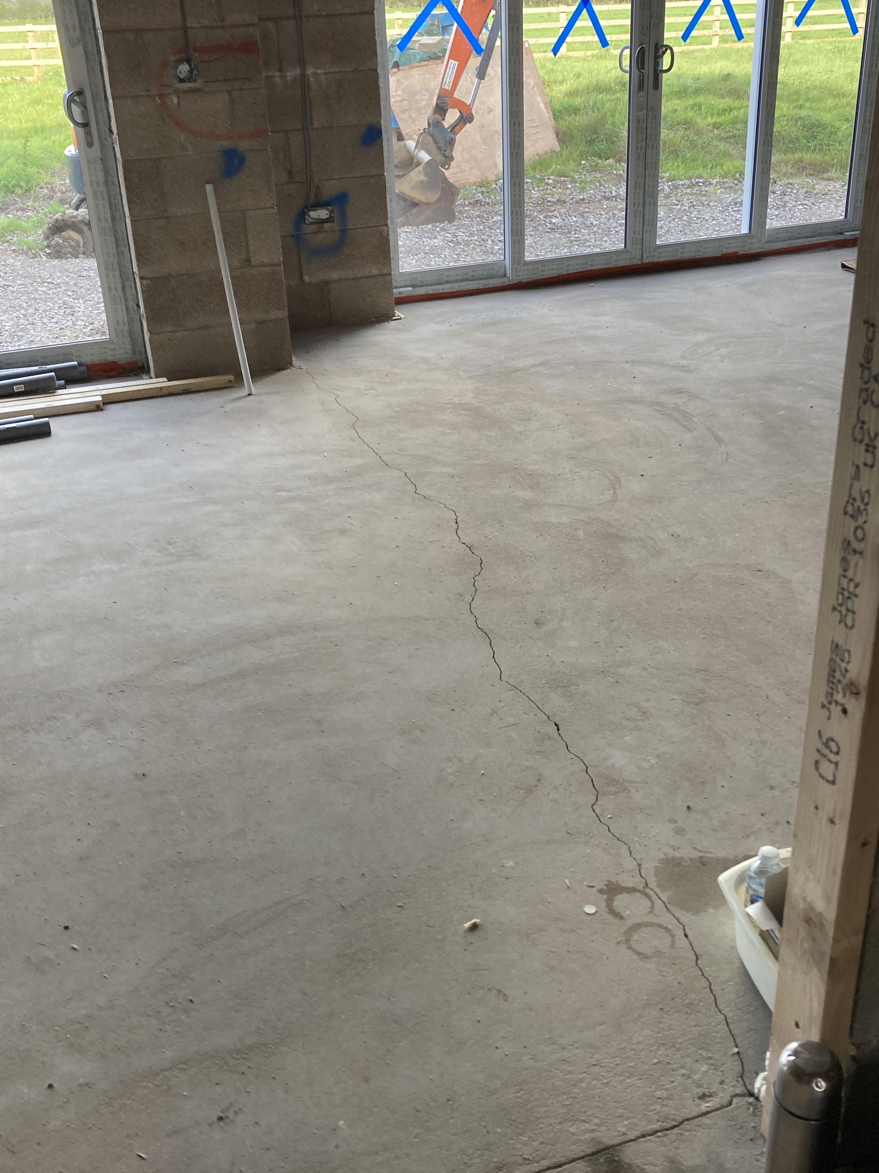

nod Posted October 14, 2023 Share Posted October 14, 2023 49 minutes ago, MR10 said: Can you explain why it's not needed for liquid screed? I'm just trying to understand a bit more as we have just had our screed poured (cemfloor) and with every penny a prisoner I don't want to spend money on Ditra if it's not needed. You get hardly any movement on a flow screed I screeded the one pictured myself with 35 tons of readymix But still have movement cracks As a tiling business flo screed is a god send Hardy any prep work and a week drying time prior to tiles 2 1 Link to comment Share on other sites More sharing options...
