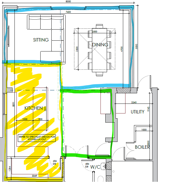

dave2612 Posted October 10, 2023 Share Posted October 10, 2023 I would appreciate some advice about the best way to install UFH for our extension and existing area. The areas marked on the picture are as follows… Yellow – existing timber floor with approx. 1.2m void Green – existing solid concrete floor Blue – new extension I assume the extension and existing concrete floor will be simple enough, though I’m assuming the concrete will have to be dug out to a certain depth. With regards to the yellow section, I think I have 2 options, backfill the void or batten and insulate running the pipes along the existing joists? Bearing in mind that the yellow section will have a kitchen and large island on it which won’t require the pipes to be run under. Or - we make things easy and get an overlay system like NuHeat LoProMax so we can have a single zone instead of two zones which we would have to have if we used the 2 different methods of UFH mentioned above? Thanks in advance for any advice! Link to comment Share on other sites More sharing options...
JohnMo Posted October 10, 2023 Share Posted October 10, 2023 Main thing I can think of is make sure the loops are confined to a different floor buildup. So kitchen has loops that stay in the kitchen and don't overlap into green or blue area. Reason, the heating properties will be different, so you can fine tune each area with adjusting the flow to those loops. The other thing is insulation - more is better, you need a finished U value of 0.15 or better. If not running costs will be high and you would be better sticking with radiators, if you want something smaller than a normal radiator fan assisted are pretty small with a good output. 1 Link to comment Share on other sites More sharing options...

dave2612 Posted October 10, 2023 Author Share Posted October 10, 2023 6 hours ago, JohnMo said: Main thing I can think of is make sure the loops are confined to a different floor buildup. So kitchen has loops that stay in the kitchen and don't overlap into green or blue area. Reason, the heating properties will be different, so you can fine tune each area with adjusting the flow to those loops. The other thing is insulation - more is better, you need a finished U value of 0.15 or better. If not running costs will be high and you would be better sticking with radiators, if you want something smaller than a normal radiator fan assisted are pretty small with a good output. Thanks John, the area is all open plan, so are you suggesting that different zones will be better ? With regards to the insulation it's not a problem insulating the wooden floor or the extension, what might be an issue is the concrete floor, we'd have to dig the existing floor out to do this. Nu Heat reckon with the overlay system it's doesnt need the insulation? Thanks! Dave Link to comment Share on other sites More sharing options...

JohnMo Posted October 10, 2023 Share Posted October 10, 2023 3 minutes ago, dave2612 said: so are you suggesting that different zones will be better Not really, just that you have separate loops confined to each area. Not much a fan of zones. 4 minutes ago, dave2612 said: Nu Heat reckon with the overlay system it's doesnt need the insulation? That's them wanting to sell product, not what's correct for your wallet. Physics doesn't change, conduction heat flow will always try to move from a warm area to one at lower temperature. So unless you restrict that with insulation, the heat will flow downwards more than upwards. The issue is with different U values, due to different amounts of heat flow downwards, you can need very different flow temperatures to heat the different areas to similar temperatures. 1 Link to comment Share on other sites More sharing options...
dave2612 Posted October 10, 2023 Author Share Posted October 10, 2023 33 minutes ago, JohnMo said: Not really, just that you have separate loops confined to each area. Not much a fan of zones. That's them wanting to sell product, not what's correct for your wallet. Physics doesn't change, conduction heat flow will always try to move from a warm area to one at lower temperature. So unless you restrict that with insulation, the heat will flow downwards more than upwards. The issue is with different U values, due to different amounts of heat flow downwards, you can need very different flow temperatures to heat the different areas to similar temperatures. Thanks again John. So the issue is probably going to be the concrete floor and having to get it all dug out to get some insulation in. Link to comment Share on other sites More sharing options...
dave2612 Posted October 13, 2023 Author Share Posted October 13, 2023 What if we keep 'proper' UFH for the extension (blue area) and put a radiator in the green area, most of the floor will be covered by kitchen in the yellow area, so maybe we just insulate that really well under the existing floor? As the finished floor would be either vinyl or laminate a warm floor doesn't matter too much for us. Link to comment Share on other sites More sharing options...

dave2612 Posted October 14, 2023 Author Share Posted October 14, 2023 Sounds like the option of just installing UFH in the new extension would be the simplest. Another thought would be that as we want Aircon in the room anyway we could just use the Aircon to heat the room as well? Not sure how much this would cost to run Vs ufh? Link to comment Share on other sites More sharing options...
