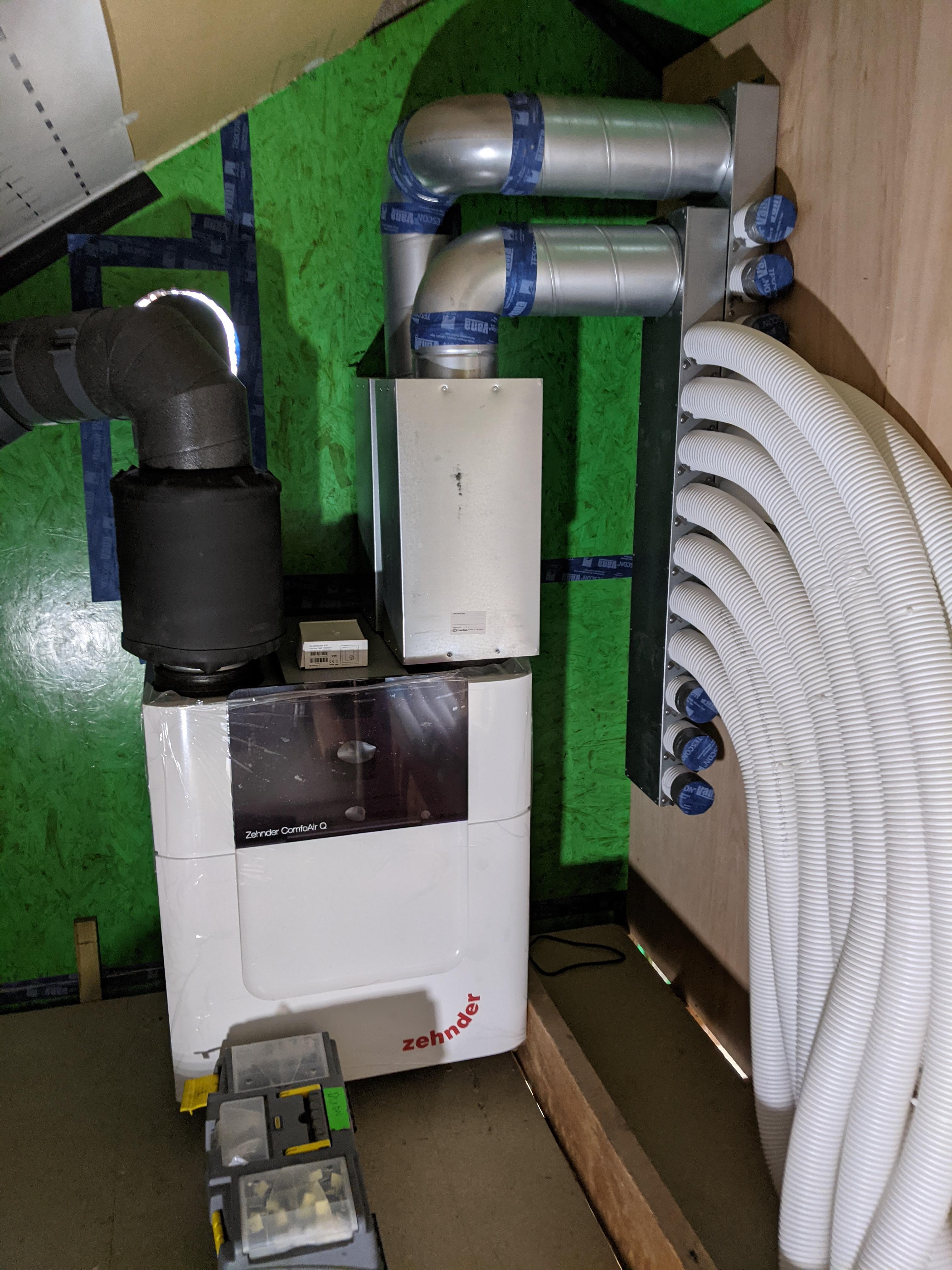

Possibly something like this?
If you get room diffuser plenums with a side entry port, the pipe comes out horizontally so can run between joists under the loft board and come up in a more convenient location

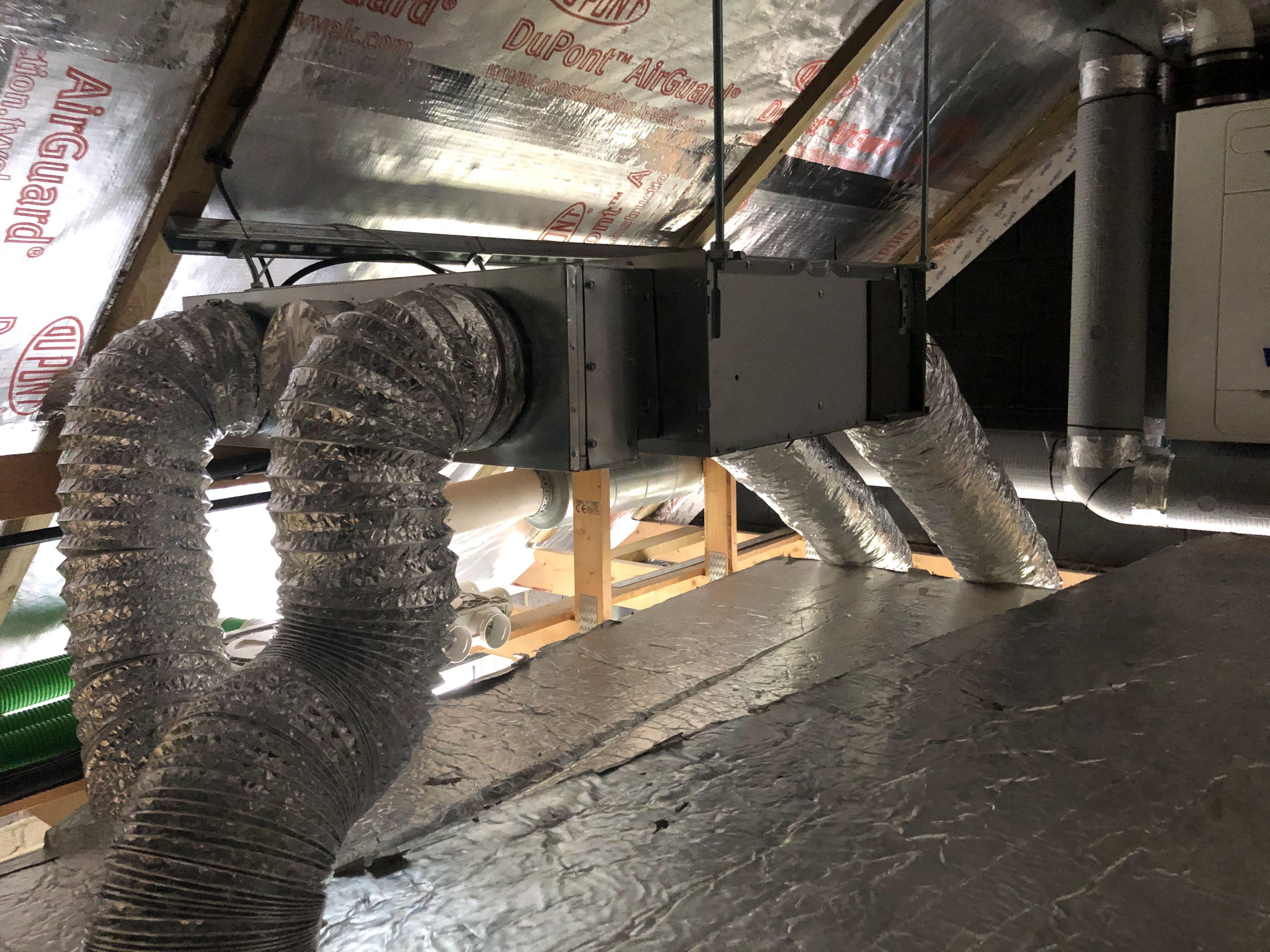

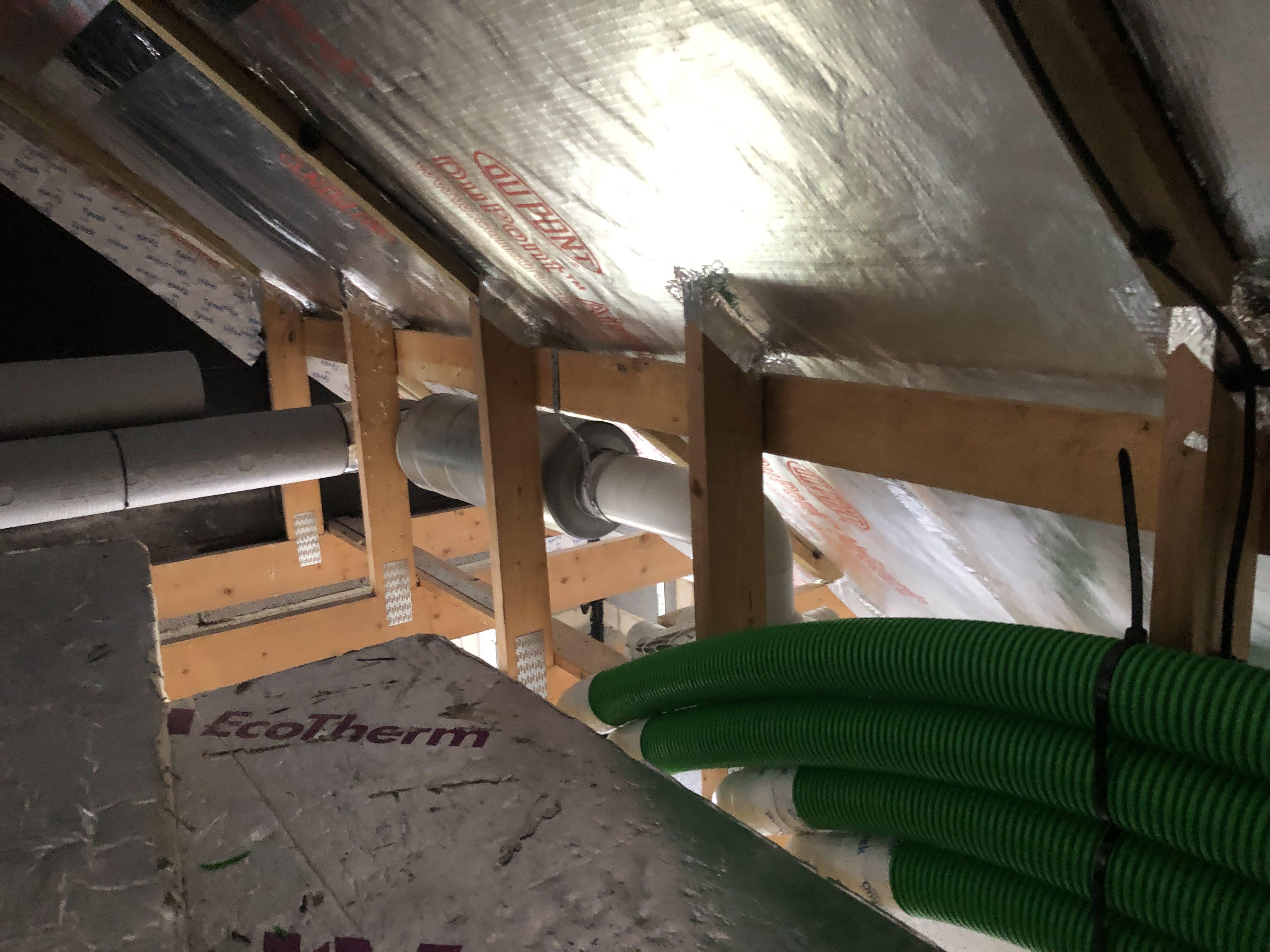

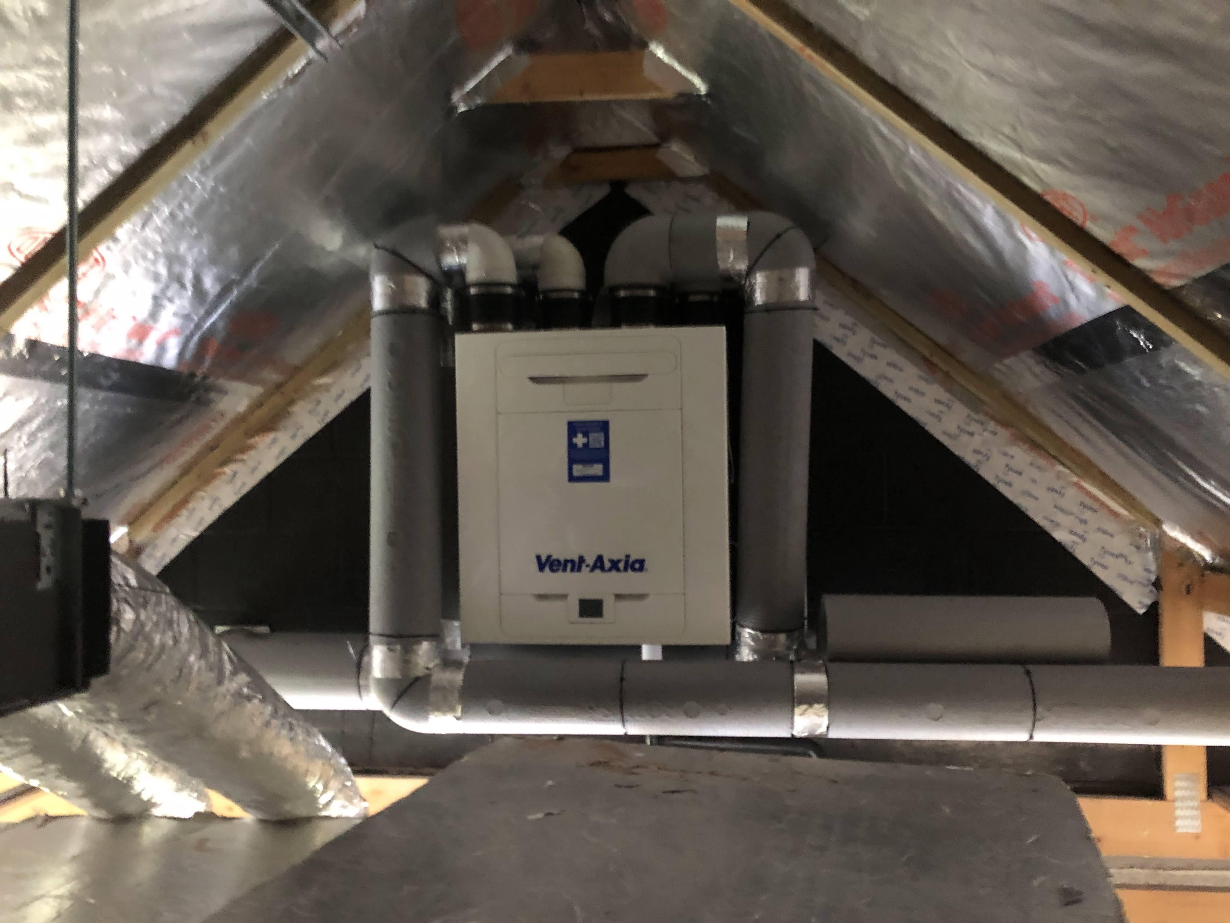

This might be of use.  I used plastic pipe for what it's worth.  Plenums mounted to either side of the attic out the way!  Strap banding used to hold/support the attenuators, last photo you'll have to look past the AC unit!

Nice, that'd work quite well. What size attenuators are those, no problem with sound transfer? I was thinking 600mm for supply and 300mm for extract (for rooms where noise transfer is less of a concern) How did you secure the distribution boxes to the wall like that?
Awesome, thanks. Any problems with the tight bends? I was thinking of using 2x 45 degree bends, or a long sweeping 90. More out of caution than any solid reasoning!
Those attenuators are 600's,
used 90's as that's what I could get at the time of install, if I could get a nice sweeping bends then I'd probably spend a morning and reconfigure it tbh, it's not commissioned yet so cant really answer if those have caused too much pressure drop at the normal running setting.
