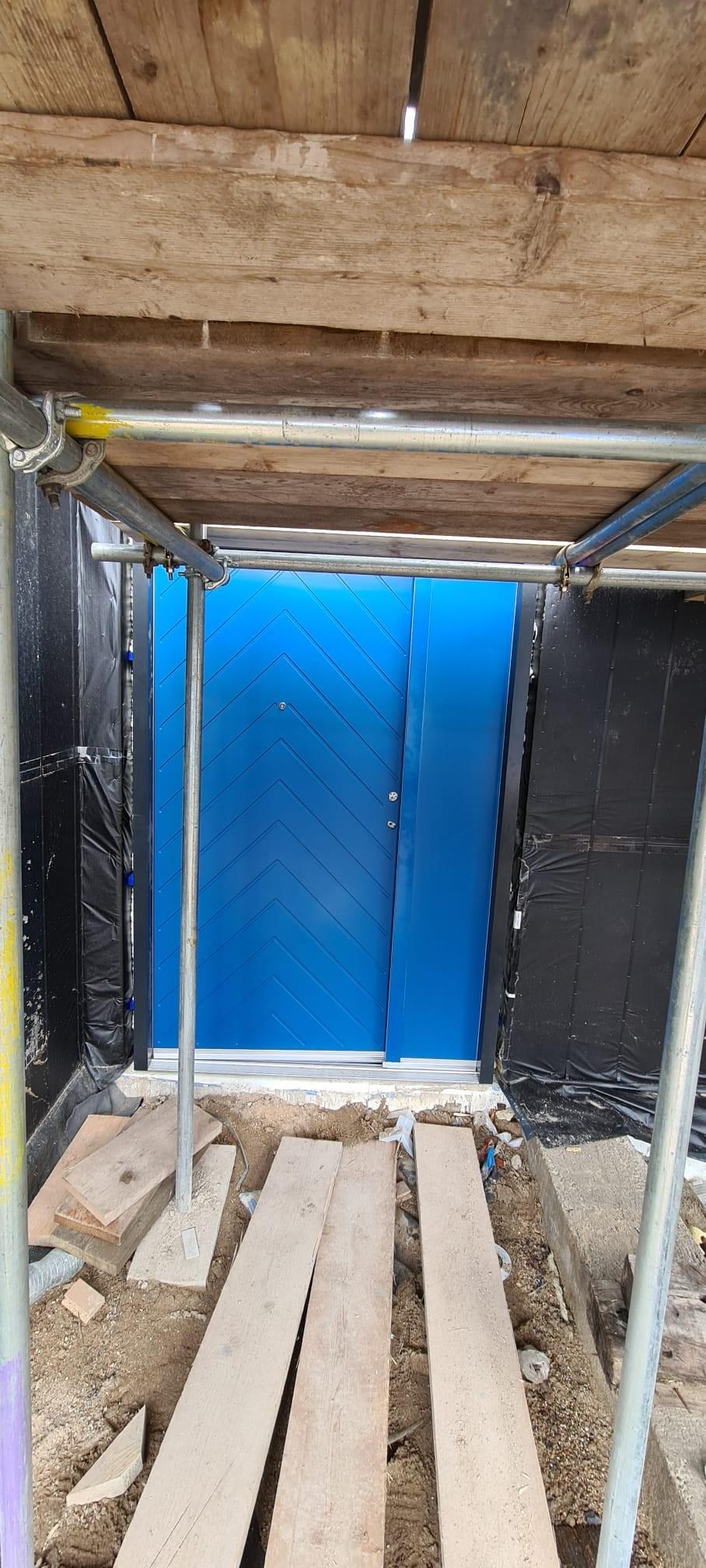

deancatherine09 Posted October 4, 2023 Share Posted October 4, 2023 We've got a Velfac door which is beautiful, good U value (and was a reasonable price too!) but maybe too modern for you? This is ours, but they do other styles Link to comment Share on other sites More sharing options...
