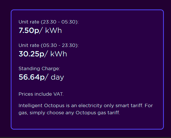

We have a 8Kwh Mitsubishi Ecodan HP and 12Kwh of Solar on the roof.  Plan in the next 6 months would be to add a battery storage solution once we have some figures on how much we are actually generating/using/selling.  Also no Electric car yet but looking to buy one in Jan 2024.
I am currently with EDF of an out of contract plan so need to switch soon.  Looking online and octopus seem to be the only ones I can find that have plans for ASHP or Solar.  Is there anyone else that offers plans if you have both?

In summer you won't be using the ASHP much so it's likely you'll have lots of spare electricity to export so you need a good export rate.  In winter the ASHP will gobble up any solar power you generate, probably without making much of a dent on what you import.  So you need a tariff that gives you a low import price for most or all of the day because an ASHP typically runs for long hours.  Good luck with that, cheap imports and a good price for your exports, the two rarely go together.
AFAICS if you have an EV  you can combine these two tariffs Octopus Intelligent (which is a better bet than their HP tariff Cosy if you don't need the afternoon boost)
with their export rate Octopus Outgoiing which pays 15p/unit for exports and will even allow you to arbitrage between the two using your battery. Check the actual rates for your particular postcode though.
