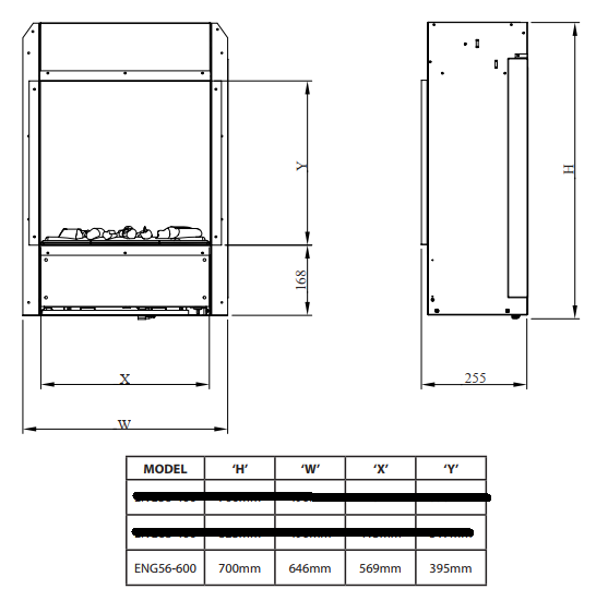

- The fire is fake, an opti-myst device (effectively a 'lamp')

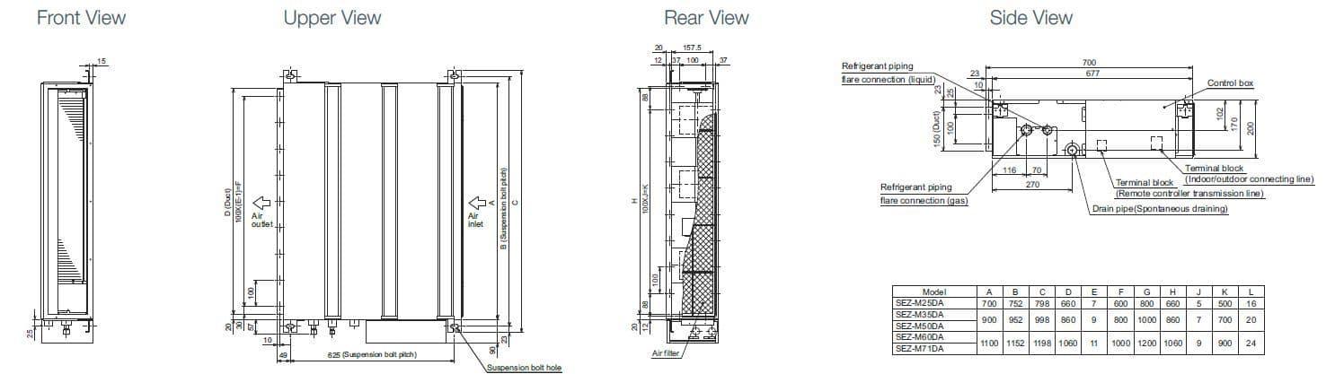

- The fireplace actually houses a R32 Fan Coil Unit to cool the room

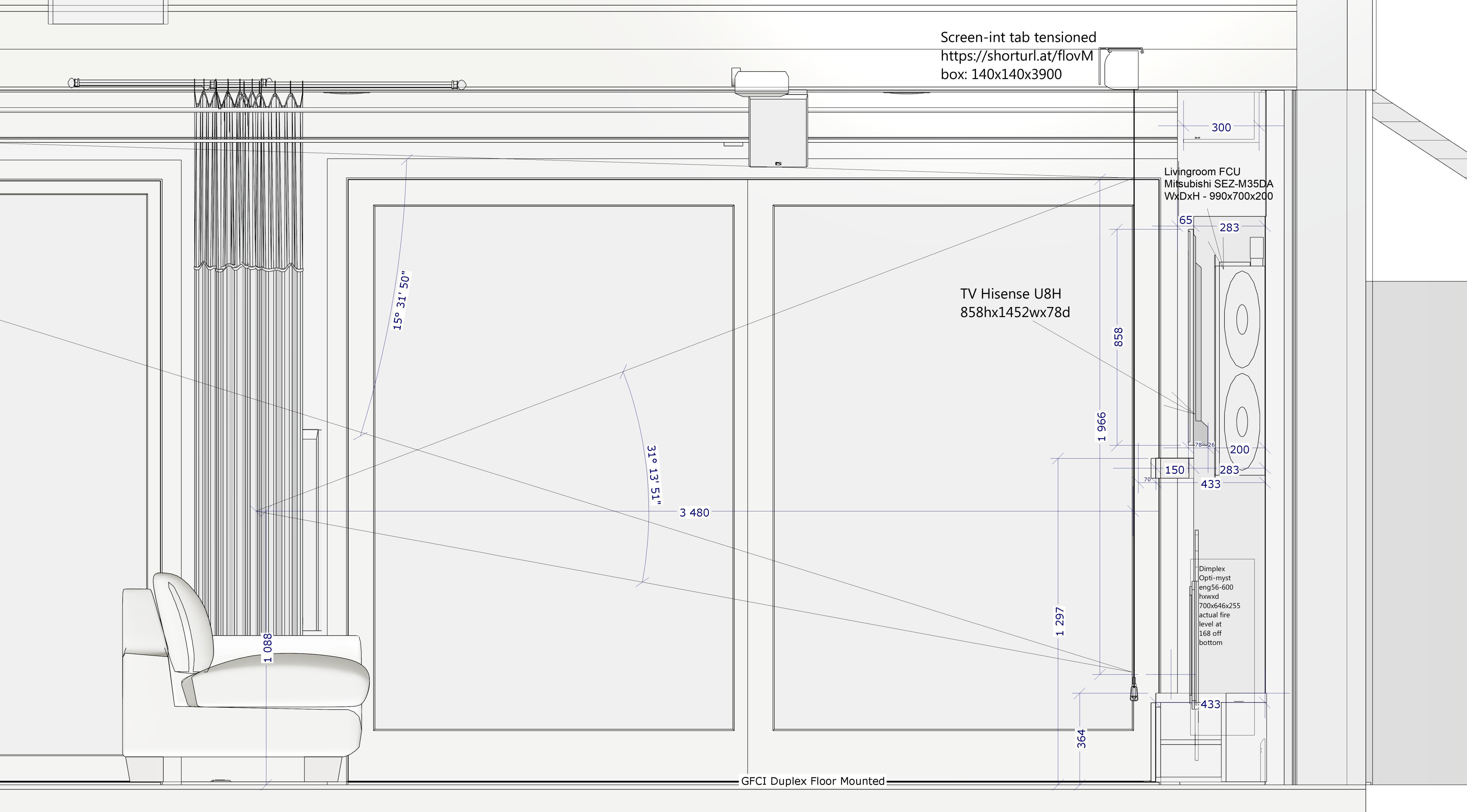

Maybe this side view pictures it better:
Currently it's designed with very little tolerances, the TV stacked up against the fan coil unit.
Big question:
How would you allow access to the FCU.
Our main idea is to have allow the entire black back panel to be removable. Not quite sure how to safely secure it in place for 'normal operation' but some type of latch system that's when undone will allow the panel+tv+mantle and possibly ..+fireplace to come forward and out?
Has anyone ever seen such a design? Any suggestions on what works and what doesn't?

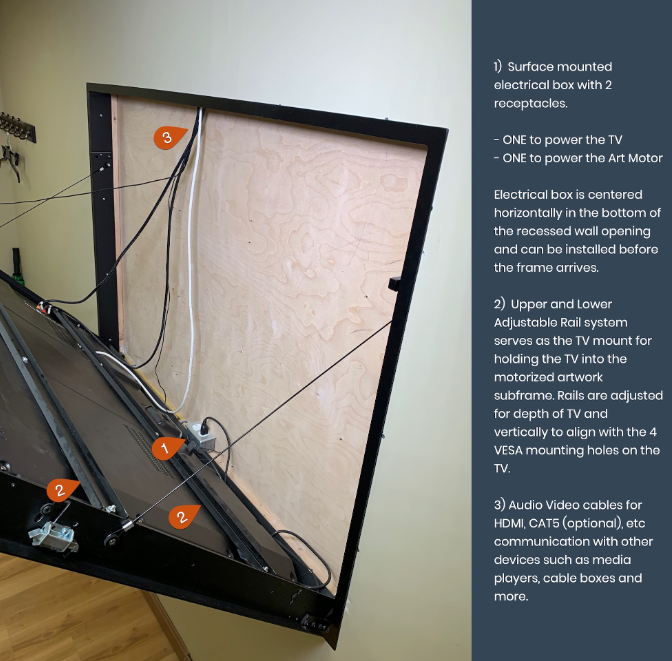

This seems mildly interesting:
https://help.framemytv.com/tv-art-covers/tv-art-installation/integrated-mount-system-for-recessed-tvs
