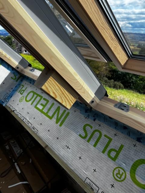

Kelvin Posted August 30, 2023 Share Posted August 30, 2023 (edited) We have two sets of large double Velux rooflights so mounted side by side. This creates bit of complication with every aspect of fitting them including insulating around the frames and airtightness detailing. I’ve dealt with all of that and have now started to look at how to finish the centre. Velux have two ways of doing this. One uses a centre trimmer post which is quite bulky and the other uses a flat trimmer kit which is neater but only comes in white whereas our windows are clear coated. I managed to secure the last two clear coated trimmers posts in the country (I think as you can only get them in white now) however they are very bulky looking. Therefore the options are fit the bulky but matching centre posts I have or fit the neater trimmers and accept they don’t match. I can’t make my mind up which looks best. The first pic shows an off cut of the post in situ. Edited August 30, 2023 by Kelvin Link to comment Share on other sites More sharing options...
Johnnyt Posted August 30, 2023 Share Posted August 30, 2023 I’ve pm’d some photos, we went full width and although bulky it was well insulated and we’re happy. Link to comment Share on other sites More sharing options...
