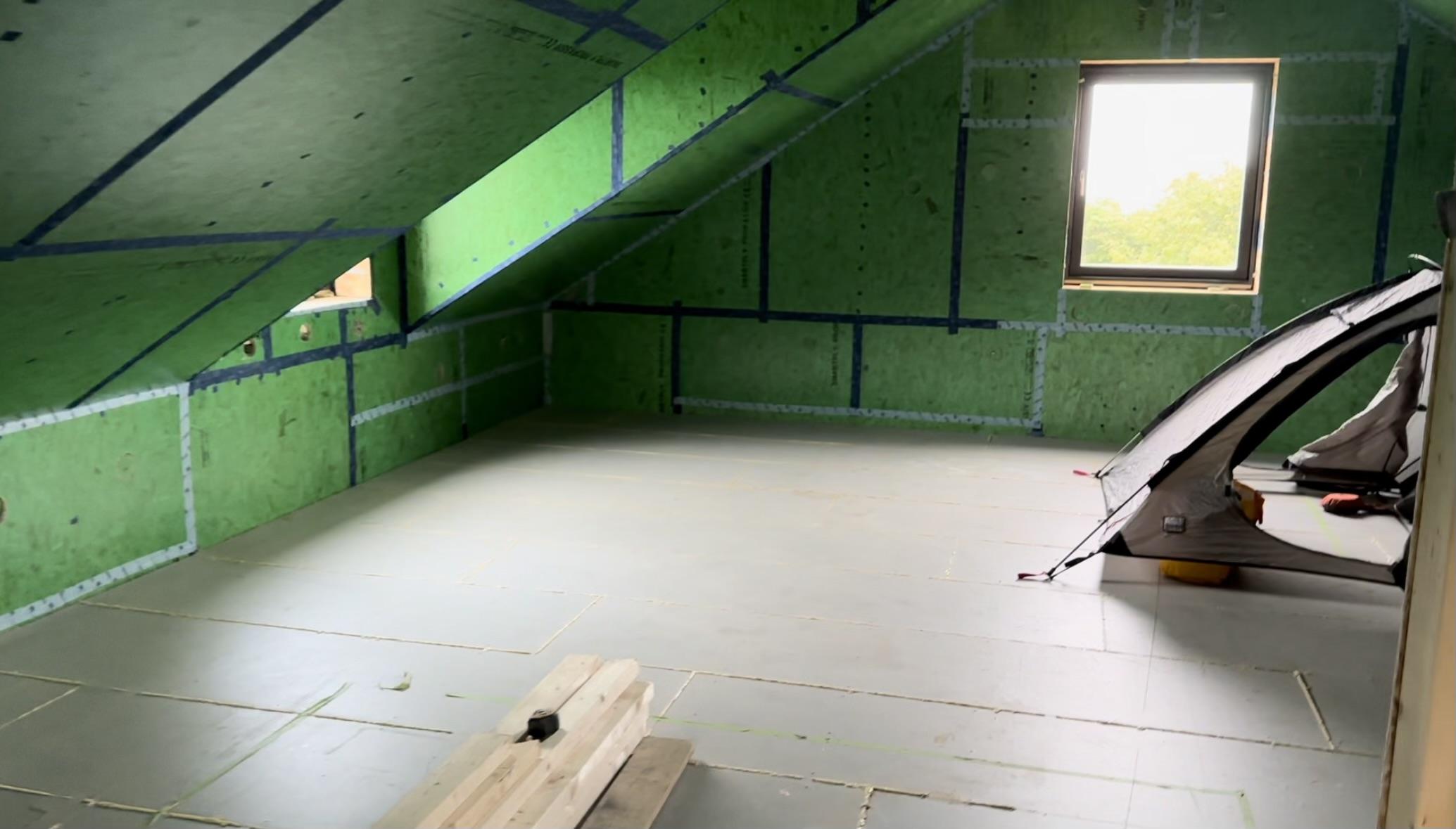

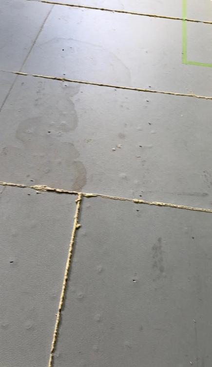

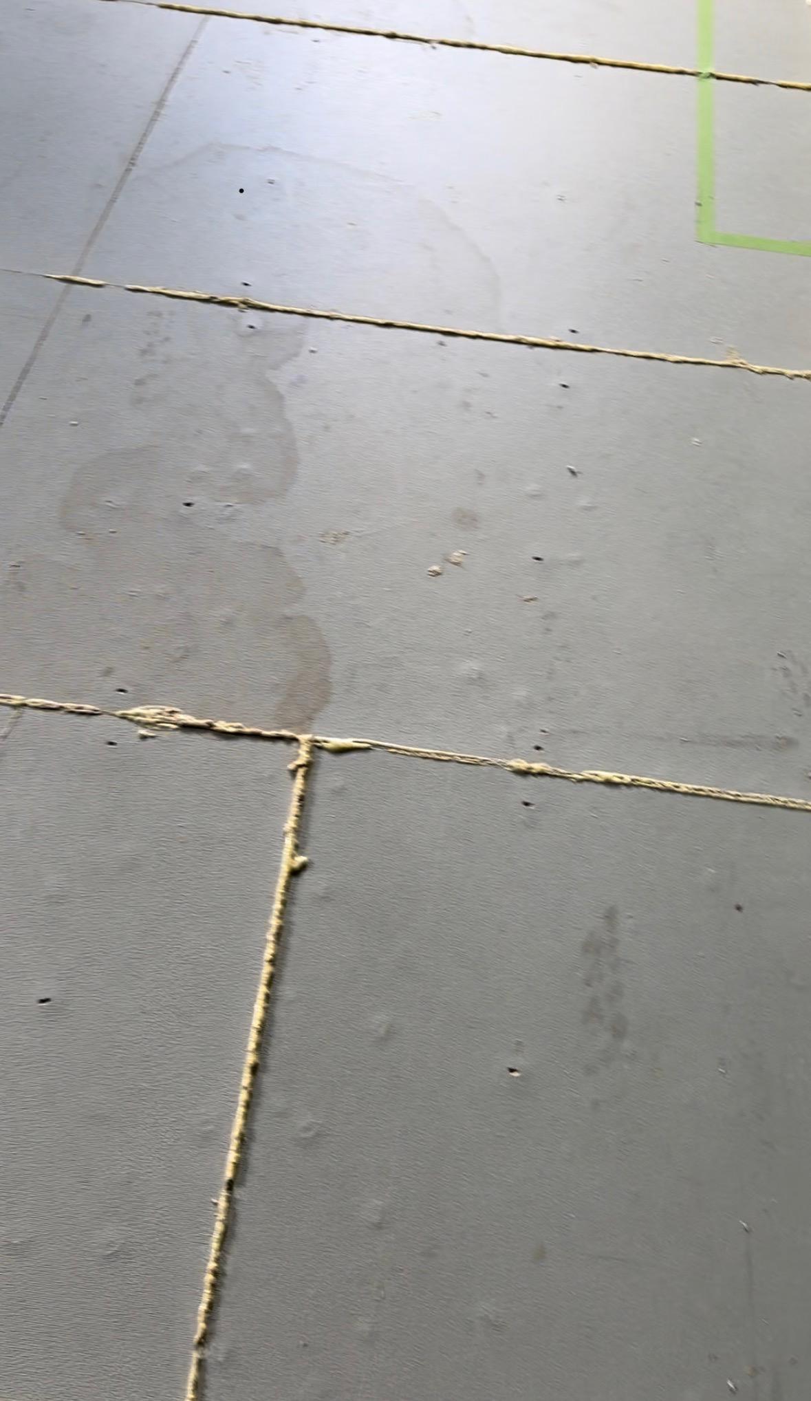

Our builders stuck down flooring on the first and top floors with plenty of adhesive. So much so that we now have adhesive ridges sticking up between the boards, and piles of it both on the ground floor and in my wheelbarrow 🤦‍♀️
Should we expect the builder to remove the excess, and if not, what is the best way to remove it?
It's good to see that it was put down with plenty of glue. Will clean up using a wide chisel. It will take you about an hour a room. If you are watertight it might be worth asking your builder if he is planning on doing it.
Sharp putty knife or wallpaper scraper and it will peel off as fast as you can crawl
