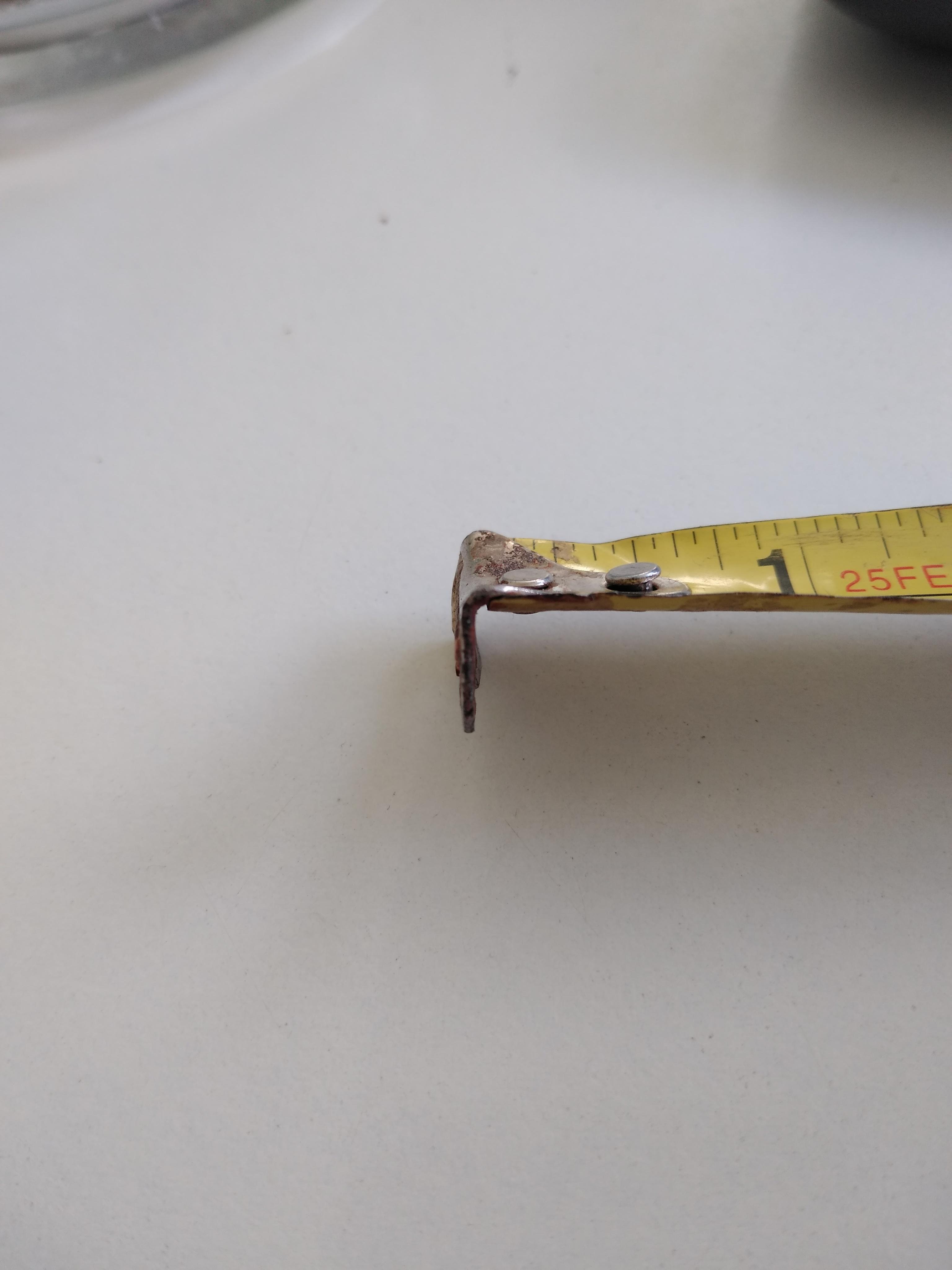

SteamyTea Posted August 15, 2023 Share Posted August 15, 2023 51 minutes ago, Big Jimbo said: . It is madness, you can't have an escape higher than 1100mm That is fair enough, but if any of your openings are lower than 1100mm you have to have guarding See this bit at the end of the tape measure, bend it. Should get a 5mm variation then. 1 Link to comment Share on other sites More sharing options...
Big Jimbo Posted August 15, 2023 Author Share Posted August 15, 2023 @SteamyTea you, my friend, are not making anything precision with that tape measure. Link to comment Share on other sites More sharing options...
SteamyTea Posted August 15, 2023 Share Posted August 15, 2023 Just now, Big Jimbo said: @SteamyTea you, my friend, are not making anything precision with that tape measure. No, but I could if I wanted to. I don't even know where I got the tape from, seems to be one that just appeared one day. I have a posh Stanley one, and a calibrated engineers rule. It was calibrated in 1979, should still be good. 1 Link to comment Share on other sites More sharing options...
