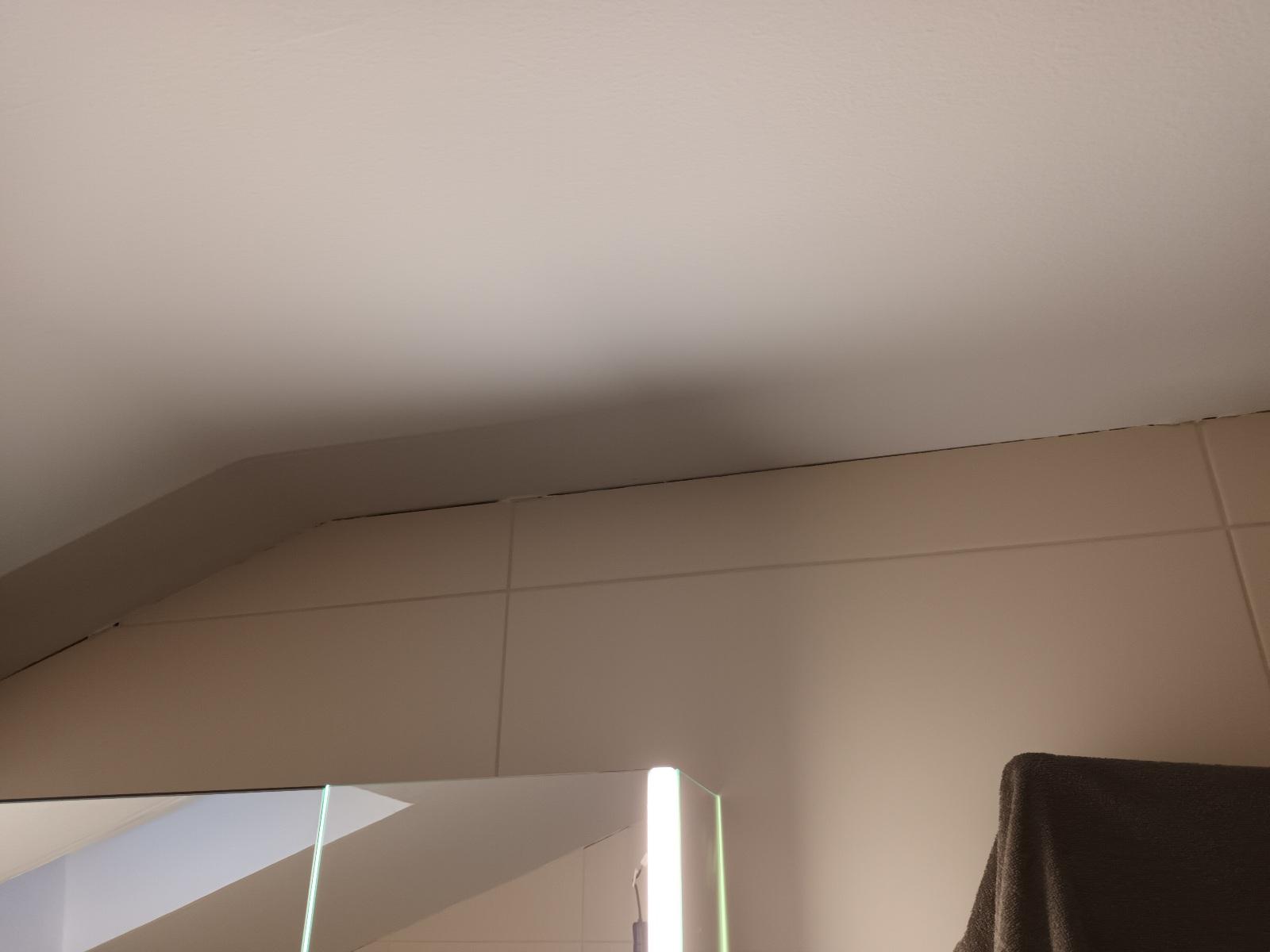

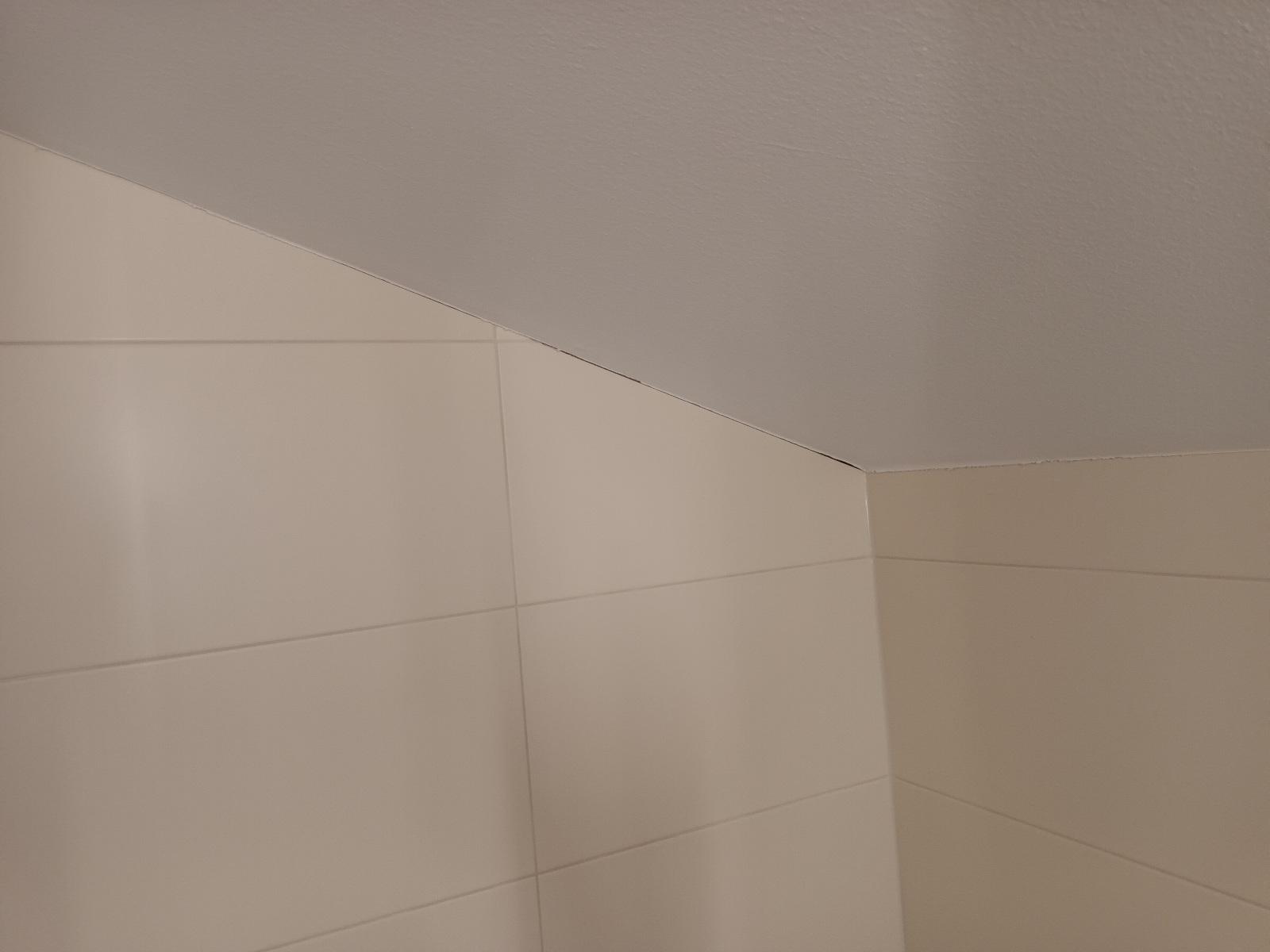

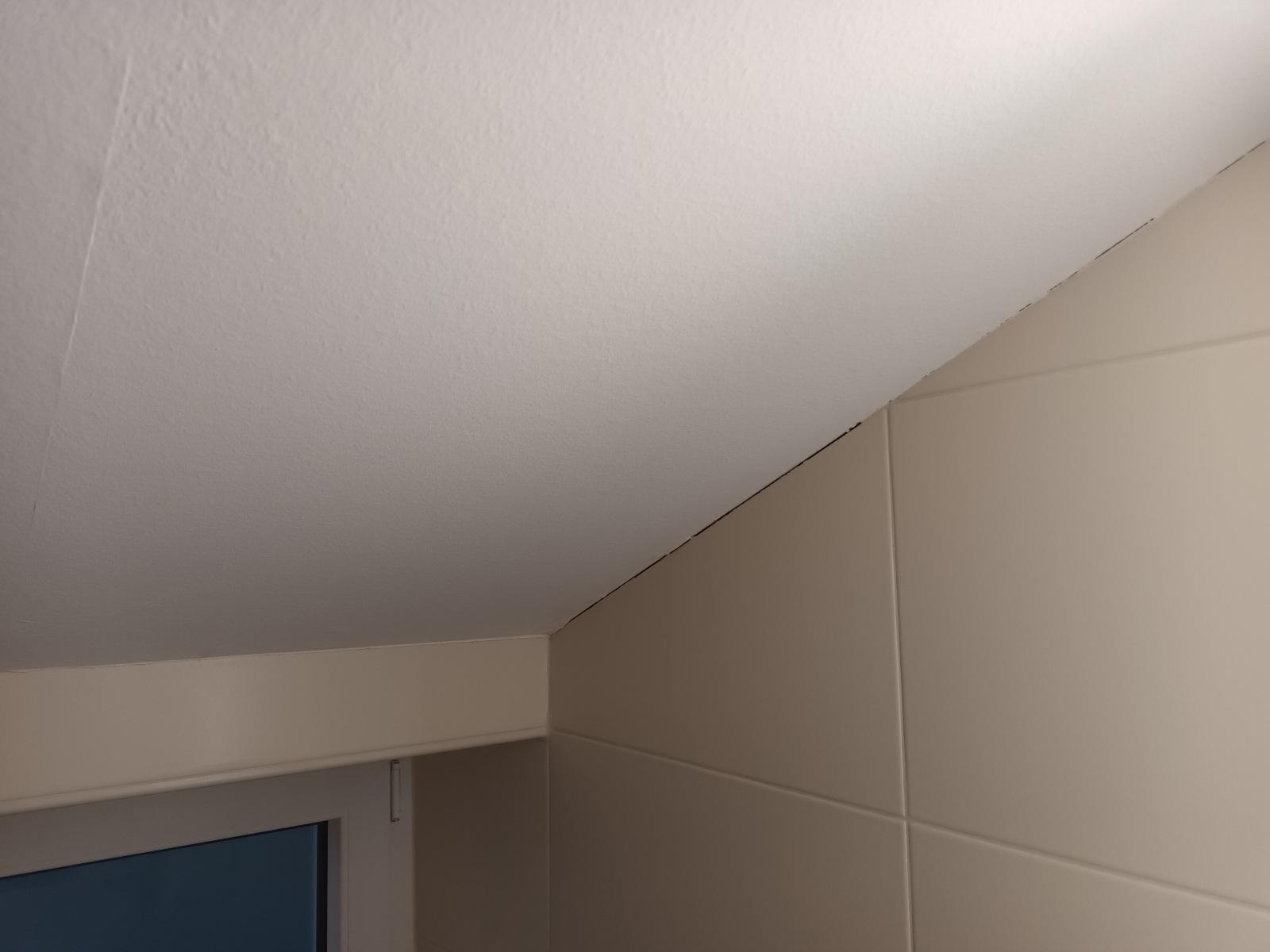

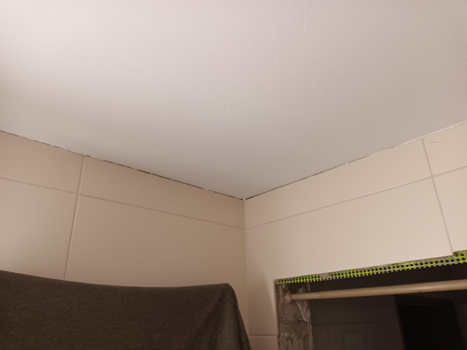

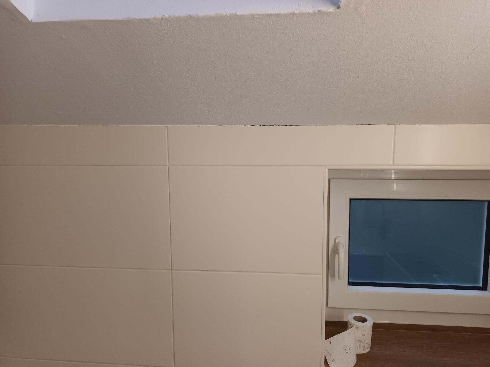

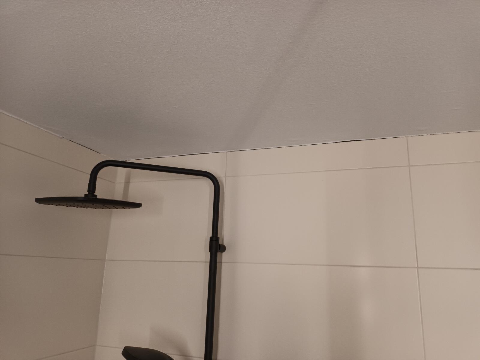

vagrantly3893 Posted August 12, 2023 Posted August 12, 2023 Hello, I am finishing my bathroom however I wallpapered and painted the ceiling before I sealed the gap between ceiling and wall. Should I use decorators caulk for this, or silicone? And if silicon, should it include some mould resistant properties?
Conor Posted August 12, 2023 Posted August 12, 2023 Sanitary silicone. Ideally colour matched to your grout. 1
vagrantly3893 Posted August 12, 2023 Author Posted August 12, 2023 4 hours ago, Conor said: Sanitary silicone. Ideally colour matched to your grout. Thanks. Elsewhere I have been suggested decorators caulk, which can be painted afterwards.
Conor Posted August 12, 2023 Posted August 12, 2023 54 minutes ago, vagrantly3893 said: Thanks. Elsewhere I have been suggested decorators caulk, which can be painted afterwards. With the colour matched silicone, you don't need to paint. Painting sucks. 1
