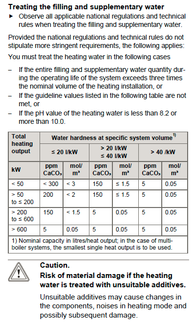

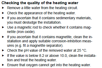

Some mfrs have warnings (no idea if anyone pays any attention) about dissolved oxygen, pH and hardness e.g. Vaillant Arotherm Plus - but the following appears actulally to have been cut-and-pasted from a boiler manual. pH 8.2 is quite alkaline, mains drinking water pH only has to be >6.5:

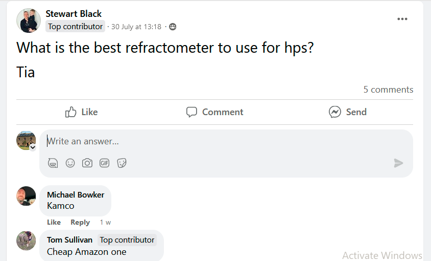

I would also doubt the plumber that comes along to service would have a refractometer. Would like be supposed when someone confirms there was checked.
There seems to be some awareness to judge by recent postings on Heating Design f/b group. Someone else mentions the Fernox but it is well over £100 and looks just the same as the ones on Amazon which others swear by
