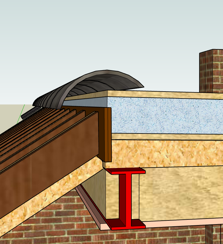

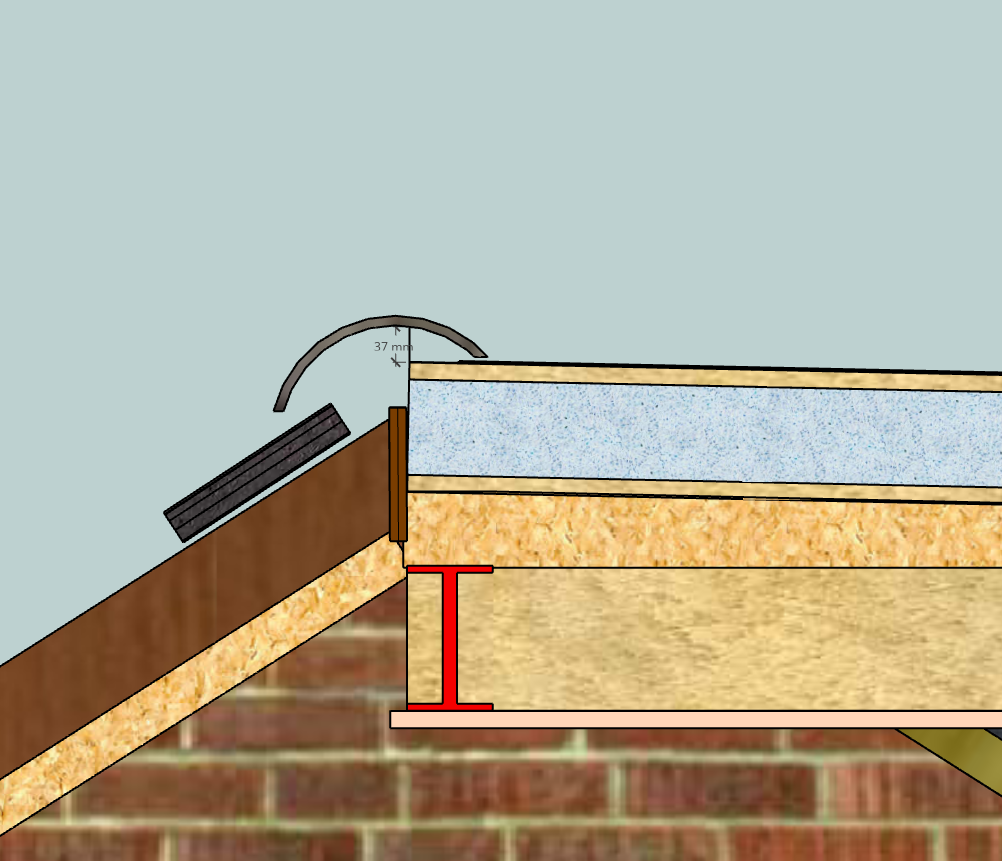

Matt1972 Posted July 15, 2023 Posted July 15, 2023 Hello, I am looking at suggestions to help finish my loft conversation ridge tiles, from cold roof eaves to warm roof dormer. Either a rubber or a fibre glass flat roof, undecided yet. With an EPDM, I could run it over the ridge and seal it to the tiles and use a dry ridge fix for the ridge tiles and install vent tiles in the eaves. Thanks. Matt.
Dave Jones Posted July 16, 2023 Posted July 16, 2023 as long as the eaves and ridge are open to allow air flow will be fine. How did you seal up the warm roof out of interest ?
