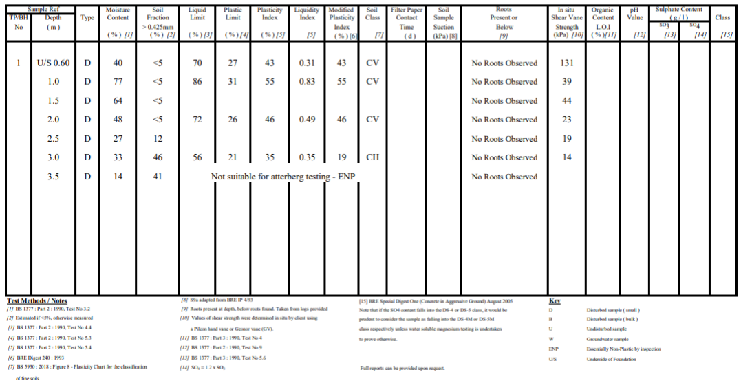

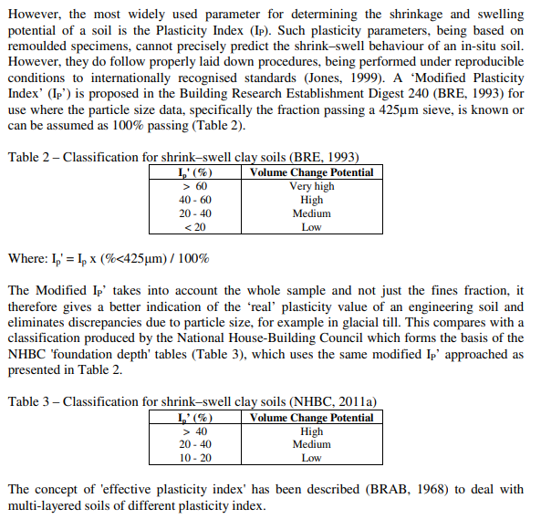

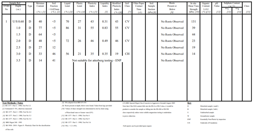

alfaTom Posted July 14, 2023 Share Posted July 14, 2023 3 hours ago, Big Jimbo said: Say that the 1/2 kilo was all clay, but the other material was say sand with gravel. That means that the 7/8 of the material is not taken into account ? I believe that's what the modified result is - a way to scale up to the overall sample size. The 0.425mm filter is used as part of a control method for testing as the results can be reproduced consistently and the modified plasticity index can then be calculated if we know the fraction that passed through the filter vs the total sample. My understanding is that it's this modified index that gives you the overall figure as if the soil had not been disturbed for the purposes of the test. This is the SI report for one of our boreholes. You'll note the Plasticity Index and Modified Plasticity Index remain the same until we get to 3.0m depth where the Soil Fraction >0.425mm changes drastically. At this point the Modified Index reduces. The test method for Plasticity Index was BS 1377 Part 2 1990 Test No 5.4, and the Modified Plasticity Index was BRE Digest 240: 1993. Having a google finds the below theory if it's any use to you (otherwise you'd have to buy a copy of BRE 240) Hope that helps Link to comment Share on other sites More sharing options...
