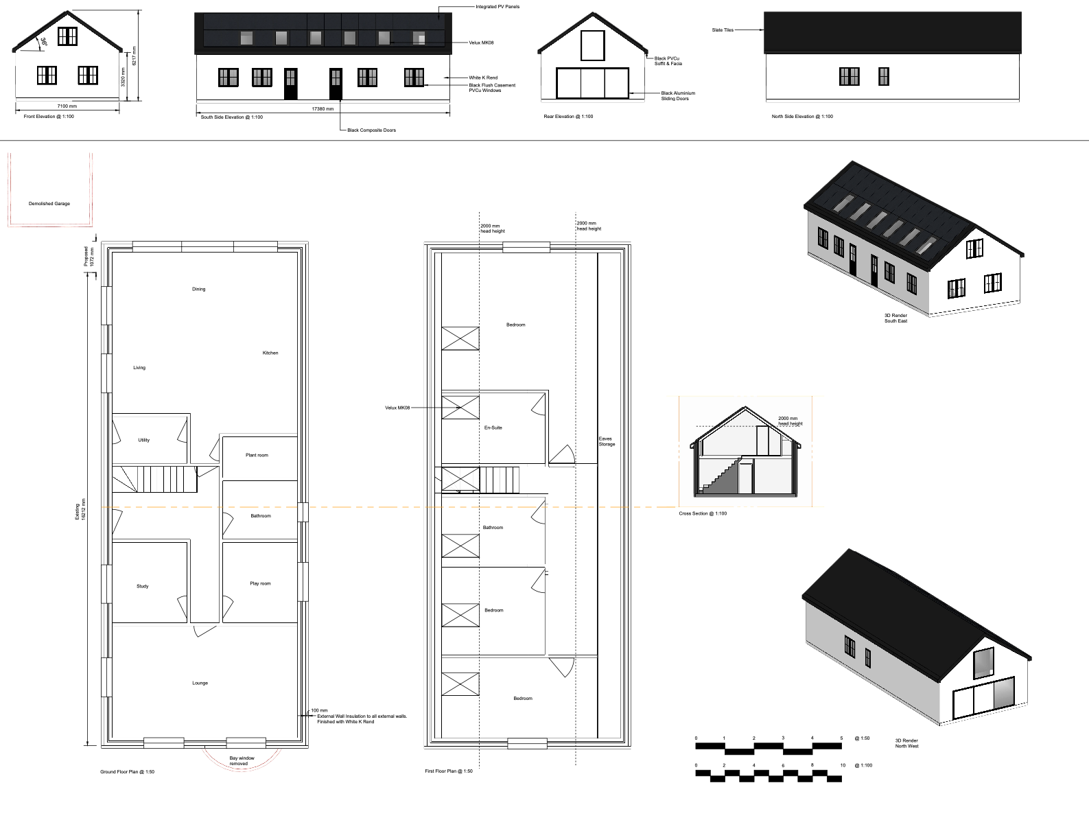

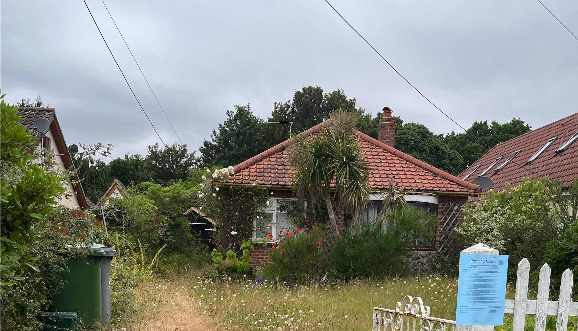

I've been reading quitely for a while now (this forum has incredible knowledge, thank you), waiting to get the keys to my next project. It's a bungalow conversion, raising the roof for bedrooms upstairs.
I want to remove the overhead single phase supply, as it'll get in the way of the new roof work, and planned external wall insulation.
I'd also like for it to enter the building in the plant room, out of the way, convenient.

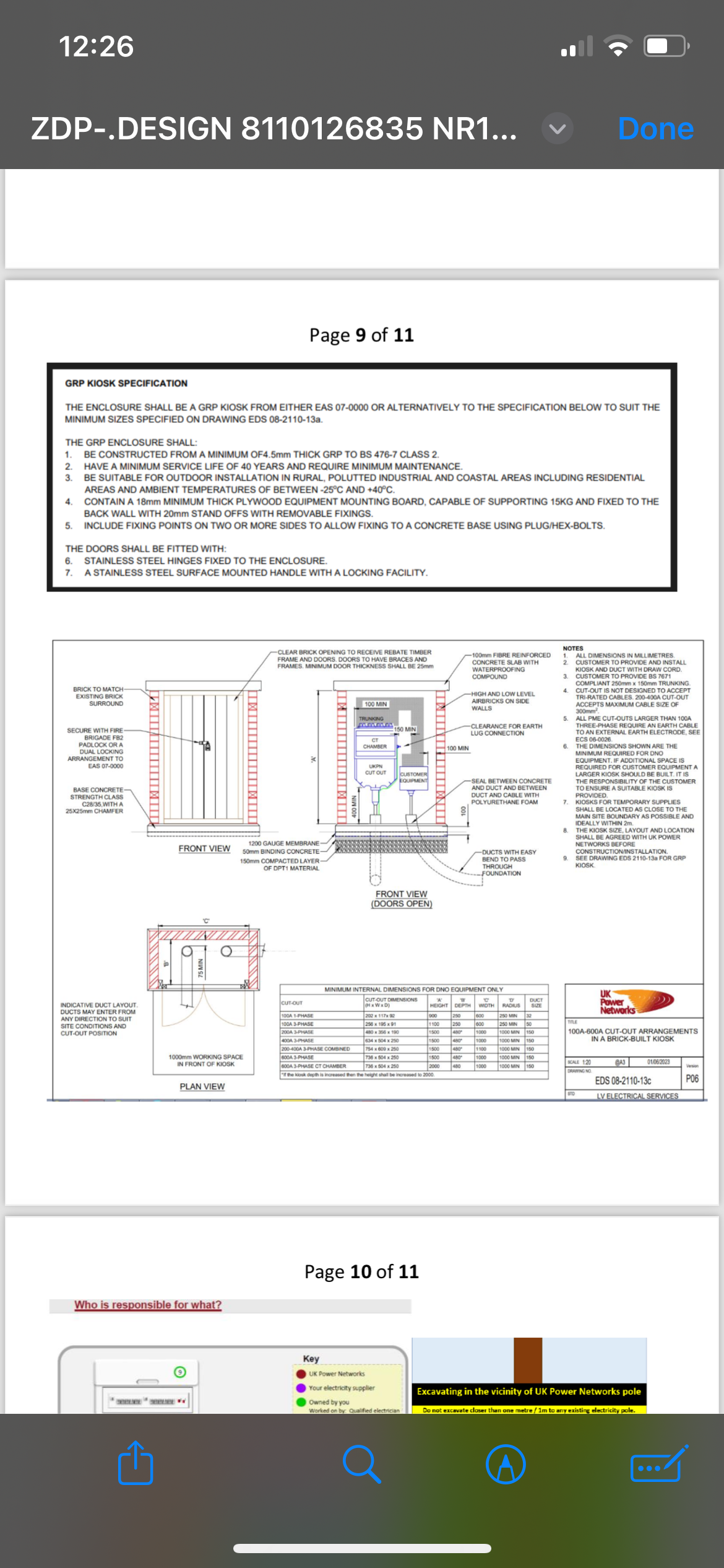

I asked if it was possible to have the supply enter the building underground, this is no longer possible due to policy. So we got talking about kiosks;
4. single phase to a kiosk next to the electricity pole (next to the rubbish bins) - £2100ish
5. 2 x single phase connections to include neighbours, mine in a kiosk, neighbours wall mounted - £2927
6. three phase to a kiosk as per 4. £2527

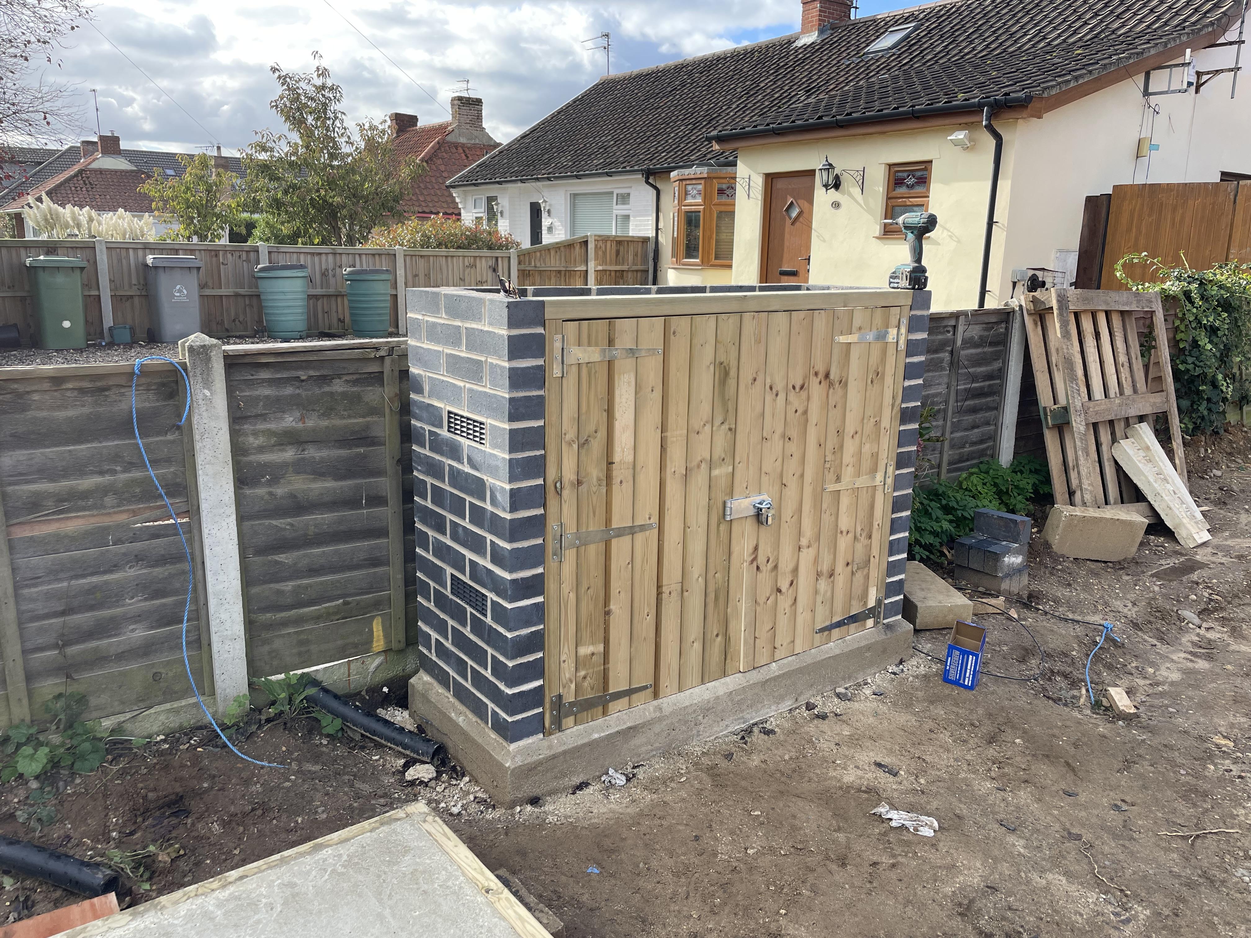

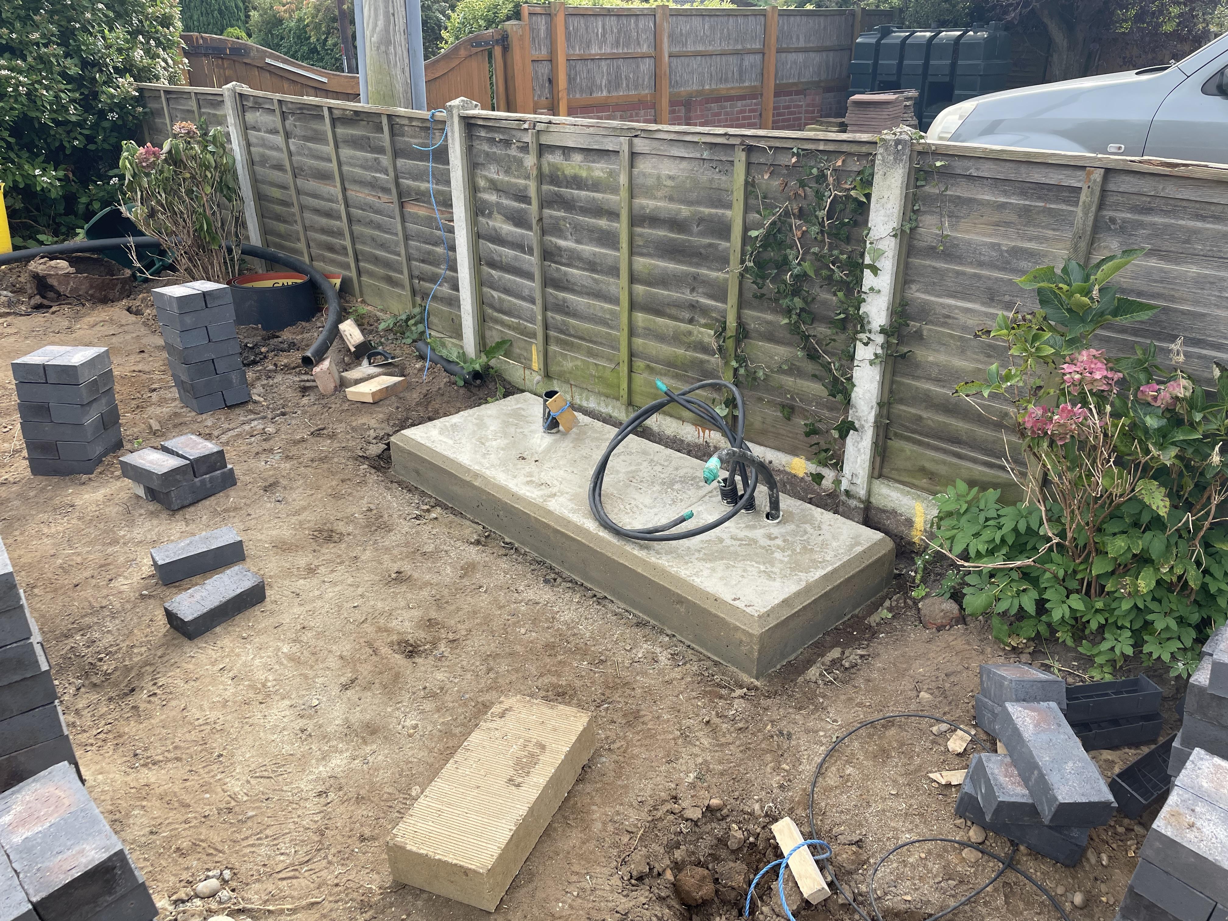

Ended up going with 3 phase to just mine. They ended up wanting a load more for the neighbours.
Heres the kiosk, roof slab is cast just waiting a few more days to cure then will attempt to lift it into position on a bed of mortar.
I also ended up getting g99 approval for 8kw on a single phase, so I’ve got all the options available. Nice chunky 25mm 5 core to the house and 2 x 10mm 5 core for 2 x 22kw car chargers.
