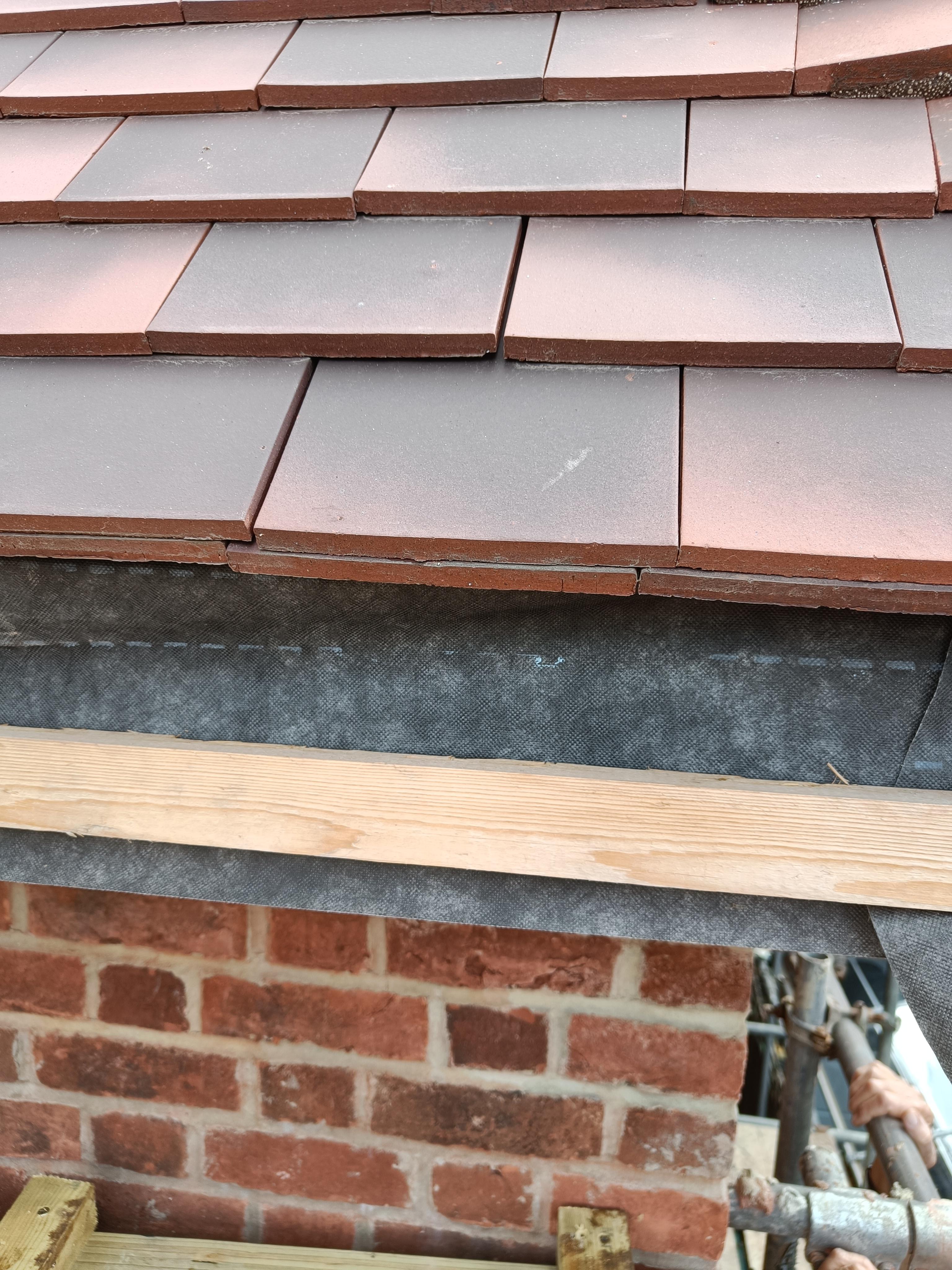

bmj1 Posted June 19, 2023 Posted June 19, 2023 As per the topic, is there any feasible way at all to add an extra row of tiles ?
joe90 Posted June 19, 2023 Posted June 19, 2023 (edited) You will need to remove the last row and under half tiles, extend any rafters somehow then add battens and a row and re install the last tiles and half tiles. Edited June 19, 2023 by joe90
