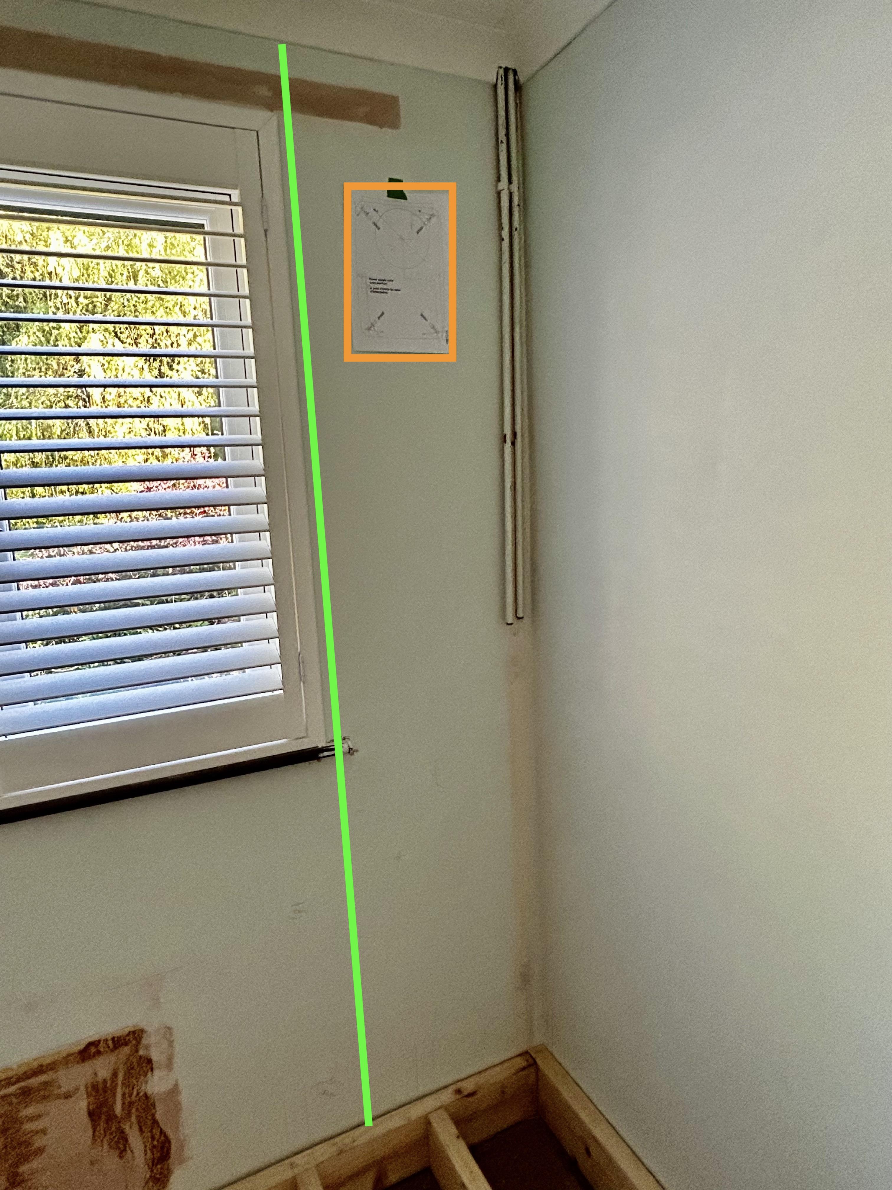

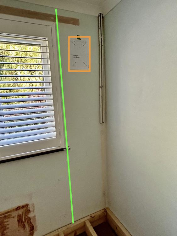

Pictured is the corner of my bathroom conversion - Timber/stud work build room.
Orange - roughly where a 100mm through hole required for a ventilator.
Green - known vertical stud position - screws/nails found with a magnet.
No other obvious nail/fixing lines.
I'm not going up and through the eaves on this room.
The challenge.
I'm betting theres a diagonal stud in there somewhere & ideally would like to miss it when I drill the 100mm hole.
I guess I could hedge my bets - its either floor to ceiling or mid way to ceiling - if I draw both crosses I might miss it?
and/or some pilot holes to check there's void before the big hole?
and/or toss a coin a few times and wait until I'm on a lucky streak?
Question
Are there any better methods?
Cheers
I'd go with a good few pilot holes. Middle, Top,Right, Bottom, and left. You can easily fill them if it don't work out.
As above, either lots of exploratory holes or a neat cut out of the PB
