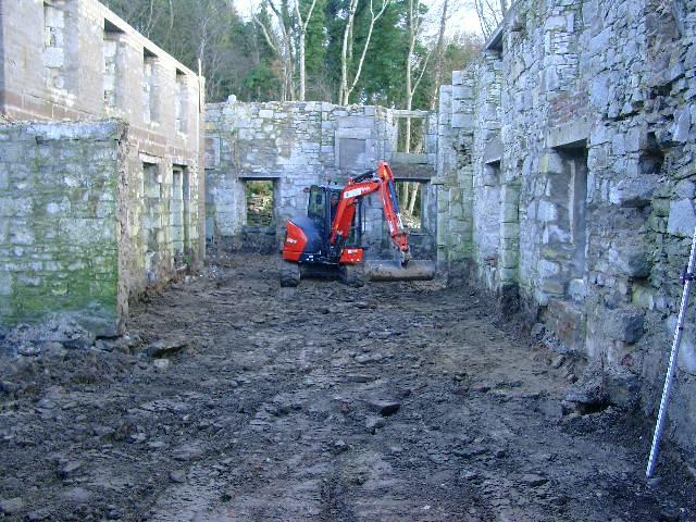

If i could use a 4.5 ton inside my old house -then should not be a problem
and if he is going to riase it up -- leave internal founds and lay another over it  as load will all be taken on new founds around outside of house
 also means you can connect to all services in old found ,.
if its built like most houses a big hammer to knock walls don to inside will soon sort it - and maybe get away with a 2 ton digger to load the dumper
 piccie of my clearing of inside and that had 3ft deep in old walls and plaster etc etc and we dug down to 300 below new floor level
 icould not use old drains as they were nearly non exsistant
