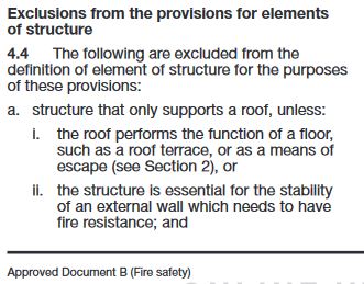

@AliG
Its well worth double checking with your BCO exactly which elements of steel need a fire rating (and why). For example columns and beams that are only supporting a roof do not normally need fire protection.
Edit - extract from Part B of the Building Regs for houses:
Edited by Ian

Thanks @Ian I checked and this does exclude all the steel in the roof.
The house ended up with way more steel than expected. Partly driven by my requirement for concrete upper floors. The lintels for large windows are all steel beams and I also have an overhanging landing that is supported by a large amount of steel.
@Mikey_1980 as you say I did a bit of work on Google and found a paint supplier who will specify the exact amount of paint required for each steel and then provide a certificate. The builder should then be able to get his own painters to do the job and not a specialist. Waiting to discuss this.
