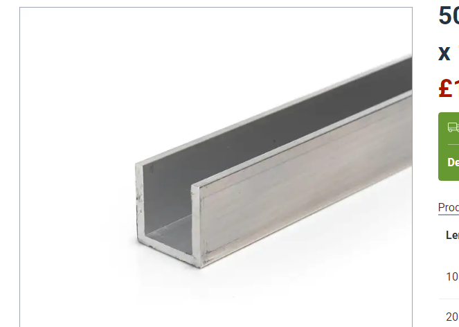

MikeSharp01 Posted May 11, 2023 Posted May 11, 2023 No but you could make one from something like this 25x50 aluminium channel https://www.metals4u.co.uk/materials/aluminium/aluminium-channel/12979-p
PeterW Posted May 11, 2023 Posted May 11, 2023 32 minutes ago, Andehh said: Does anyone know of a sort of 40mm wide and 40mm deep type drainage channel?? 40mm deep won’t stop anything - it will overflow in seconds. Fit something like this around 70-80mm from the edge of the threshold and then tile/pave the gap https://www.cotterillcivils.co.uk/products/a15-paving-slot-channel-with-aluminium-edge-1m
