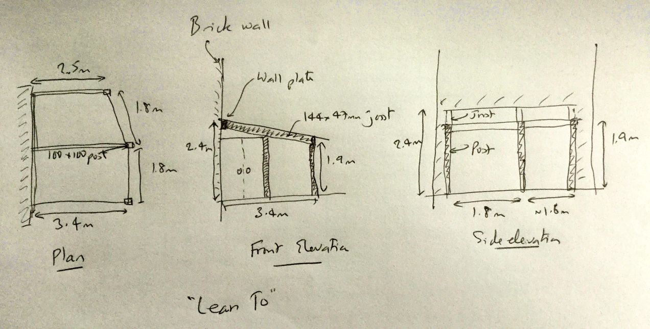

Ferdinand Posted August 6, 2017 Share Posted August 6, 2017 i have posted elsewhere about a leanto I am currently building (think roughly an enclosed carport). I may be using multi-ply polycarbonate sheet for cladding the roof and walls. My question is where does the sweet spot lie in terms of: 1 - Noise transmission eg from rain. 2 - Ability of different thicknesses to span across joists and posts. At present I have joists at 1.8m centres spanning 2.5m-3.5m across the leanto to a wallplate. I can easily add a lighter intermediate structure. 3 - Price for different thicknesses of sheet. I expect that 2-ply (10mm) or 3-ply (16mm) will be the thickness I need, but I would be glad to hear of any experiences. The sketch plan and elevations are below. Thanks Ferdinand Link to comment Share on other sites More sharing options...
Ferdinand Posted August 8, 2017 Author Share Posted August 8, 2017 Having read this technical document, I am going with 900mm joist spacings for the roof, and 900mm spaced horizontals for the walls - and 10mm 2-ply or 16mm 3-ply polycarbonate depending on price difference. With the roof I am hoing with 6x2 joists between the current since they are only about £15 each, so that I can put a real roof on it should the need ever arise. Ferdinand Link to comment Share on other sites More sharing options...
