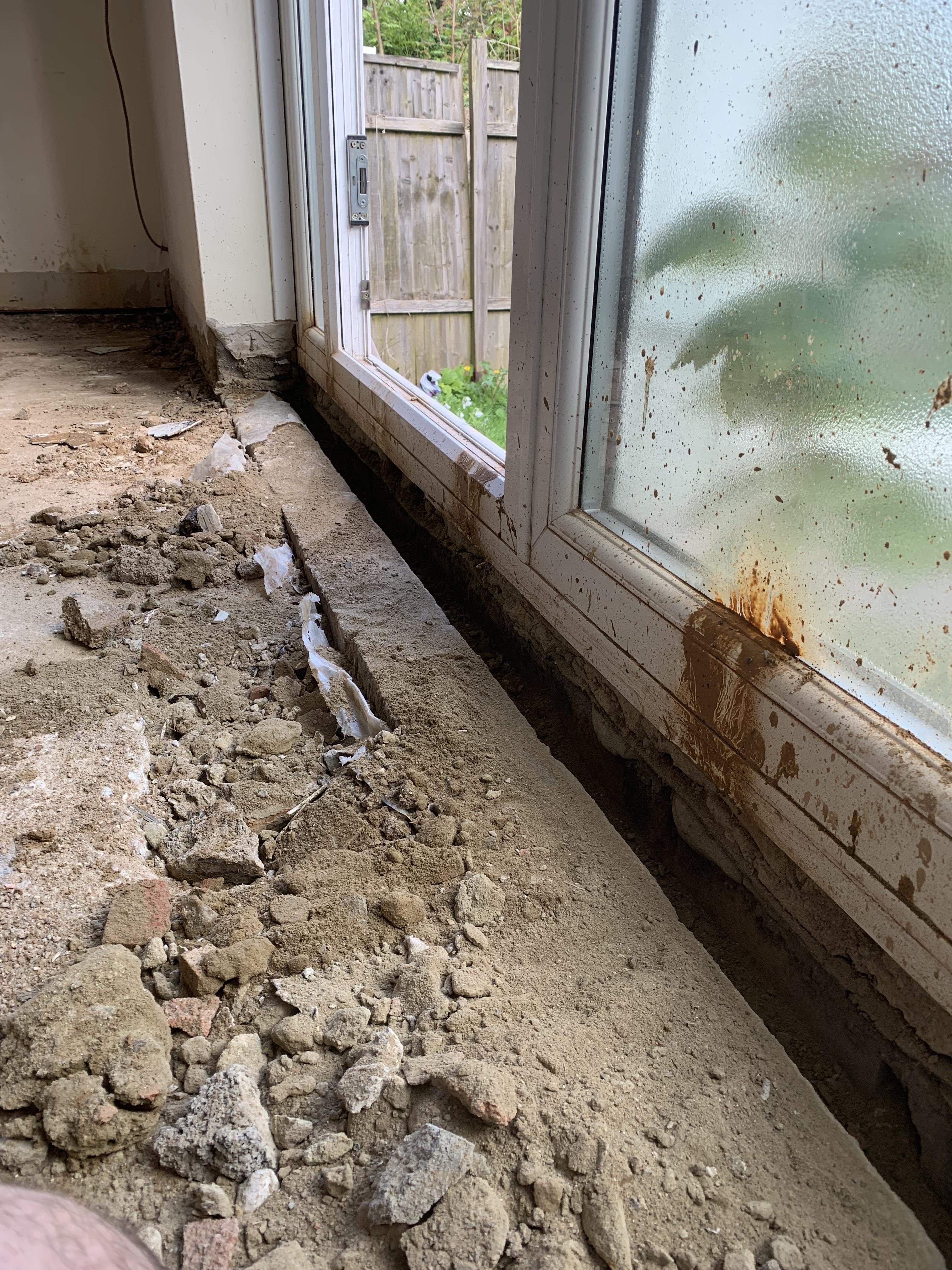

Janespf1 Posted April 25, 2023 Share Posted April 25, 2023 Hi all, How can I fill my cavity between my brick skins? Would be doing a L shape with DPM and filling with screed be suitable? DPM running up the back of the patio door side. tha ks Link to comment Share on other sites More sharing options...
nod Posted April 26, 2023 Share Posted April 26, 2023 Make a U shape with The DPC Stand some rigid insulation in 50 mil short of the floor Fill with mortar Link to comment Share on other sites More sharing options...
Dave Jones Posted April 26, 2023 Share Posted April 26, 2023 depending on if you want to bother about cold bridging, a better way is to insulate then conc over 1 Link to comment Share on other sites More sharing options...
