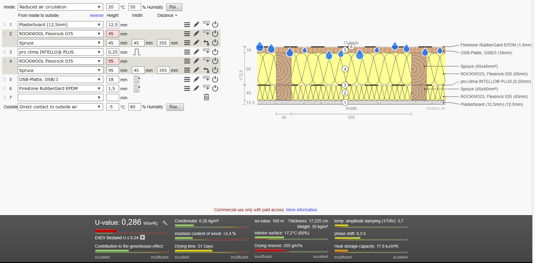

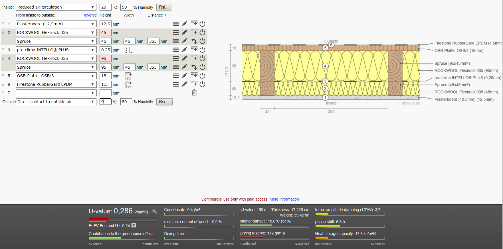

Here is a suggested build up.
Worst case as it's the roof with the impermeable EDPM outboard. There is some condensation but note the outside temperature of -5. I suspect you are getting some in frosty weather as is.
As soon the outside temperature picks up to something reasonable any condensation dries again.
This model will show that if you put an impermeable layer inside the studs there will be no condensation, BUT it assumes there's no moisture trapped there during construction, no pinholes in the EPDM , no tiny faults in the taping of the membrane etc etc.
You appear to have first fixes the electricity wires, I would pull them out and put them inside the membrane in the 50mm service cavity. If you run the 45*45mm battens horizontally too you will eliminate almost all repeat thermal bridging.

150mm Studs @600mm cc with rockwool. Membrane, 45*45mm battens @ 400mm cc .
Lessons learned. Insulate the roof before the walls, and maybe put the service cavity battens at 600mm cc for 15mm plasterboard.
