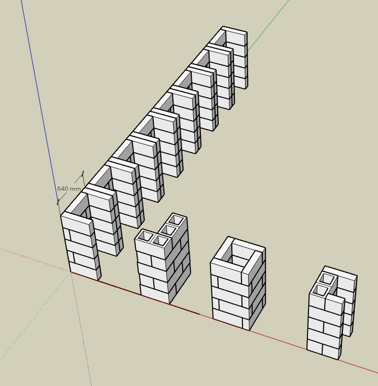

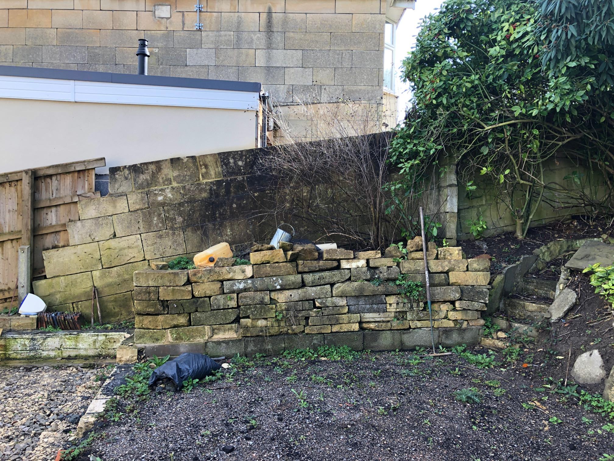

wertert Posted April 19, 2023 Share Posted April 19, 2023 (edited) Hi All  I'm continuing the thread I started in the 'introduce yourself' section. I may have got carried away on the intro 😉  We plan to build a new garage but before we can really start we need to take care of a few retaining structures around the edges of the site. One of them is to address this lovely retainer/planter which essentially retains the higher ground level on the other side of the stone wall.  it's about 1.2m out from the stone boundary wall and full of soil. Take it all down in one go and I think we would see the wall collapse and landslip from next door. As I mentioned in the linked post I am considering some kind of retaining structure built in sections or sheet piling.  1) Retaining structure. We would take down the planter in ~650mm sections and build a foundation and retaining wall in sections, back fill before moving on to the next section. Each section would be mechanically linked to the next. The new sections could be made of standard concrete blocks and/or hollow blocks with reinforcement+concrete filled. Something like..   I'm favoring 4th design which would contain 2 or 3 rebar H12 starter rods. Buttresses adds further support and makes it easier to build/link together. Madness / Overkill ?  2) Sheet Piling 2 options I as can think of  Drive piles into the ground just in front of the retainer. Dig out in front of the piles to install the foundation knowing the planter will not collapse. Once the foundation is in remove piles when safe to do so. Drive piles into the ground INSIDE the planter, so approx 1.1m above floor level and remove the planter stonework completely. Leave the piles in place permanently to provide support.  I'd love to head about any other ideas from the forum. Anything would be gratefully received.  Edited April 19, 2023 by wertert added pic of sheet piling Link to comment Share on other sites More sharing options...
saveasteading Posted April 19, 2023 Share Posted April 19, 2023 Nicd drawings. I'd use number 2 with rods, and space the piers at 1.5m or so. You can't tell how much load might come from next door so better safe.  The easy way to do the rods is to do a plain footing, then drill and epoxy into it to suit block positions. One in each pier and another half way. Concrete fill will be a chore but your phasing will reduce this.  Lapped coursings would be better. Otherwise use ties.  Put drain holes, preferably pipes into the face, at the first horizontal joint.  Hollow blocks are really rough, so either drape plants over or render, of both.    Link to comment Share on other sites More sharing options...

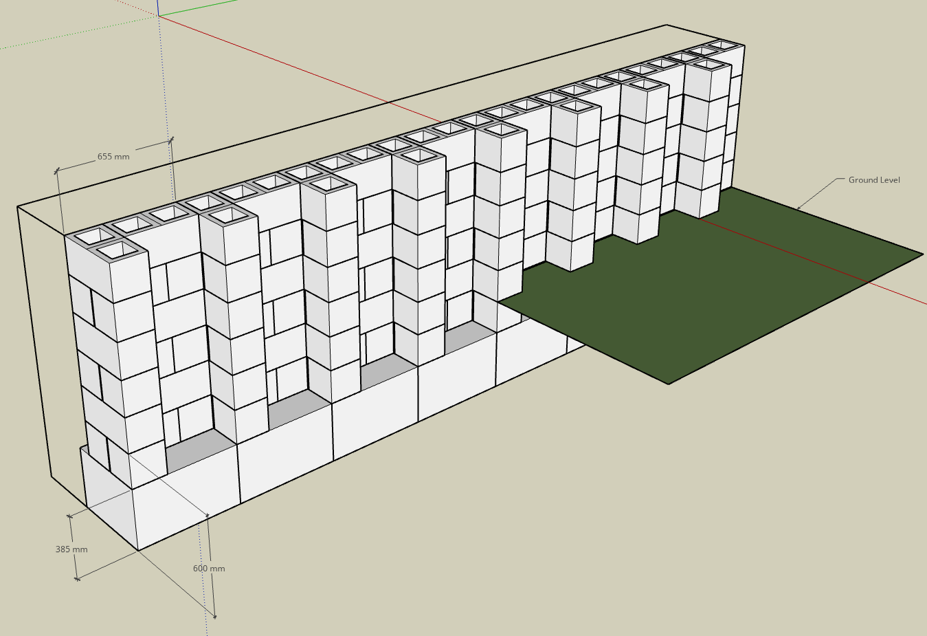

wertert Posted April 19, 2023 Author Share Posted April 19, 2023 Hi Saveasteading Thanks for getting back to me - drawings are done in sketchup which is great for this type of thing. Web based and free version. Did you mean piers on the outside ? or inside ? How about outside ? ie acting as buttresses  So I could phase in 655mm sections. ie Remove 655mm of retainer Build foundation block approx 385mm depth ( 0.14 m3 ) Install bars ( epoxy ) lay blocks for section adding wall ties for next section in joints. First joint add drainhole Fill with concrete Repeat.  I've got more piers than you recommended just to make each section identical. Assuming this would make the wall stronger ? Bit more work.  We need 600mm below ground to line up with the raft foundation. I don't want to undermine this wall when we digout later for that.  Link to comment Share on other sites More sharing options...

saveasteading Posted April 19, 2023 Share Posted April 19, 2023 It will work either way round, but inside is tidier and may need less digging. You could leave the top block of the buttresses off, to allow a full bed of soil and plants. Not much load is happening there.  655 is awfully close. Doubling that isn't going to be a risk.  When backfilling put gravel against the wall to aid drainage. A bit of plywood held 50mm off the wall, pour 300 deep gravel, backfill with soil to the same depth. repeat. Pull out the ply for reuse.  Link to comment Share on other sites More sharing options...
wertert Posted April 21, 2023 Author Share Posted April 21, 2023 Hi Saveasteading. I take your point on the 655mm. Will be tight. Tell you what, i'll add another block to meet you in the middle so 1095mm sections. I will have to build approx 5 sections to complete the wall   I flipped the piers to the to the other side. I wanted to ask you about the rebar placement. I think you mentioned one bar in the pier and one halfway ? Does the above look about right ? Is adding another one better or overkill ?  The design for the other retaining wall i'm building uses stepoc blocks and a much wider foundation ( unsuitable for this wall ). Should I consider using mesh and starter bars as below instead of epoxy fixing in the rebar for the wall above. Again, am I going into overkill mode ?     Link to comment Share on other sites More sharing options...
saveasteading Posted April 21, 2023 Share Posted April 21, 2023 The red bar is structurally elegant but a pain to work with. They have to be exactly placed. I would stick with epoxy and inserted bars. The pullout strength is huge. I can tell from the drawings that uou will be precise. Mesh in the base is appropriate as the vertical bars will be trying to bend the base. One layer middle if being mean. Â Still add 25mm drain pipes out of the wall above ground level in case your other drain fails. NB your land drain is going through the piers. Make it smaller, or settle for the front pipes. Link to comment Share on other sites More sharing options...
