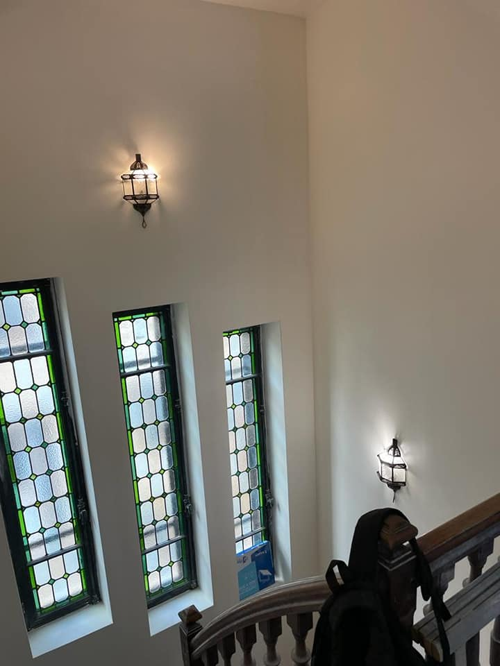

I've got things underway in the entrance and the first floor - I'm using a combination of IKEA Nymane and unobtrusively Moroccan lamps (like the ones in the picture), and I'm also indulging in two Tiffany lamps for the library.

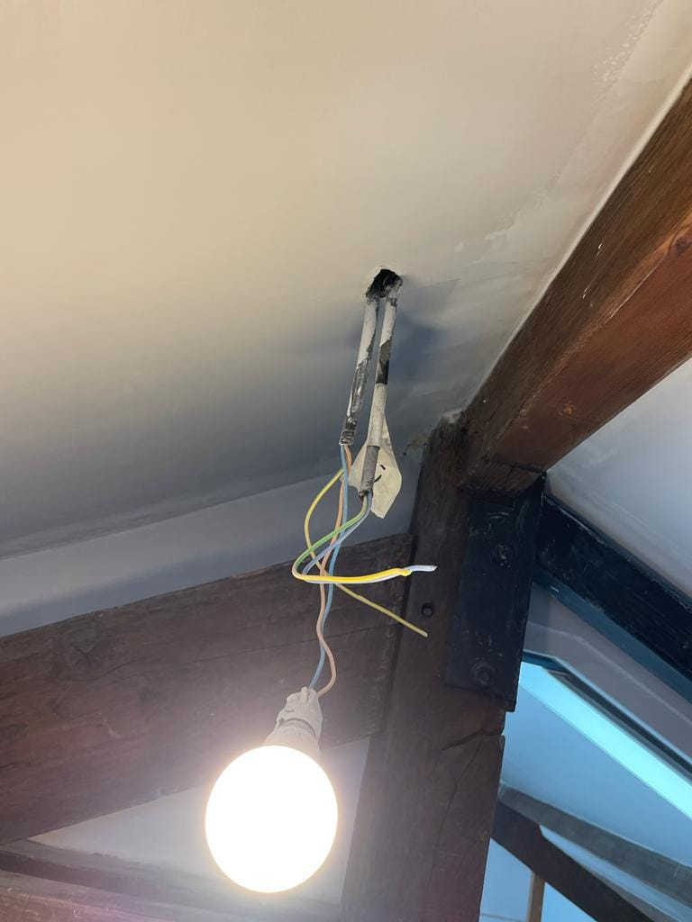

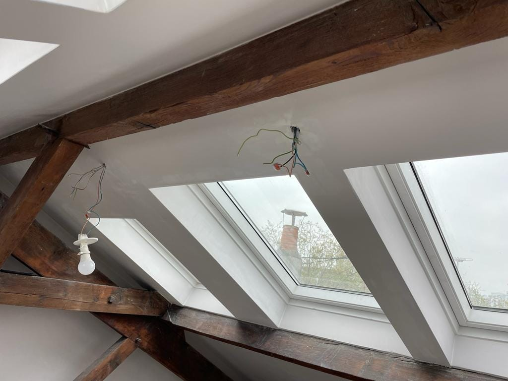

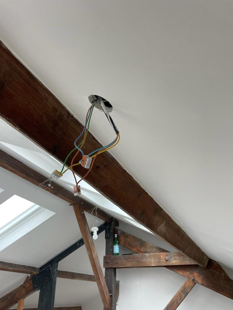

Here are the places for the two ceiling lamps. What does one even put there? I think the highest point is barely 2m20, if that.

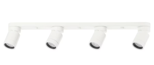

I suppose the one on the right could be something like this:image.png.2f71efafb7eb5d4aa2da76ded0900863.png(somewhat appropriately, since this part of the attic will be a home office) - but what would I ever put on the one on the left? Or here:
A few ideas to start with:
1 - You don't have to put anything there. You could just blank them off for possible future use and stick to other light sources - floor & desk lights, for example.
2 - You could loop a flex from them to a light suspended in a more convenient location nearby. As you've chosen Moroccan elsewhere, perhaps something like this one, to shed some interesting patterns Fretwork Moroccan styled pendant?
3 - For the home office (if it's only a home office), then you could indeed choose functional spotlights, either tracked or individual.
