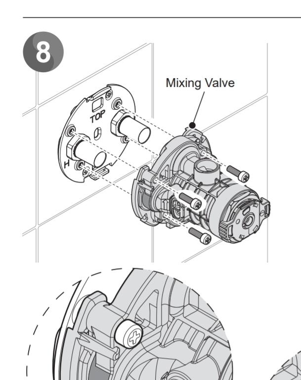

It can be serviced without going near the tiles too.
Screenshot_2023-04-10-17-57-32-027-edit_com.google.android_apps_docs.thumb.jpg.a6a5400479e81571518582563de7d014.jpg
