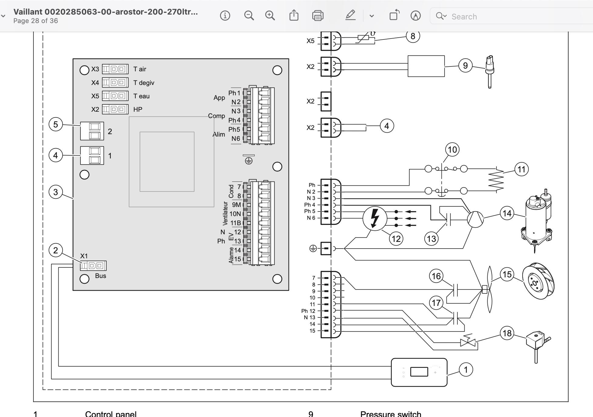

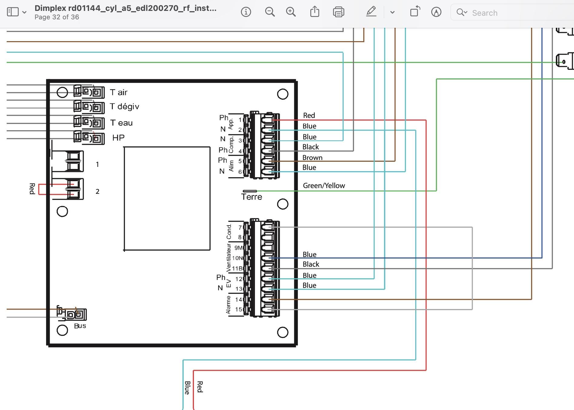

RichardL Posted April 9, 2023 Posted April 9, 2023 (edited) FWIW If you look at the manuals - dimplex edel and vaillant arostor have suspiciously identical compressor/circuit board layouts, would be interesting to know if there's much more than marketing between them - looks like a shared technical design at some point - or off the shelf product? Edited April 9, 2023 by RichardL 1
Gill Posted April 9, 2023 Author Posted April 9, 2023 (edited) 23 minutes ago, RichardL said: FWIW If you look at the manuals - dimplex edel and vaillant arostor have suspiciously identical compressor/circuit board layouts Good to know. I'm sure when I was looking previously at the edel, it brought up a list of 'additional product of interest' including required exhaust kit and (optional) wifi hubs. I am a big hater of hubs. Why do I need to route simple api calls through a propriety hub! I have to assume its not required for every day operating. I don't think that's an edel specific issue. Valliant probably the same. More to the point... There's more to the cost than just the unit as is probably true with the UVC. 23 minutes ago, gregh said: That is my biggest concern with EASHP - in theory the install shouldn’t be much different, aside from a couple of extra holes for the air supply/exhaust. However I can imagine your average plumber not wanting to take the risk on something new like this, and the handful who have experience with these charging a premium… might still explore it When I spoke to my plumber last year he had zero heat pump experience and his son was just starting to look into it but they had zero demand. Not one single customer. Spoke to a few others who echo this. Those with the experience are hard to find or are operating under 'Green /renewable solutions' type companies which in my limited experience adds a hefty premium to the work. 36 minutes ago, Gill said: The other aspect I don't fully understand on the excess solar is if that hooks to an immersion (so 1:1) or if that can flip the heat pump power input automatically giving your solar input an increased COP. I may have answered my own question. Should take my own advise sometimes and RTM. 'This function enables the appliance to operate in auto-production mode, which means that it will use the energy produced by the PV function to supply the heat pump as well as the electrical back-up, in order to heat the water in the tank.' So potentially increased COP from solar but reduced storage if max temp can only be 65. I should probably size up roof space suitable for solar and work out what I could be storing on a day where we have little sunlight demand. Edited April 9, 2023 by Gill
RichardL Posted April 9, 2023 Posted April 9, 2023 (edited) My reading of the manual is there are 2x dry contacts on both V & D machines, which are the PV input - but presumably also the simplest way to override the onboard timer with a 'heat now on immersion' command without hubs/cloud etc. Both manuals seem to talk about 2x levels of PV input but not much/any more detail I could see. One of the dry contacts on that board is shorted by default - might indicate that could be a simple external control/timer input? (or might not - I'm really guessing - no direct experience) Update - theory? - one of the contacts is immersion and the other is the compressor/A2W via the onboard timer - hence why its normally shorted? I really don't want my heating or DHW connected to wifi - worked far to long in IT to think its a good idea to add layers of complexity on a basic switch. Edited April 9, 2023 by RichardL 1

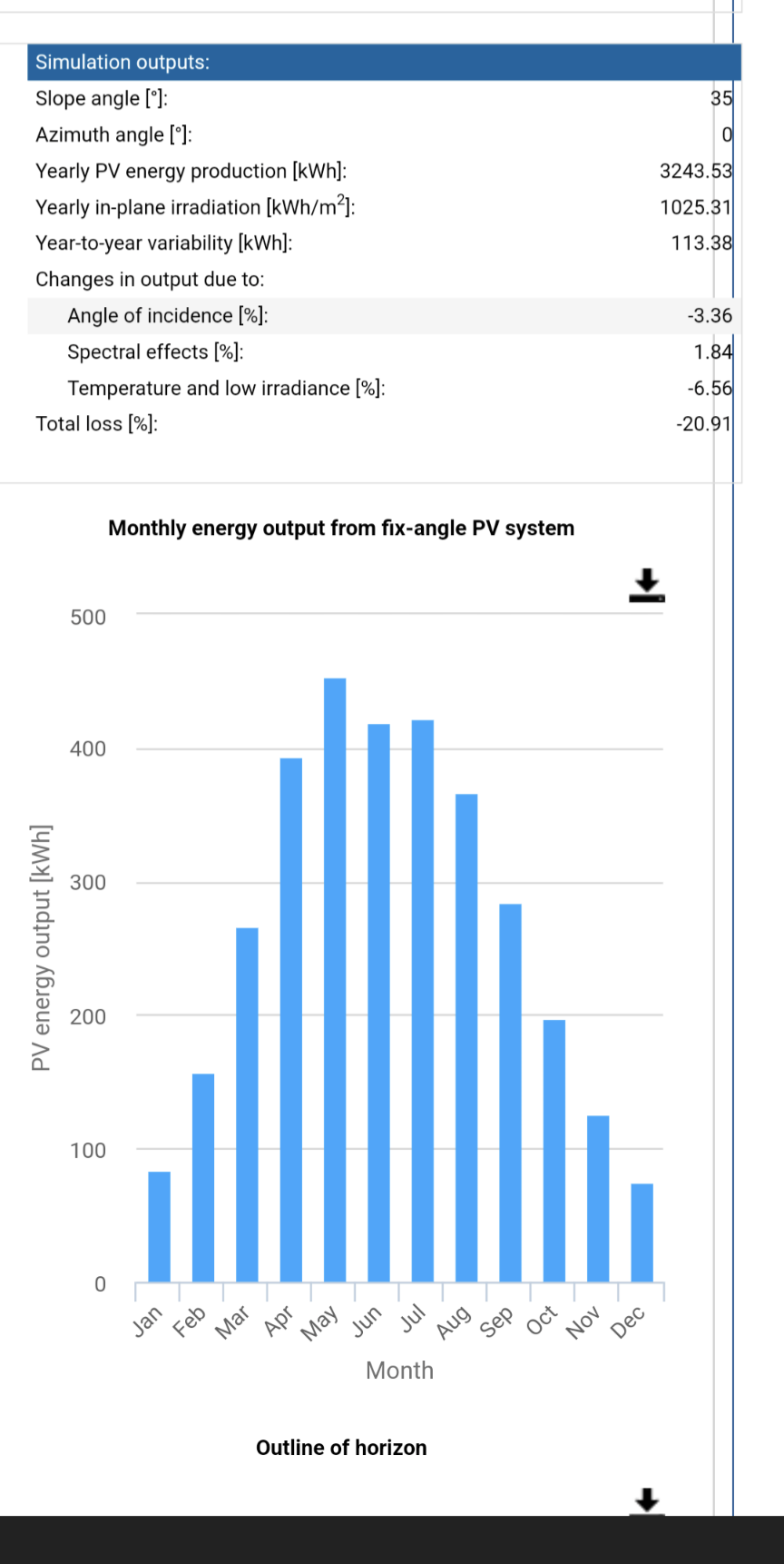

Gill Posted April 9, 2023 Author Posted April 9, 2023 A very basic solar gen calculation from energy saving trust based on postcode. South facing unstructured roof. I estimate 5mx 4m could site panels. This is by no means using any smart sizing based on my energy requirements. It does indicate I've potential to bank a fair amount of excess as hot water (over the sunny months). Now I need to work out how this folds into the maths 🤔 Size of the system 4 kWp Energy generated by the panels 3,213 kWh / year
Gill Posted April 9, 2023 Author Posted April 9, 2023 27 minutes ago, RichardL said: Nothing against full automation - just not for me in my house. My washing machine is wifi enabled (not a factor in my purchase). Has never worked. Full manual control was a requirement otherwise I would have a very large paperweight in my kitchen. I would never want to rely on WiFi (and certainly not cloud! ) for critical home functions.
Iceverge Posted April 9, 2023 Posted April 9, 2023 2 hours ago, Gill said: A very basic solar gen calculation from energy saving trust based on postcode. South facing unstructured roof. I estimate 5mx 4m could site panels. This is by no means using any smart sizing based on my energy requirements. It does indicate I've potential to bank a fair amount of excess as hot water (over the sunny months). Now I need to work out how this folds into the maths 🤔 Size of the system 4 kWp Energy generated by the panels 3,213 kWh / year Try PVGIS for an another useful tool. It will give you more granular data. https://re.jrc.ec.europa.eu/pvg_tools/en/ Just to put the cat amongst the pigeons here's an option from Daikin that may suit you.
Gill Posted April 9, 2023 Author Posted April 9, 2023 (edited) 24 minutes ago, Iceverge said: Try PVGIS for an another useful tool. It will give you more granular data. https://re.jrc.ec.europa.eu/pvg_tools/en/ Will need to play around with that a bit as I'm not familiar with a lot of the solar terminology. Basic defaults for my location with roof pitch giving me this. 24 minutes ago, Iceverge said: Just to put the cat amongst the pigeons here's an option from Daikin that may suit you. Edit - looks like I can discount that due to lack of water capacity. Offered with a choice of domestic hot water storage capacities of either 90 liters or 120 liters Sometimes I think I should just flip a coin. I should probably add a factor of 'hours spent trying to comprehend viability and ROI' to each solution but I don't think I want to see those numbers quantified 😂 Edited April 9, 2023 by Gill
